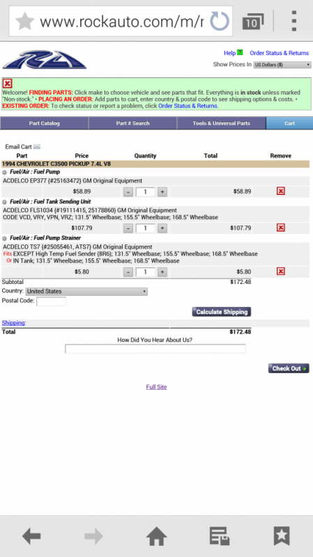

Needs to make at least 8 psi while supplying I believe it's roughly 20 gph. The ep377 is a good upgrade pump. It was used on the 94-95 big blocks that ran at higher pressure.On the fuel pump, what are specs and what is the pump producing for volume and pressure- thats all that counts.
