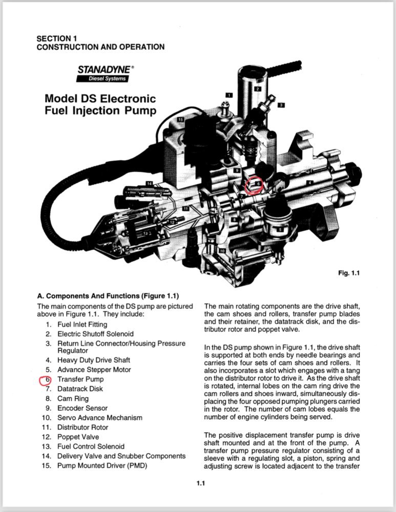

Sounds like a bad IP. disconnecting the Optic sensor when running should immediately kill the engine I would contact the company and see what they can do for you, but let others chime in and verify / discredit my observation.
The motor should die when the OS connector is pulled, even with the CPS connected?
