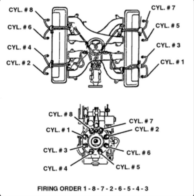

In your bottom picture it looks like the fuel line marked 8 is connected to pump marked 1
That was just a random pic from the innerwebs to show the optic sensor plug and that dreaded filter.

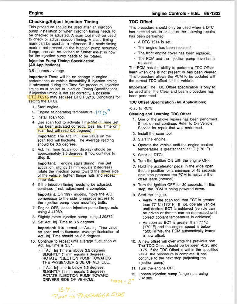

3. Present Codes. Current ones, specifically P1216, all point to the IP’s timing. Unfortunately, letting the engine run in such a condition until 170 degrees is achieved to properly conduct timing reset and then TDCO offsets is not for the feint hearted.
What are the current IP timing value…greater or less than 3.5 degrees?

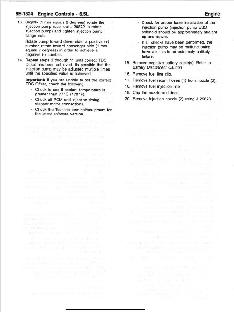

Above 3.5 and the IP needs to be rotated towards the “drinker’s” side [passenger]. Less than 3.5, rotate toward the driver’s side. The IP should be moved / Rotated ‘anatomical hairs’ distance while the engine is off. You can get these initial moves done without warming up the motor. Just don’t do the ‘Time Set’ function until your at 170 degrees.
I did screen shots from a 1997 manual for IP timing in the hope it will be of assistance. Fingers and crescent wrenches crossed in the meantime.
