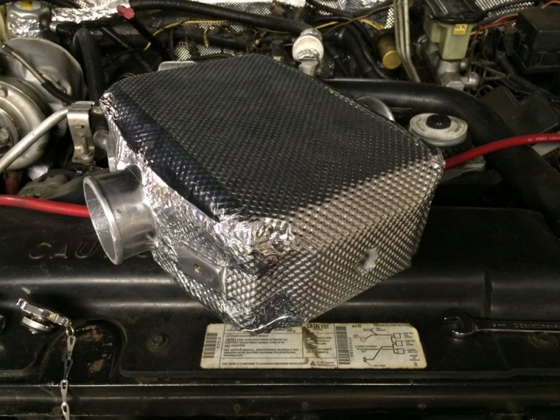

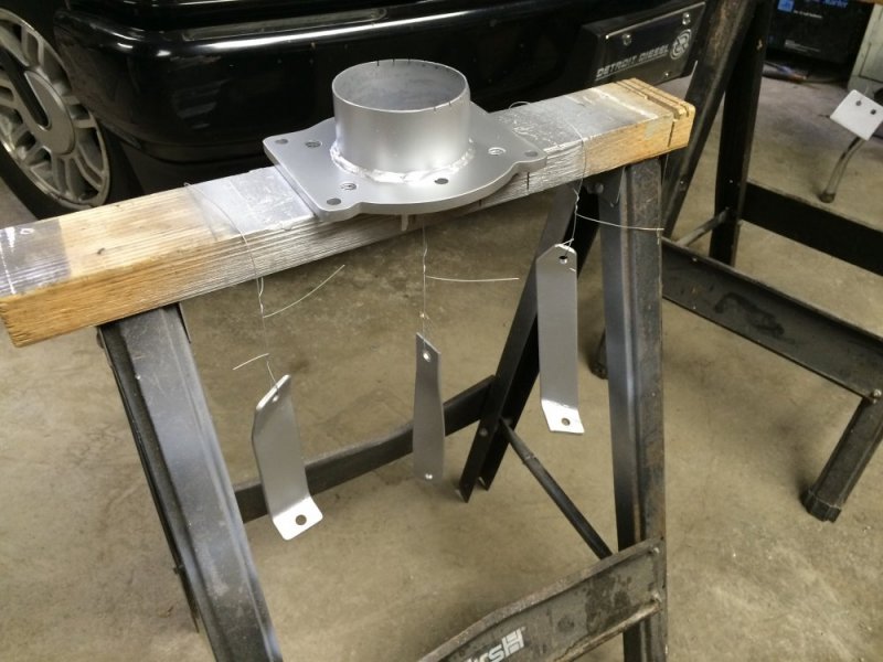

I got the cooler insulated. The brackets and upper intake are painted and drying. Gonna call it a day and get some dinner. image.jpgimage.jpg

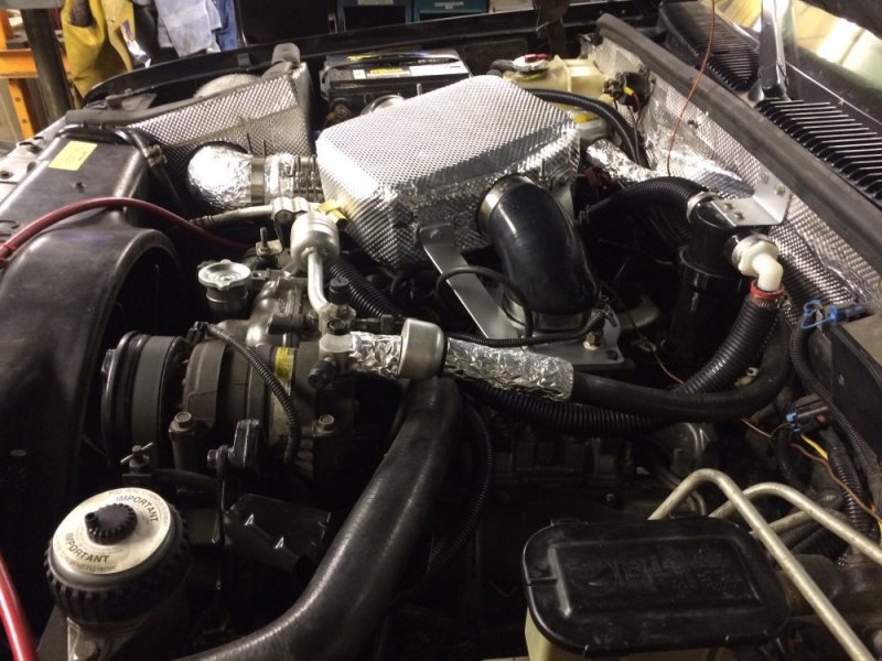

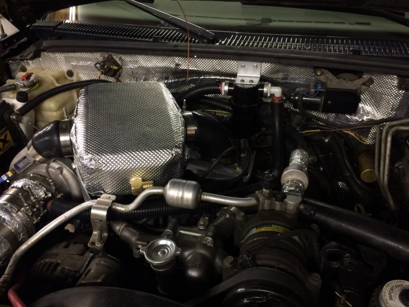

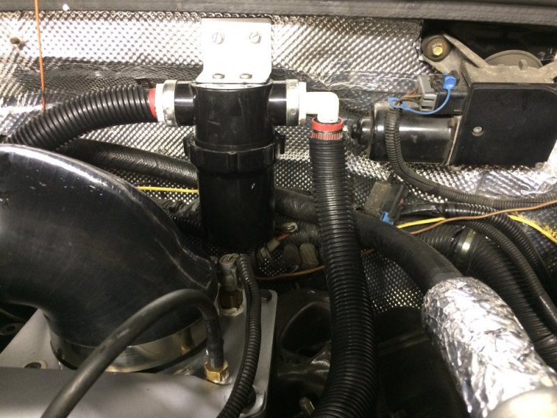

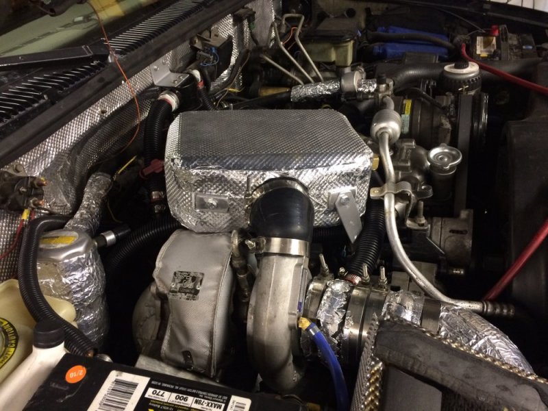

Engine is buttoned back up. I'm glad Matt's oil seperator thread had been brought back because it was the perfect time to install that. The engine bay is a bit more cluttered now but it's functional. I haven't started running the water hoses yet because I'm still waiting to get the Cadillac water pump. I should hopefully have that mid-week and then I can finish this. I'm going to install the radiator now so that is ready to go.image.jpg image.jpgimage.jpgimage.jpg

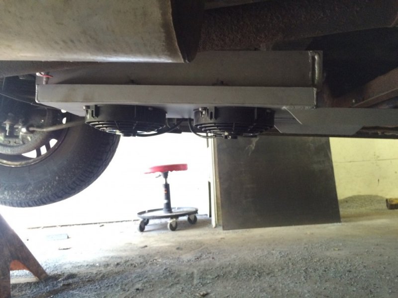

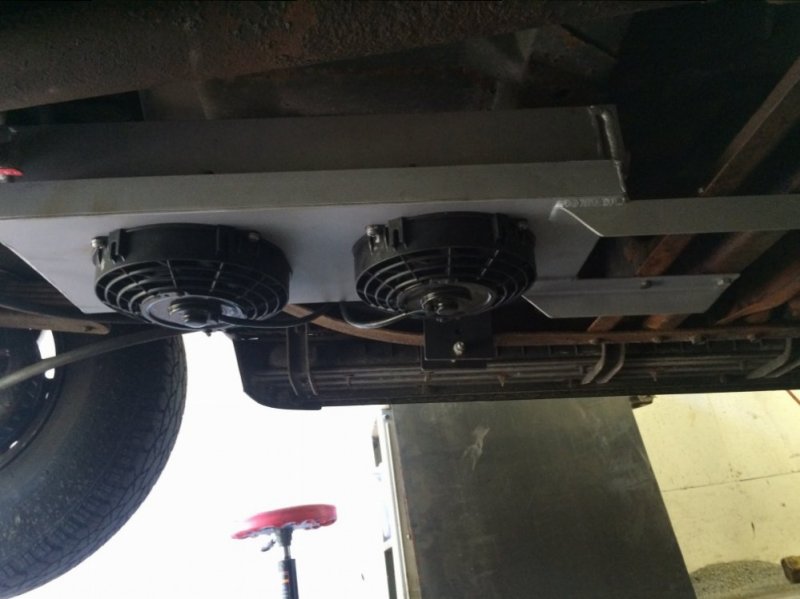

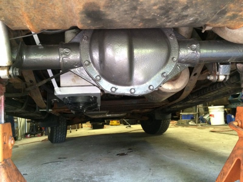

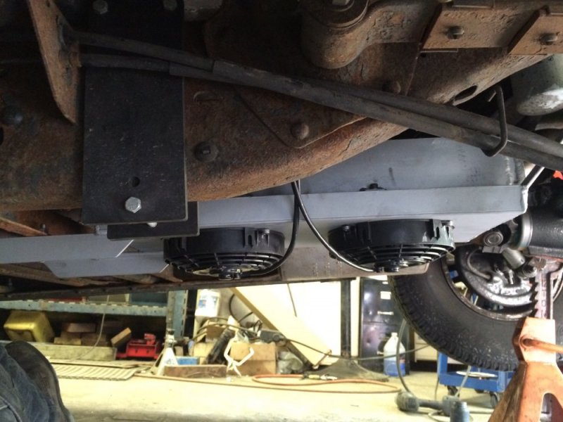

Radiator and fans are mounted. Now I just need that pump and I can finish this thing up. image.jpgimage.jpgimage.jpgimage.jpg

I still have the CDR. I turned it around so it's pointing towards the firewall and it's hooked to the oil catch can with Gates multi-purpose hose.
