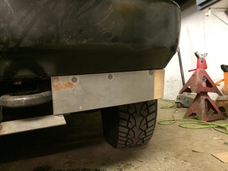

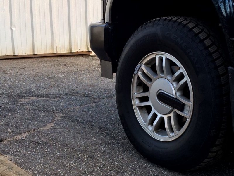

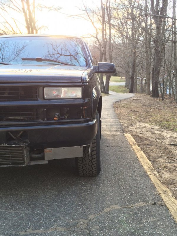

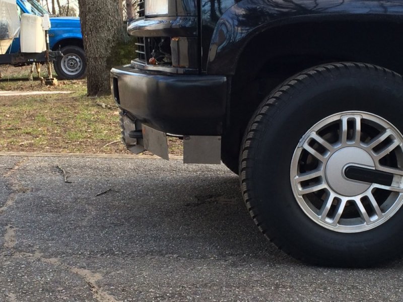

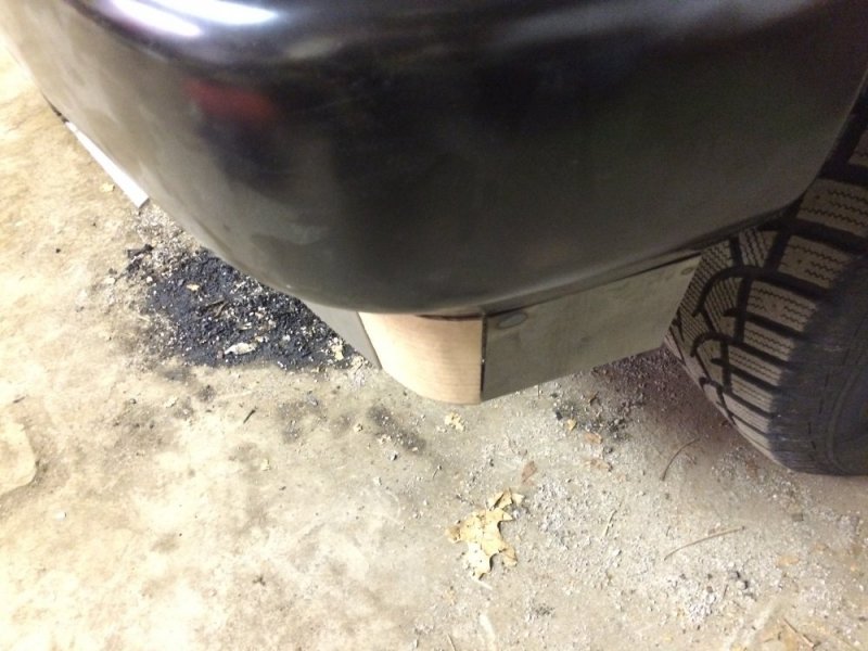

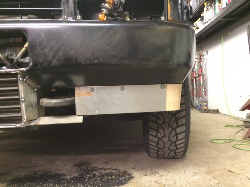

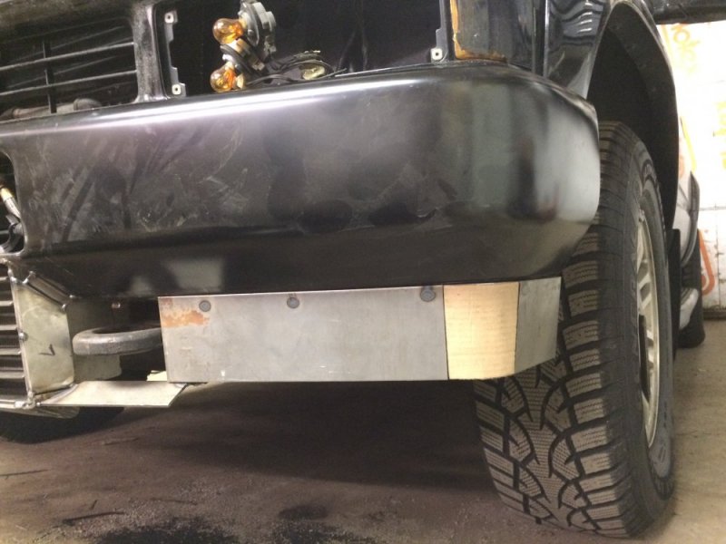

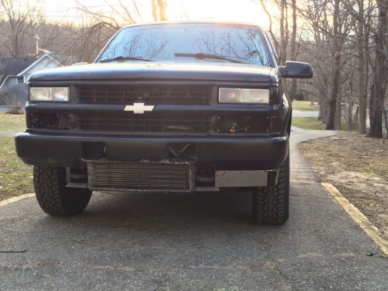

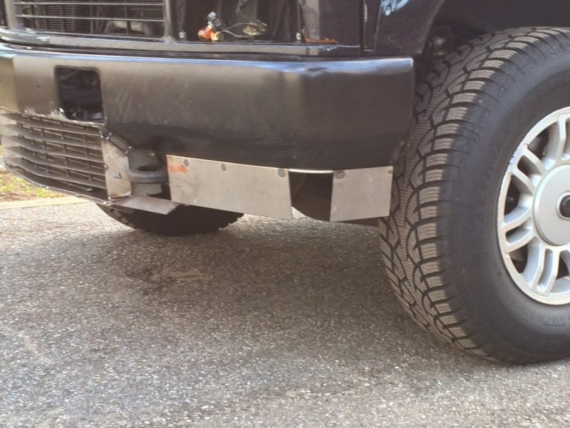

I reinstalled the bumper tonight for test fitment. It looks good I think. It's looking more and more like it's supposed to be there. IMG_7842.JPGIMG_7844.JPGIMG_7846.JPGIMG_7848.JPGIMG_7850.JPGIMG_7852.JPGIMG_7854.JPG

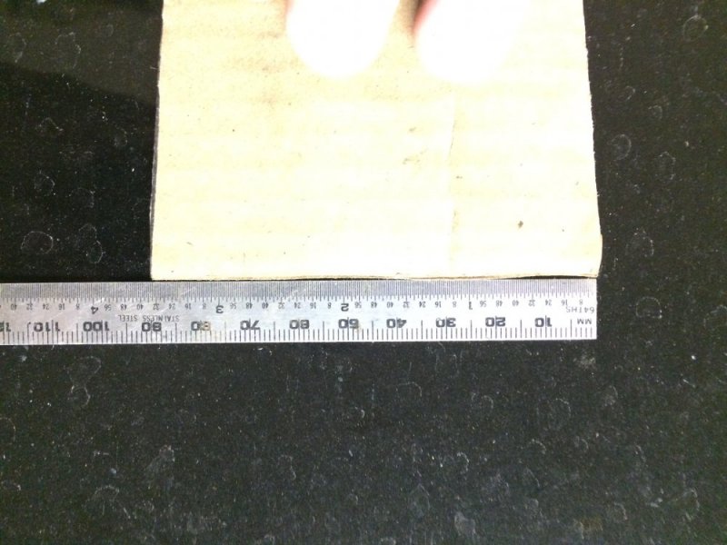

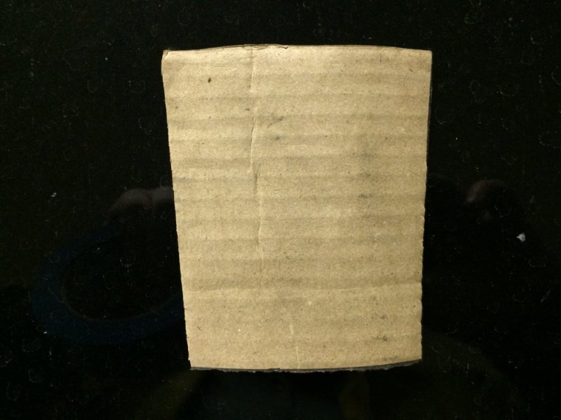

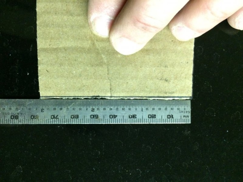

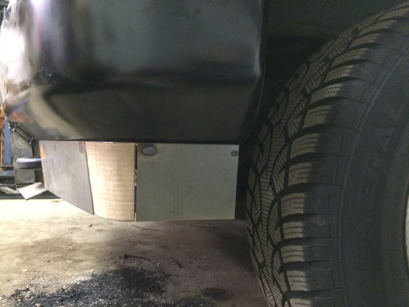

Then I started figuring out what the missing piece will look like. I made a piece out of cardboard. It's almost half an inch longer on the top than it is on the bottom. As long as I can form a nice radius it shouldn't be bad to fit, but that will be the trick for sure.... Tomorrow is when it will turn into metal. IMG_7855.JPGIMG_7856.JPGIMG_7857.JPGIMG_7858.JPGIMG_7859.JPGIMG_7860.JPGIMG_7861.JPGIMG_7862.JPG
A simple job... rubber mallet & thick news paper on a curved object and 5 minutes, start with a larger piece of metal then lap it to the other part and then make your cut.... 10 minutes your done...:wacky:
I hadn't thought of thick newspaper. Nice tip! Thanks!

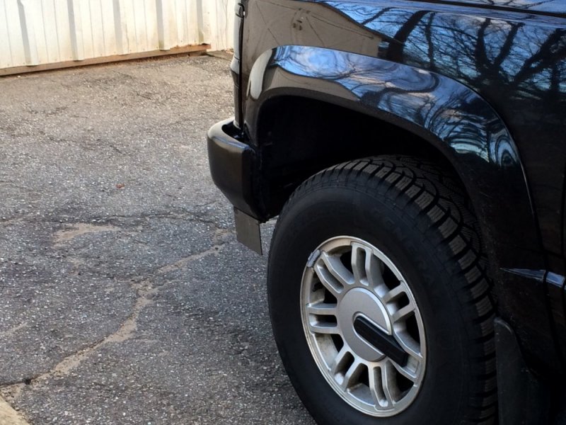

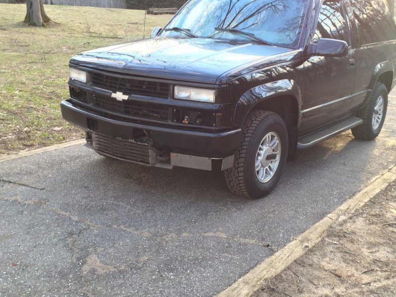

In the one pic where you can see the front and side together it made me think it would look good if it were a shiny silver or chrome. Would tie it all together with the wheels and chrome edge of the running boards.
I see what you're saying. Chrome would be durable too.....but my wallet isn't durable enough for chrome :hilarious:
I got approval at work today to get the deflector and grill pieces powdercoated, so the plan as of now is to paint the bumper itself gloss black at home and then have the other bits done in matte black powdercoat. It should be pretty durable and the contrast against the gloss black will look nice I think.
