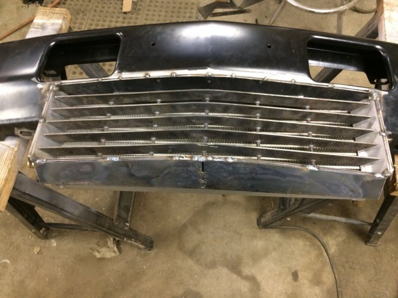

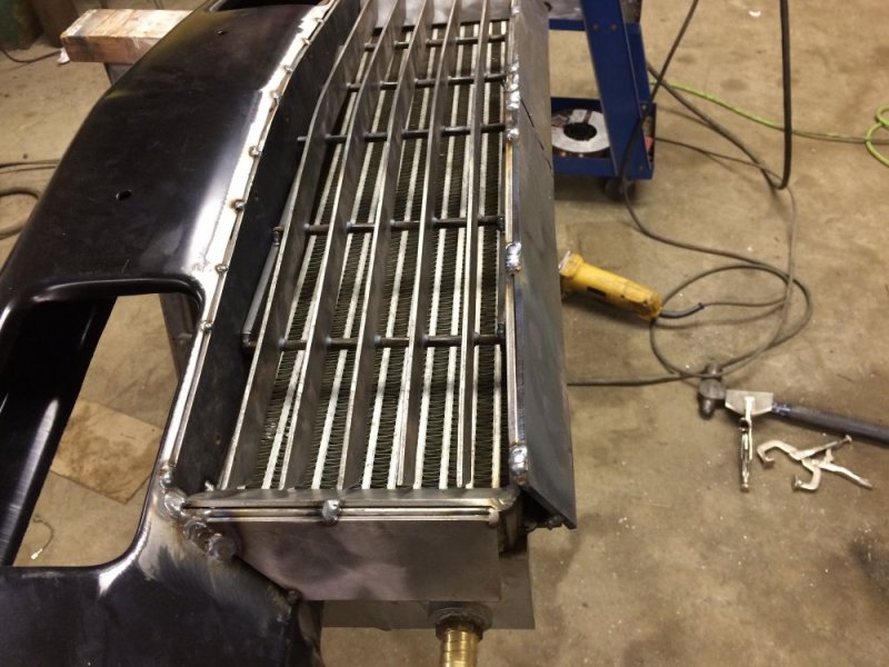

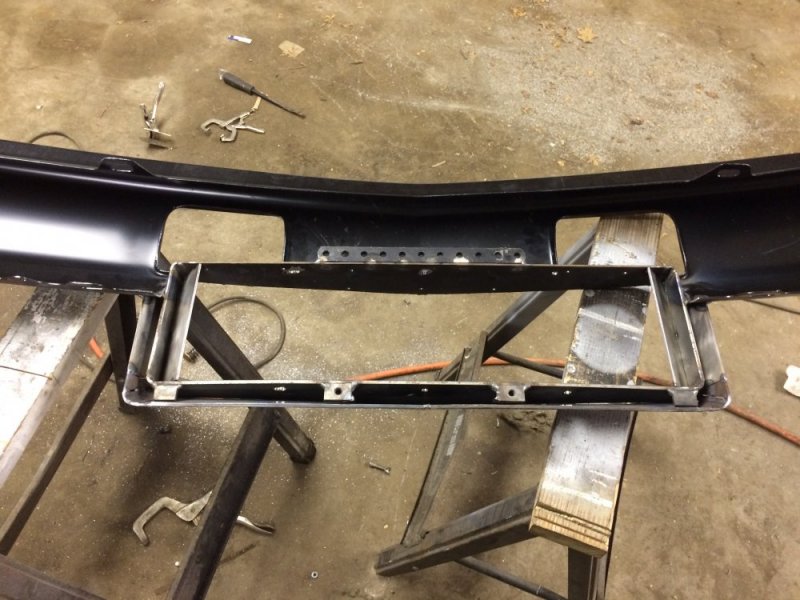

Ok the grill insert is done - well, except I'll probably take it to work and weld the connections a little bit more with a TIG welder to get them fully welded and keep the weld small. It fits pretty nice.
Next I'll be adding the trim around the bottom of the "mouth".View attachment 49436View attachment 49437View attachment 49438View attachment 49439View attachment 49440View attachment 49441

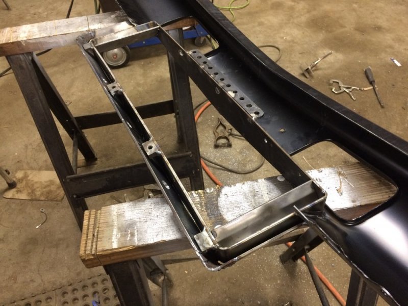

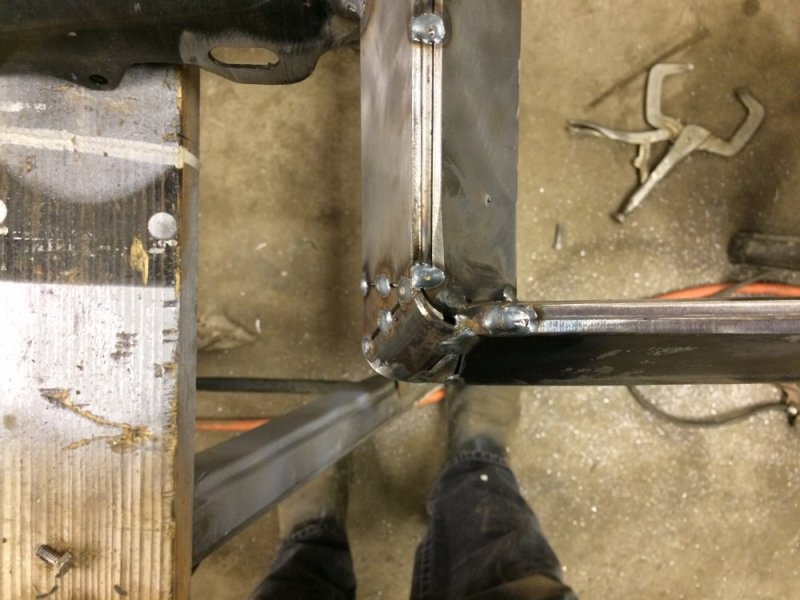

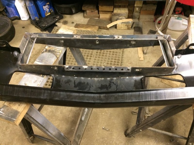

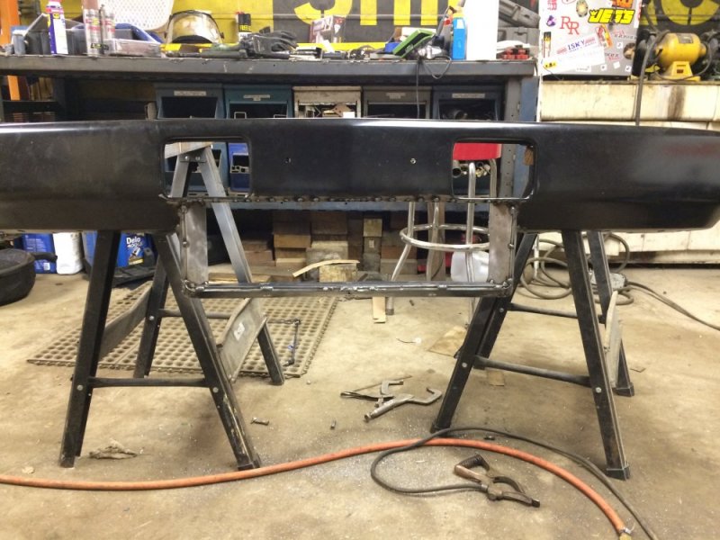

Not as much progress as I had hoped - this part really fought me even with cardboard templates and the fire wrench to coax the metal. But the bottom is now in place the way I wanted. Now I just need to connect the dots in the corners. IMG_7711.JPGIMG_7712.JPG

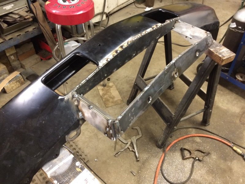

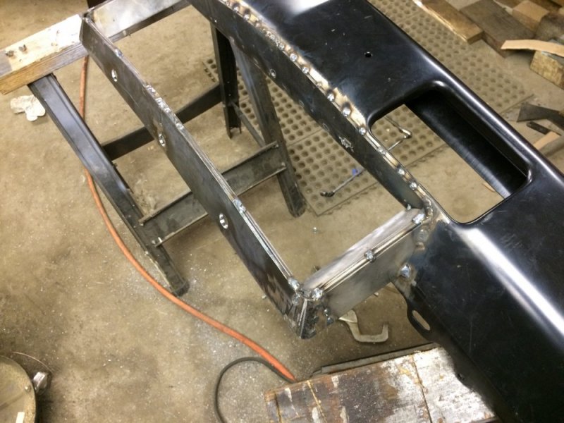

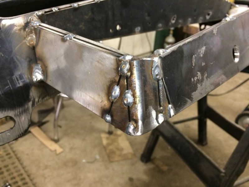

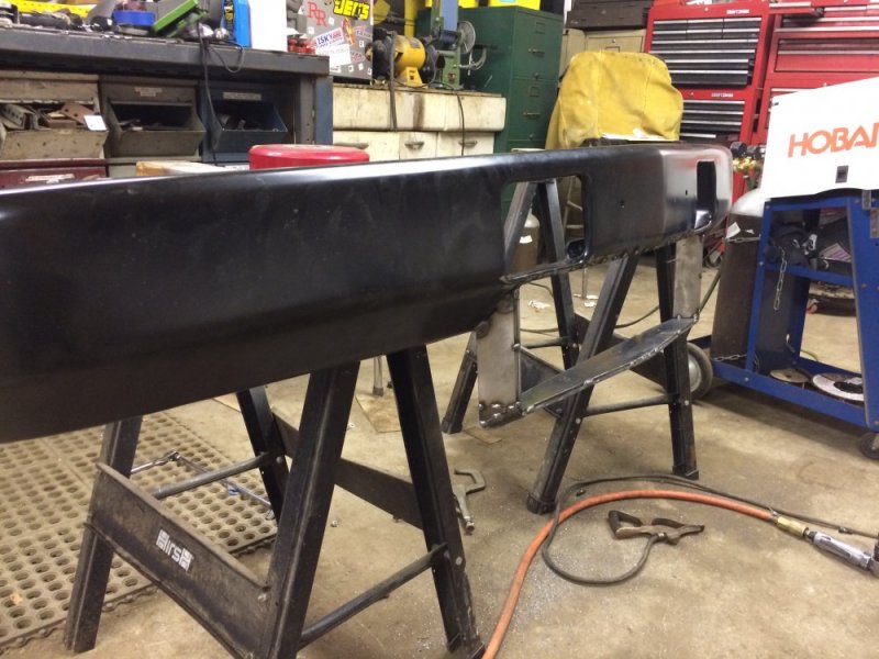

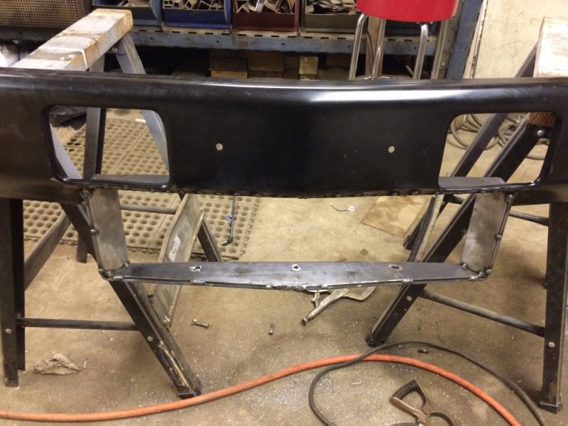

Tonight felt much more rewarding and took less time to accomplish oddly. I made the corners around the mouth and added the access holes for removing the grill. I'm pretty pleased and unfortunately it doesn't show up in pictures as well as it does in real life. Tomorrow night I'll be removing the stock bumper. We'll see if there's enough time to hang this one and see how it fits. I see a lot of welding and grinding in my future.....IMG_7713.JPGIMG_7714.JPGIMG_7715.JPGIMG_7716.JPGIMG_7717.JPGIMG_7718.JPGIMG_7719.JPG
