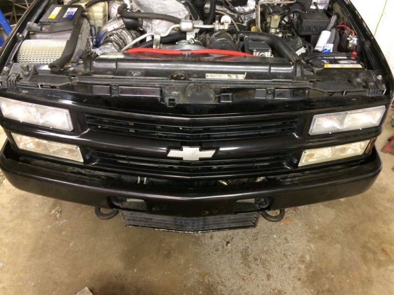

Weld, grind, some Bondo and a lot of elbow grease, but you can definitely see where this is going and what it'll be when it gets there. Nate, have you thought about welding on an integral chin spoiler to the bottom of the bumper, the bottom edge of which would be even with the bottom of the CAC radiator frame? Two reasons. 1) Increased aerodynamics/fuel mileage/low pressure area behind radiator to help pull air through. 2) It would really stiffen up the entire new opening which would help tons in reducing possible impact damage to the CAC radiator area from road critter strikes, deep snow drifts, high curbs when parking, etc.

I have thought about it. And I'm still considering it. My initial plan when I conceived this in my head was to actually cut and stack 2 bumpers, but went this route instead. I was thinking keeping a plastic deflector on the ends would be smarter for future road damage, but you bring up good points about rigidity. Hmmm.

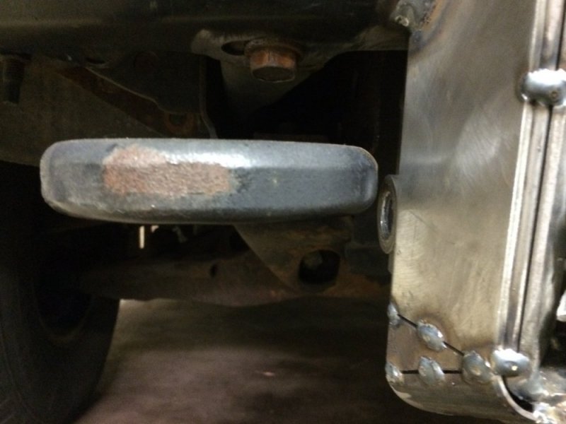

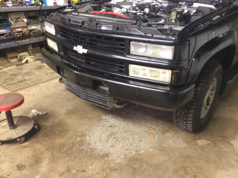

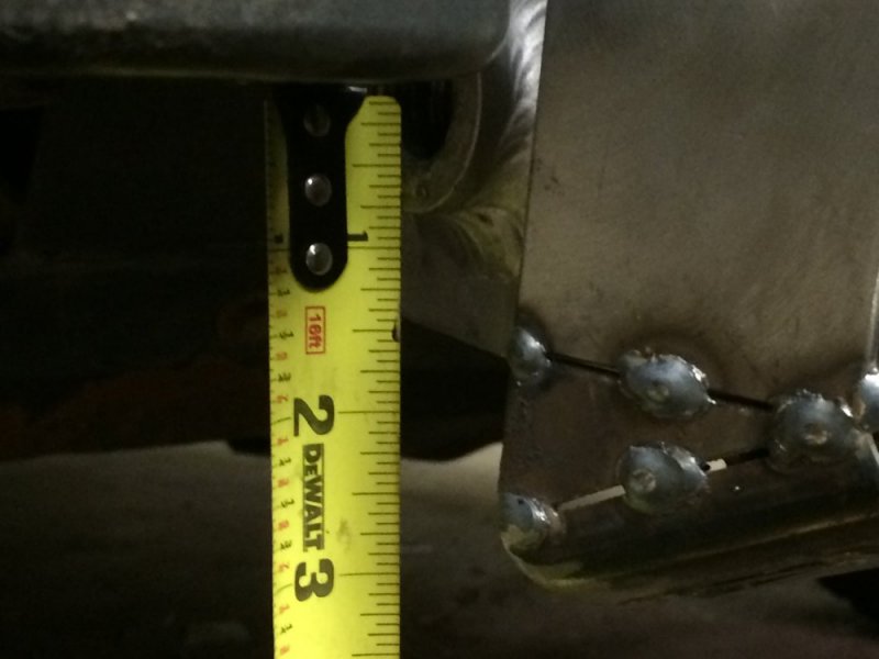

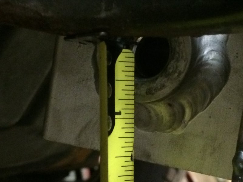

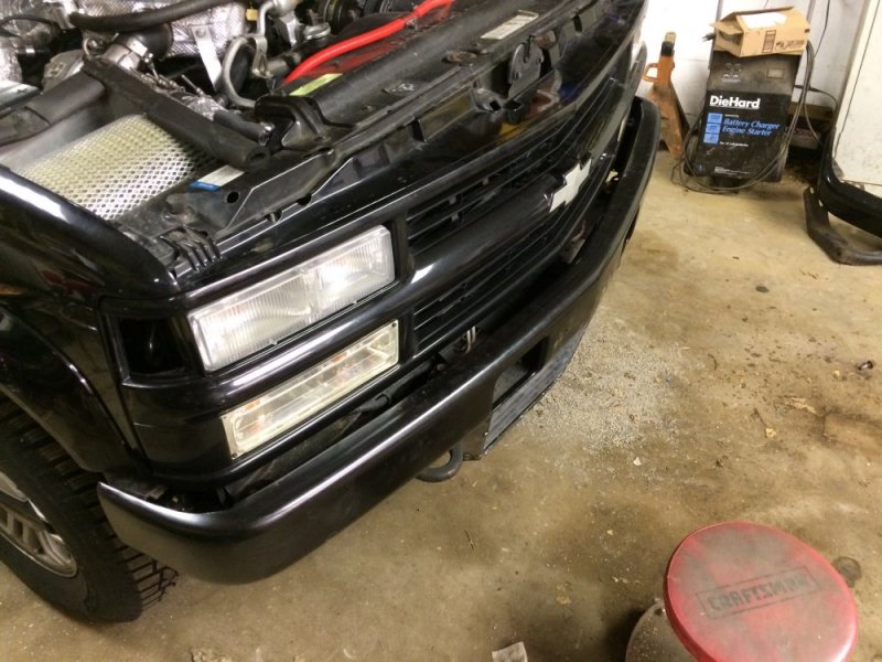

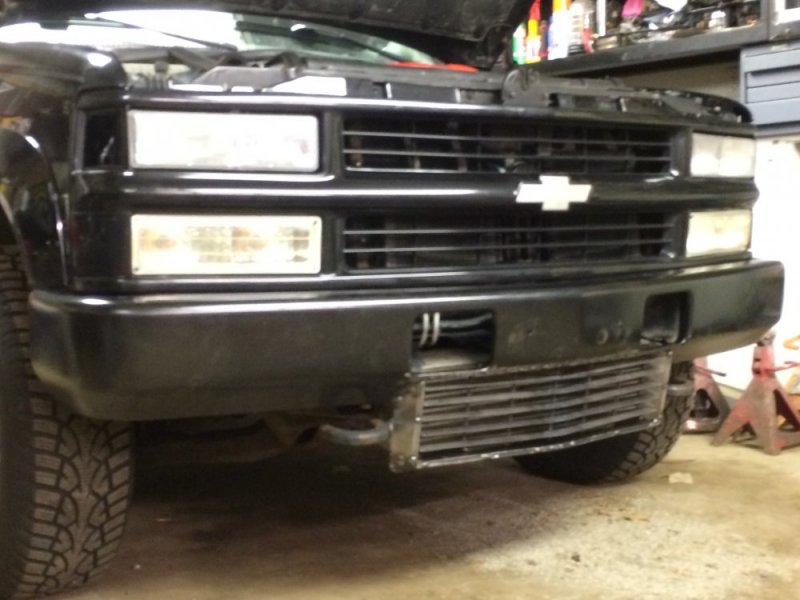

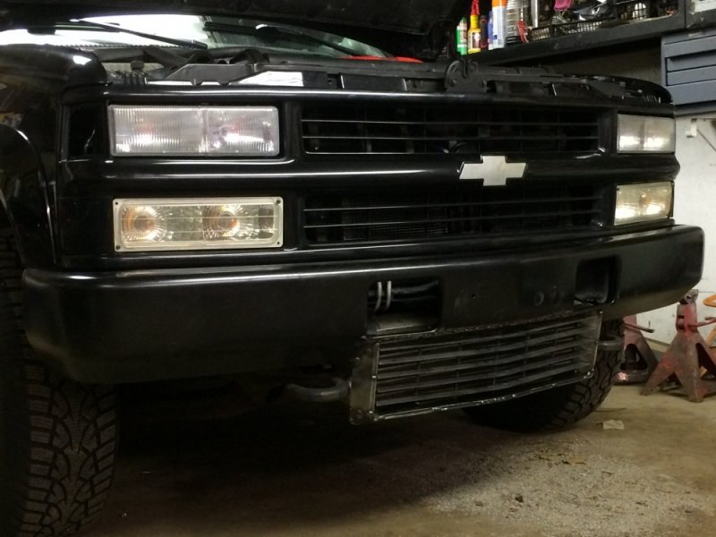

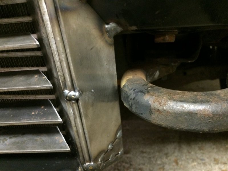

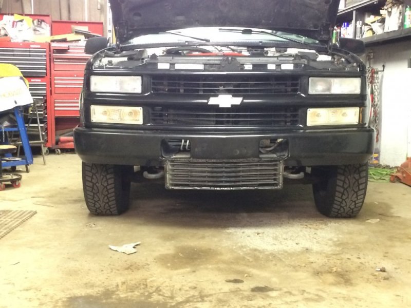

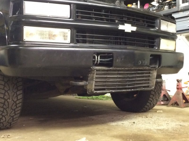

Well I did the test fitting tonight. It could have gone better, but I got the info I needed. The bumper itself fits well, but I ran into 2 problems with the heat exchanger.
The first one was that one of the fittings is right inline with the hook on the passenger side. I'm not sure what I'm going to do about that yet.
This is a companion pic of the driver side.

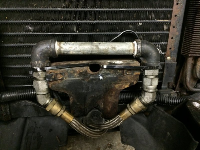

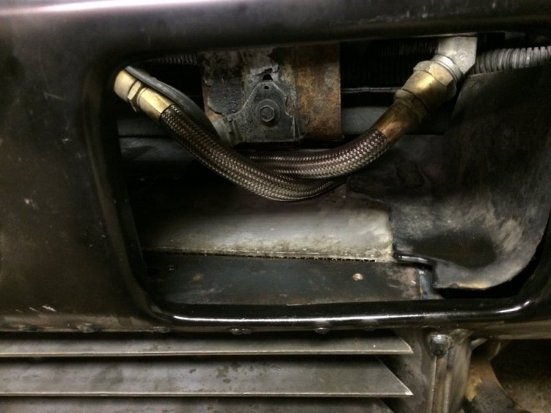

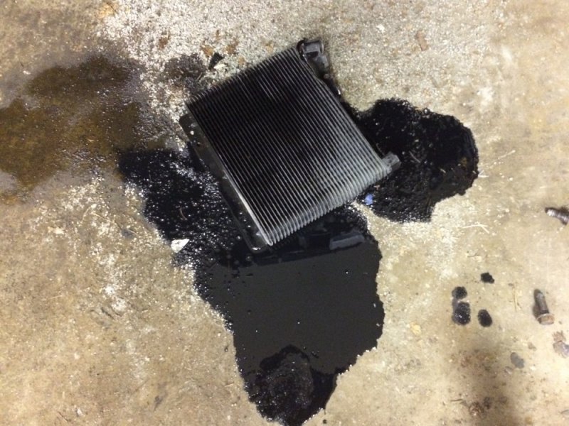

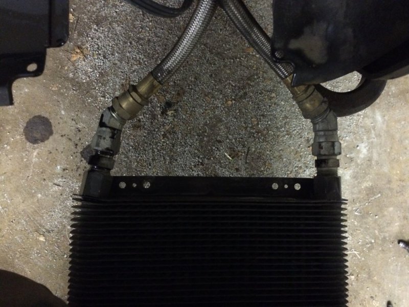

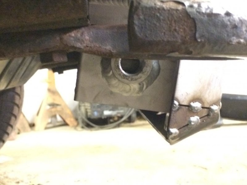

The other was that it was hitting the oil cooler lines. This could be addressed with some subtle rerouting.....but for tonight I thought I could just push the line out of the way a little. Well this is when I found out that Leroy's oil cooler lines are MUCH stronger than the cooler itself!!! So I got to be in emergency repair mode, yay!!!
Anyway, take a look at the pics and let me know what you think! I think it looks pretty good, just gotta figure out the hook thing.....
