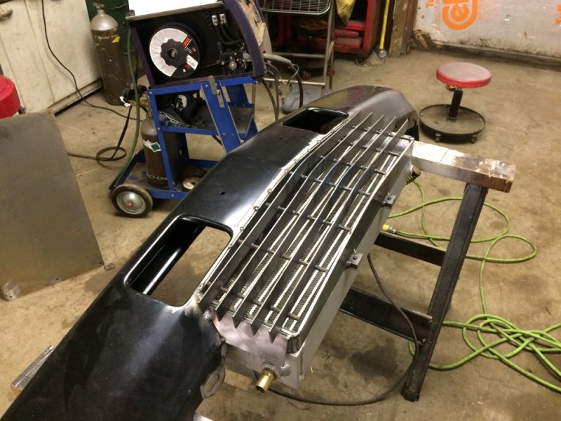

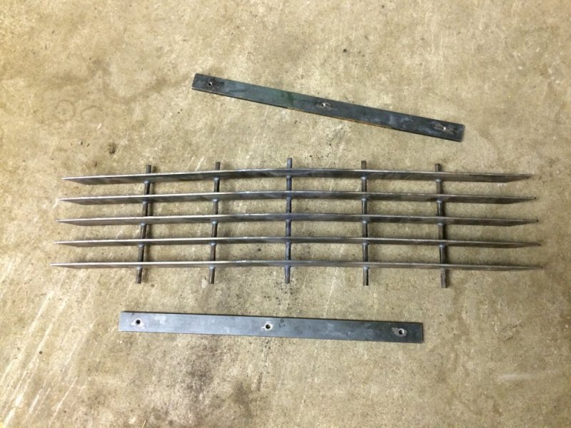

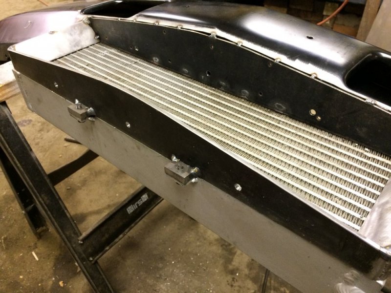

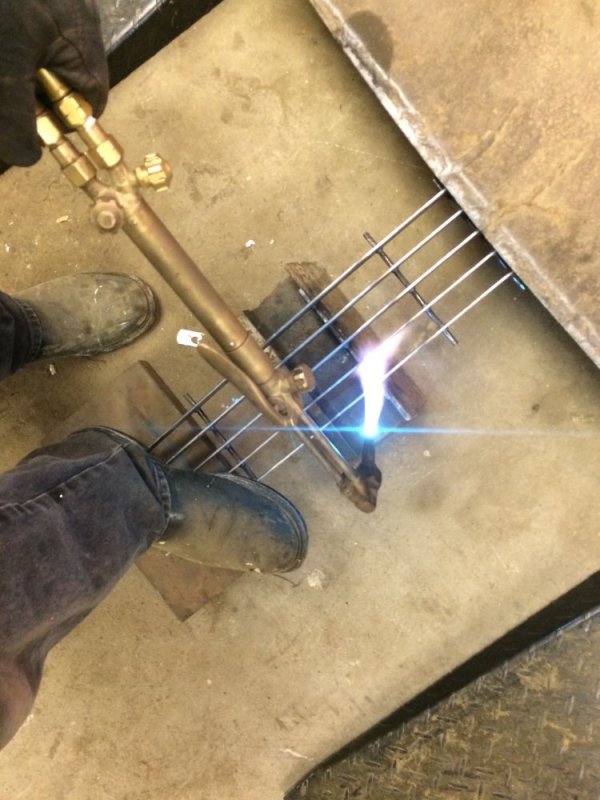

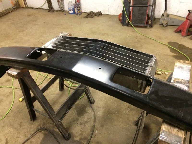

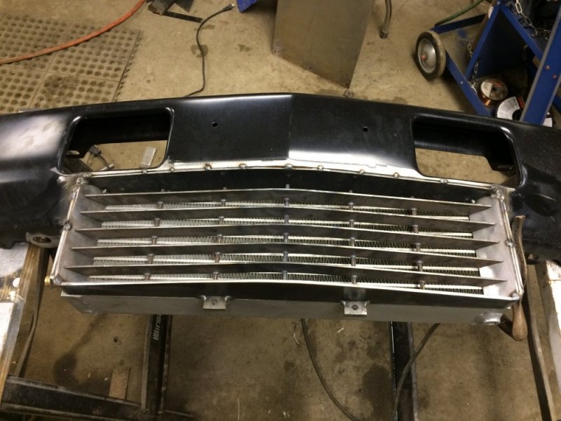

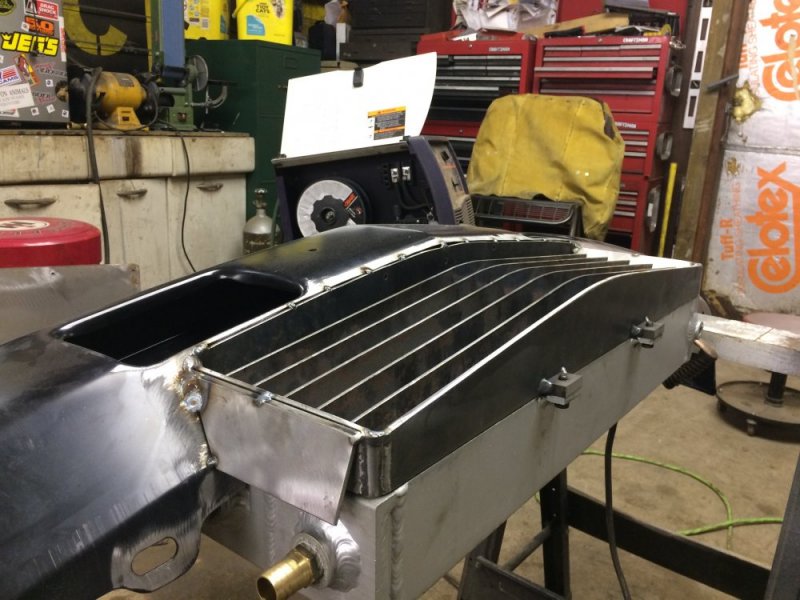

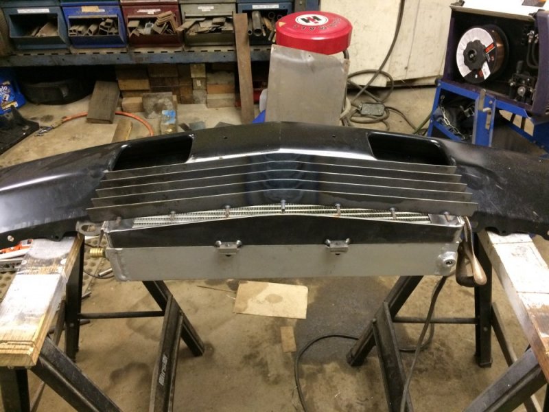

I was just going to make the grill flat in the opening, but since the rest of it was turning out well I decided to get a little fancy......and I'm pretty darn pleased with the results!! :D:D:D
Now I just need to trim the ends so it fits down in the opening.
