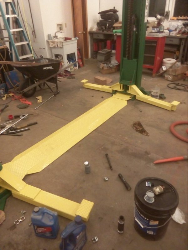

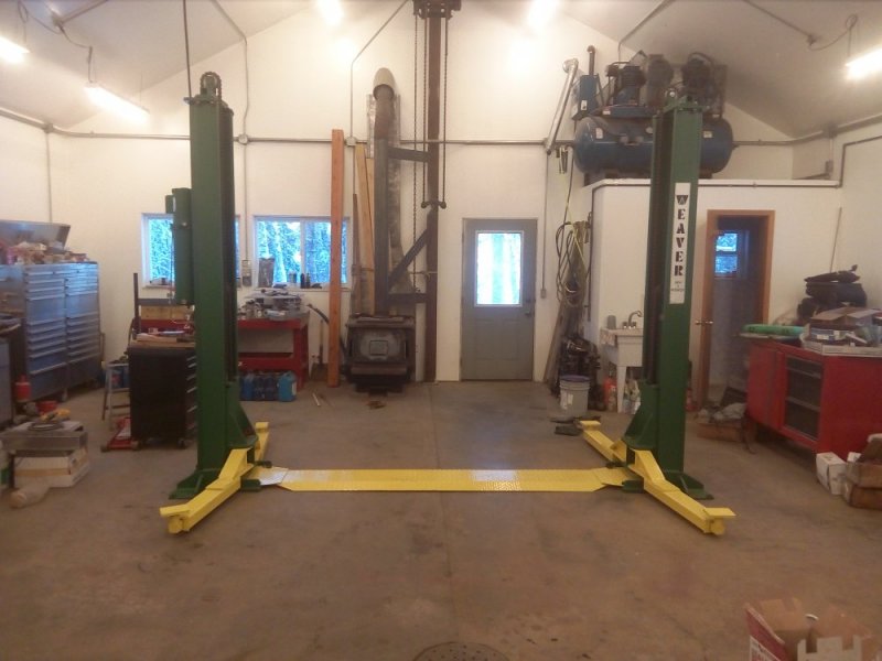

His lift is going for the Packers, thats all. Shiny paint is always nice in the shop, and easier to keep clean. Wish I had a lift in my shop, regardless of color. Of coarse, my roof would have to be twice as high...

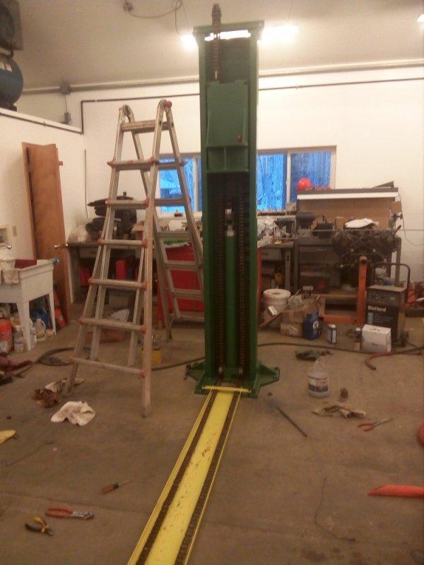

Better the chain description is rusty and stiff vs rusted apart.

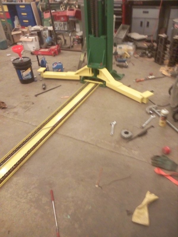

No I did it the hard way. Wire wheeled it to get the big stuff off and then soaked it in acetone/ATF. Then stuck it in my vice and worked each individual link loose.
Get ahold of mrf. see what they recommend. Many mechanic shops use atf cuz they get have it on hand.
Some pumps are tighter tolerances and spec 10 wt (atf is 10) instead of hydro.
What kind of safety stops do you have on that?
Will, I was assuming a well worn gear pump running in a relatively warm environment would live pretty good with AW32 which is fairly common universal hydraulic oil

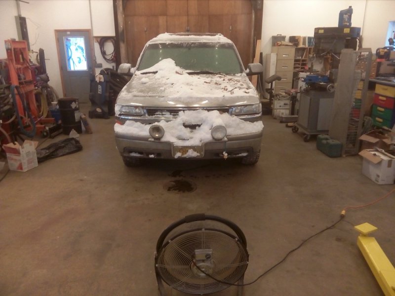

You'd be surprised how much faster it'll thaw out with a fan. It'll probably only take 2-3 hours to deice it. And that's coming in from -10
