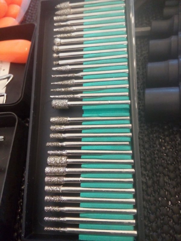

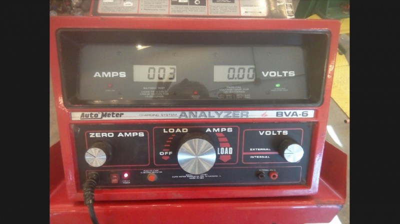

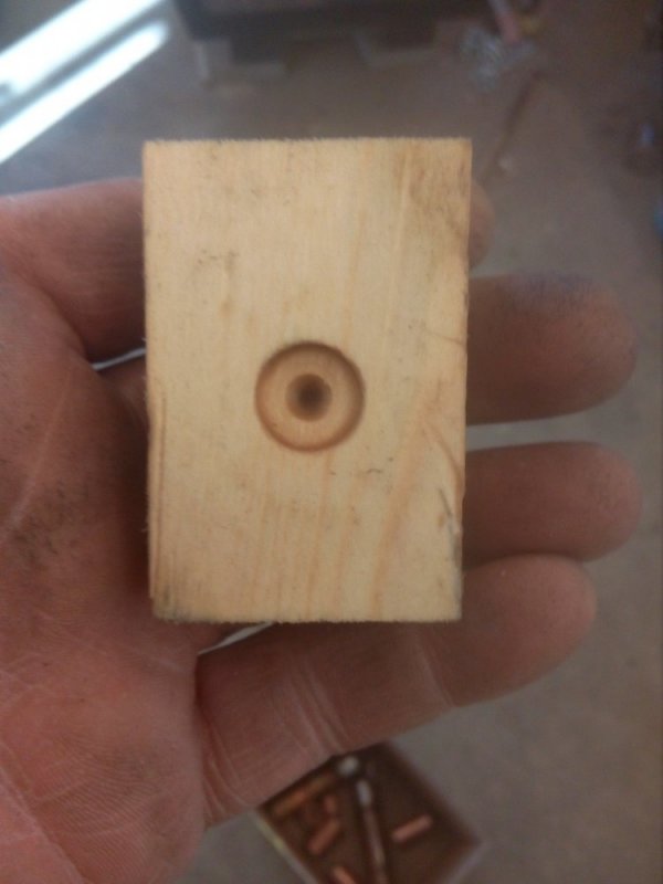

Screenshot_2017-03-11-19-43-43.png IMG_20170311_112958.jpg IMG_20170311_112513.jpg So a few years ago I picked up a battery load tester and charging system analyzer. The carbon pile didn't seem to be working right so it took it apart to see what was wrong. Basically the metal plates on either side of the carbon pile were corroded and not conducting properly. As I pulled it apart some of the ceramic insulating washers fell apart. Couldn't get parts from the manufacturer anymore either. So I found some on eBay and ordered them. Well life got in the way and the project got shelved. So I pulled it out of the shed where I'm installing my boiler and put it in the shop. So I had a little spare time and decided to see if I could fix it. Turns out the washers weren't quite right. The center hole was too small and it was also too thick. So I picked up a set of diamond burrs off eBay and used my air die grinder and some water and drilled them out. Then I took a piece of 1x2 and drilled a hole to the right depth so the excess part of the washer stuck out and used the side of my tile saw blade to remove the excess.

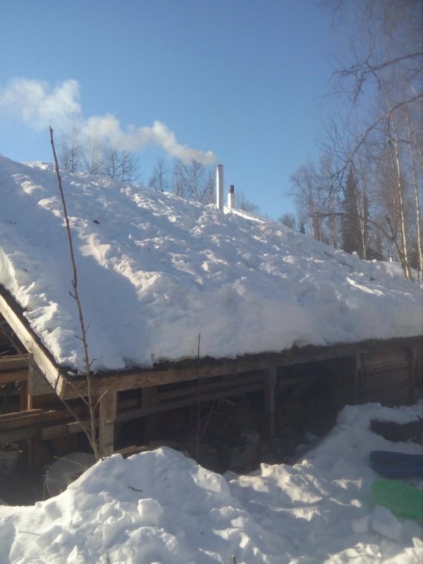

You guys have to figure the snow weight load per square foot and at some point get some of the snow off of the roof?
This isn't alot of snow for here. Probably only 50-60% of an average winter. Snow load for here is 90 lbs but there are occasional years where that's not enough.

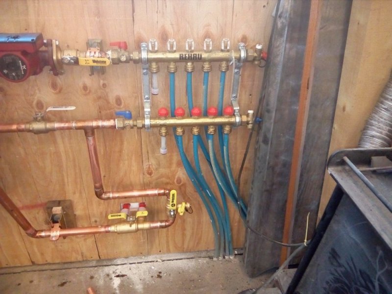

Did some rough calculations and not including the tubing in the floors or the concrete over them I'm into this about 12-13k.
