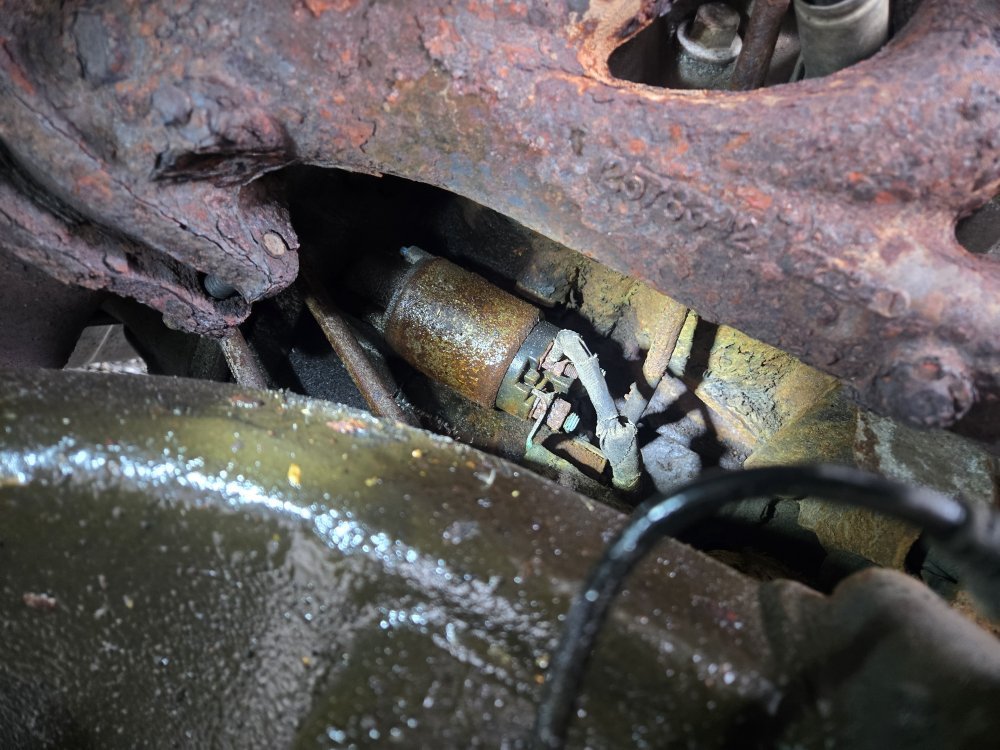

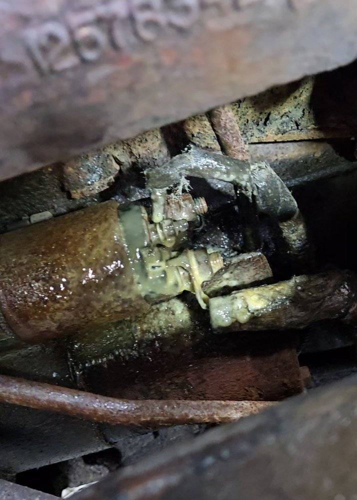

Had a click, no crank, no start. Upon further inspection arcing at the starter solenoid. Cleaned up all connections and douched in Fluid Film. NY is why we can't have nice things.
All is well in life again.
