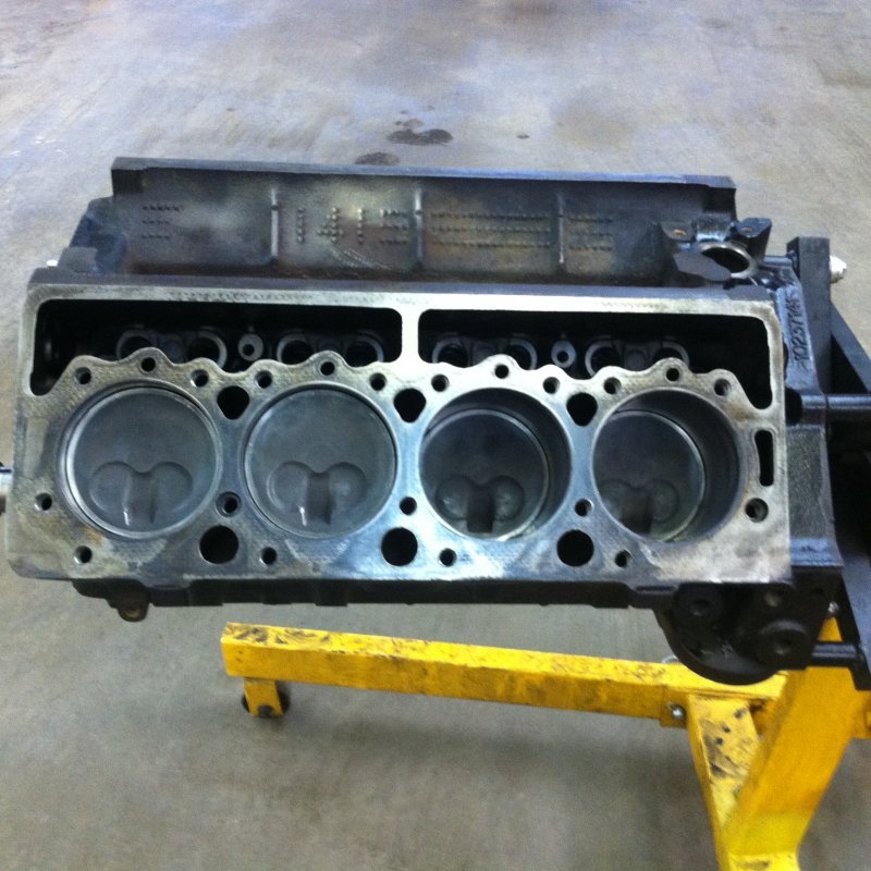

Just behind the #7 cylinder in front of the bell housing is a number, the last 3 digits are your block casting.IMG_0516.JPG
Sorry I can't help ID it.

No problem Leroy, the pic was just to show where the casting number was, it's a pic of my block.
I know one of my spare blocks is a 141. Didn't have any numbers cast into the valley, but has the dots. I ended up finding the number cast into the back of the block. Would be kind of behind the flywheel, just below one of the bellhousing bolt holes. Lot of work to just ID a block that way though

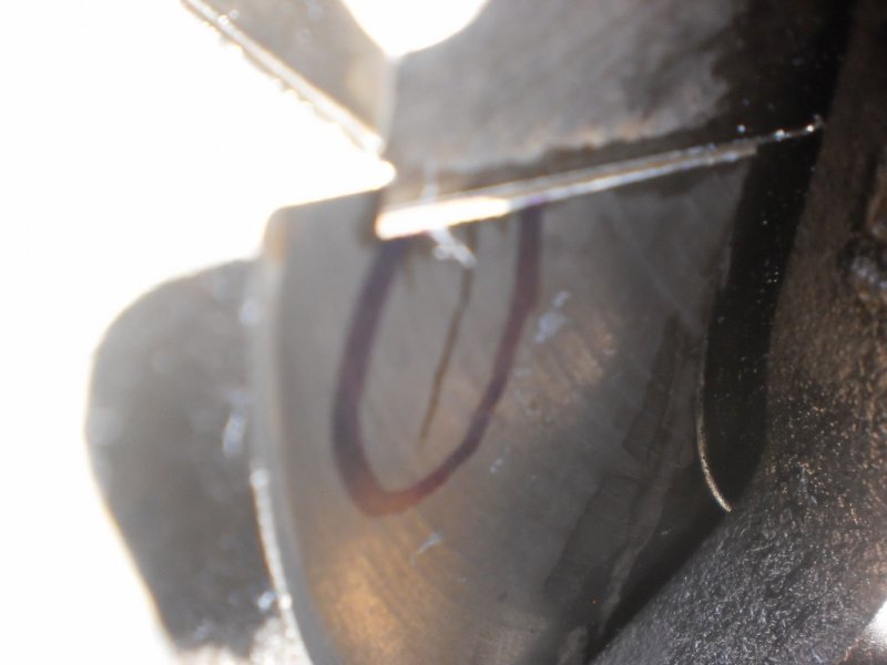

With your camera touching the firewall, take a pic straight down, to where the trans bolts to the engine. That is where I think you'll find your missing numbers.

Oh, checked block number today.. master wire loom and ac lines certainly make it difficult. Tried to snap a pic but couldnt.. Gonna try again with better lighting this weekend. I am wondering if I should put a stock engine in it, and rebuild mine? Block number will help determine.
