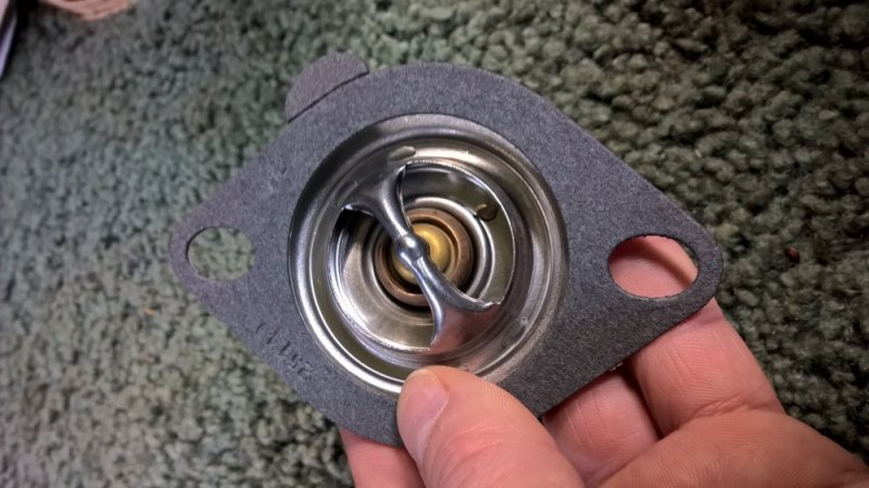

The rubber gasket has a groove on the inside edge, the outer edge of the Tstat fits in the groove. It makes a nice seal.
The ones that use the rubber also use it to seal the thermostat from leaking coolant past it. So even tho its not leaking externally it might be letting coolant past internally simulating a stuck open stat.
Yes, that rubber split O-ring that goes around the edge of the T-stat is crucial to prevent coolant from going past the edge of the flange and around to the radiator side of the T-stat. That 1mm around the edge would be like having a 3/8" hole drilled through the T-stat flange.
All that is true but just so people don't get confused, with mine on the '93 there is no rubber gasket. It is a paper gasket.WP_20160405_15_09_50_Pro.jpg

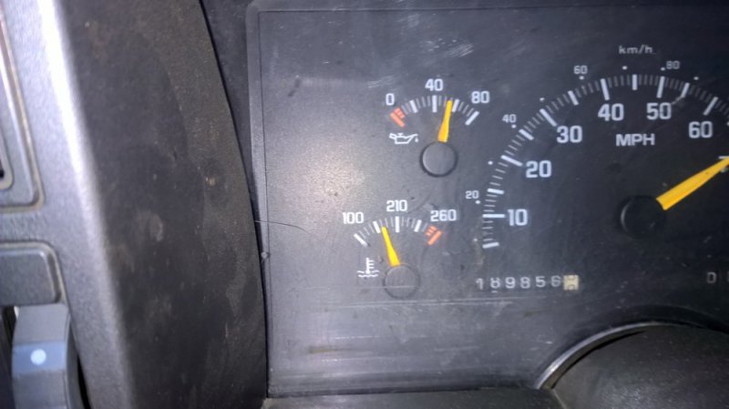

The rubber seal were talking about has NOTHING to do with the t-stat to housing. It goes around the actual poppet in the stat itself to make it seal off tighter so that no coolant can get past the poppet. I believe you said you changed senders, if so you are running nearly axactly the same point on your gauge in your 1st pic as I was with a 180 stat and 3 different senders in my 95. The new senders are not calibrated correctly, and it throws teh gauge off about 1-1.5 hash marks from where it should be. As the temp goes up, they read closer to correct as mine reads about 185-190 when it reaches 195, but when the engine is cooler, it reads way low.
Look at this picture. See the black portion below the housing, thats the rubber seal around the poppet valve. It tightly seals off the stat until it opens to prevent ANY cooling from bypassing until the stat is up to temp. ONLY the OEM AC DELCO has this to my knowledge(not even the cheap AC DELCO has it, and they are no better than the $5 cheapy's). You will also notice this is an all around different designed stat, and is of a MUCH higher flow design than the internal poppet like the cheapy's use.
Oh man, sorry about the confusion. I know you kept saying poppet, but it just wasn't going in my brain.
See? pictures are good! : )>
And no, the gauge is not linear. The bottom mark is 100(even though 95+ diesels start at 160, it is actually 100), the next is 180(verified 3 different clusters that this mark corresponds to 180 degrees for resistance), then 210 is straight up, and it's pretty linear from there over with roughly 235 at the next hash and 260 at the top.
So *THAT* explains the wide temperature variances from the dash to ECM readings that I see when the motor is warming up. And why once the motor is up to operating temp the dash and ECM appear more in synch . . .

BTW, to compare with the picture in the original post, here's the gauge with the 195* AC Delco thermostat on the same road at the same speed.WP_20160405_19_14_48_Pro.jpg
Oh wow, yeah that blows.

New sending unit may have improved accuracy somewhat, but the guage still reads high.

I'm thinking that my gauge is fairly accurate (within Therms' guide from this thread, i.e. first large notch is 180* and getting more accurate from there) since my IR thermometer read 177* right on the sensor when the gauge read 180*.
