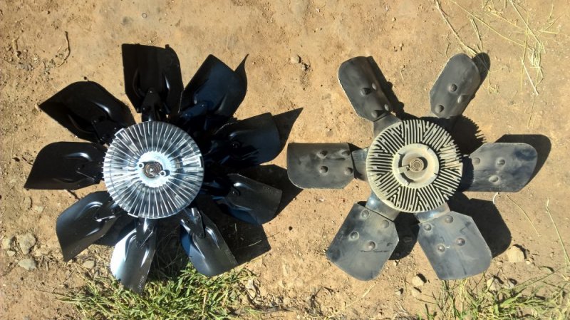

Curious as to what fan blade you are running now? Does it come on and scream when things are warming up? What is the history of the radiator and condenser? New, rodded, etc.?

I'm glad you asked about the fan. It is just one of the several things that confuses me. I have Kennedys 180* HD clutch and the fan he sold with it. It's a 1997+ 20" 9 blade steel fan that he recommends. Apparently I got one of the last ones available that he says now are sold out.
My confusion; I never hear it. Not really. I've heard a fan in full lock up in a 454 motor home and it was LOUD. I never hear mine. I just told myself that it was because a gasser is quieter than a diesel and it was right at my elbow under the engine cover. But I really expect to hear mine more. Even when I get out and open the hood when it's hot, nope.
I did get one of his fan clutches that were bad and John traded it out for me and it is better, I can FEEL the air moving when I'm looking down on the engine, but again, I expect to hear it.
I meant to post this...

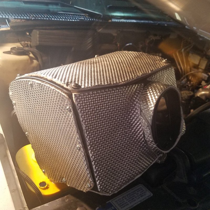

The next day, I went out and finally got something done that I've wanted to do for a while...
And I sealed it to the fender opening.
I'm looking forward to seeing the performance, although the weather is cool enough that I don't expect that I would have any issues.
