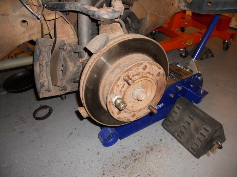

How to: K2500 lug replacement - 8 lug, 4x4

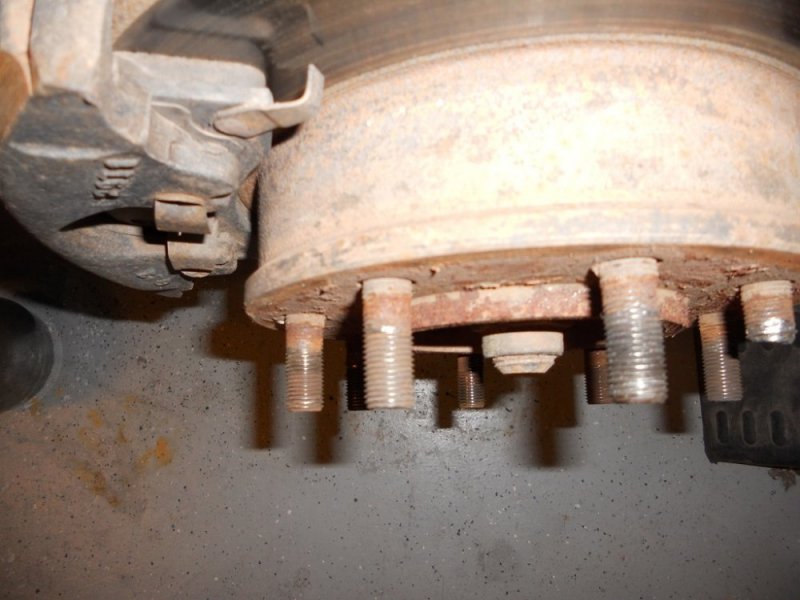

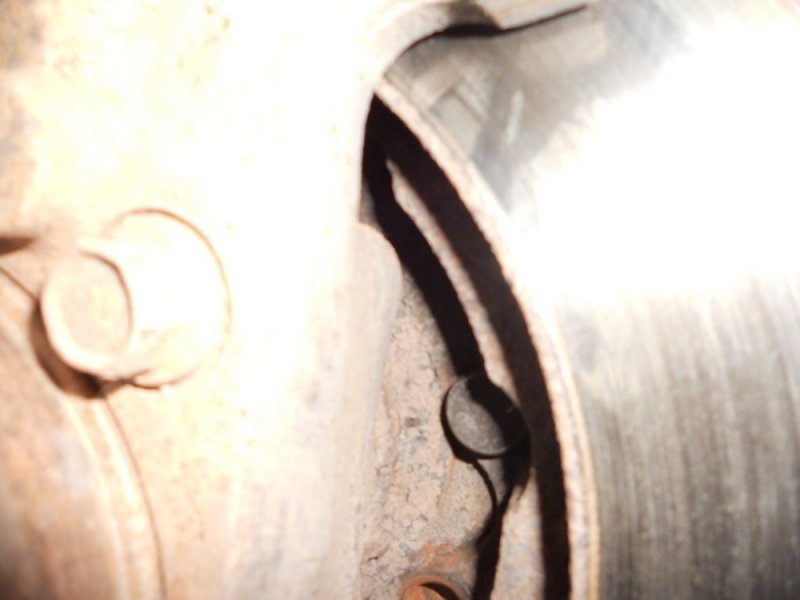

Yes, you can replace a stud without pulling the spindle. PO had a wheel come loose ruining the lugs and the rim. I used the big impact to snap one locked up lug nut off.
Anyway it's only required to remove the brake caliper to access the lugs. (Yes there is a jack stand under the truck in addition to the jack.)
Note the nut used as a spacer to tighten the lugs in and two left in at all times to keep things together.
