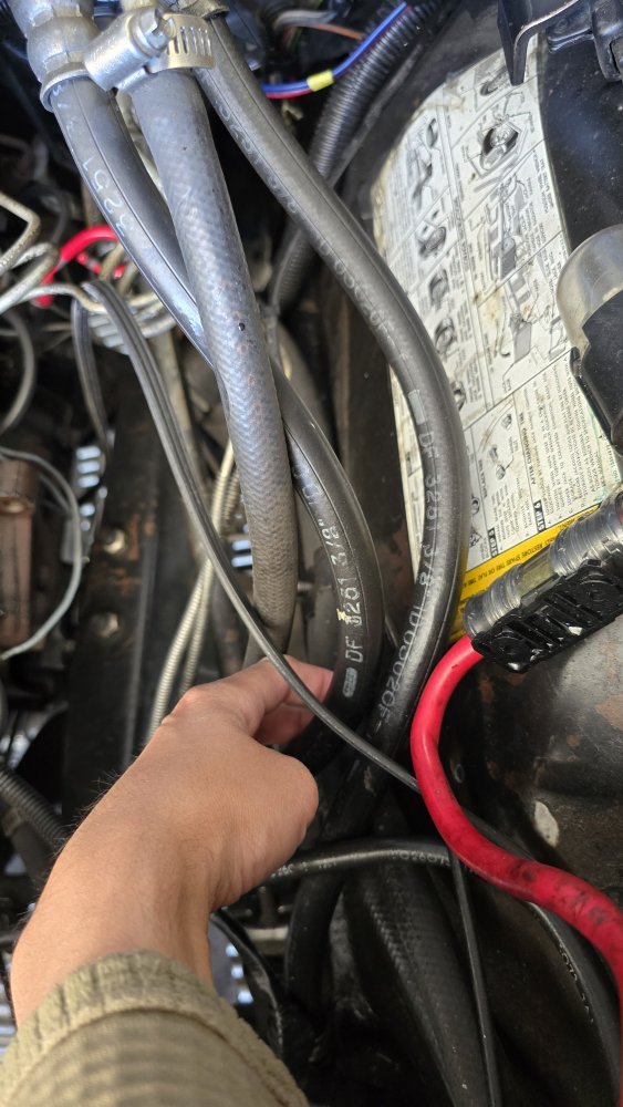

Yup. Thats looks like them to me.
You can have them re-use the metal part of the lines or you can remove those flare adapters and just use regular fittings and route the houses as you see fit trying to keep the hose away from the hot exhaust as much as possible and in a way that follows the frame up to the front to the oil cooler.
Those older style are more reliable than what GM did later.
I would carefully investigate them for any signs of seeping, leaking, getting soft in any part, and chaffing, etc.
The ones Leroy sells will NOT replace theses.
This becomes the guessing game. Original high quality ones are nla. Aftermarket ones are not as good as original but originals will fail in time. Replacing pre made aftermarket ones is better than running originals until they fail is obviously not good. How much longer do these last is the gamble.
I’m in favor of industrial hydraulic hoses in place of them. Give me a few minutes and I’ll post pics of what hmmwvs/ Hummer used as the example- they used the same type of industrial hydraulic hose I am referring to.
If his cooler is in the rad the premade kit may not work.
I haven't looked at changing lines on a vehicle with the cooler in the radiator.
It seems to me if he got the complete kit with the cooler, he should be able to install the kit. He probably would need the line holder brackets.

Then run the hoses along the lower side of the block, like the 1988 trucks ? ?
Since I'm running a new aluminum
You sure what you have your hand on isn't the power steering lines? the oil cooler lines should run along side the block where the pan meets the block up to the front where the harmonic balancer is then transition to rubber under the fan shroud to the oil cooler that sits in front of the radiator. you shouldn't be able to access them from under the hood.
Faily certain those are the oil cooler lines

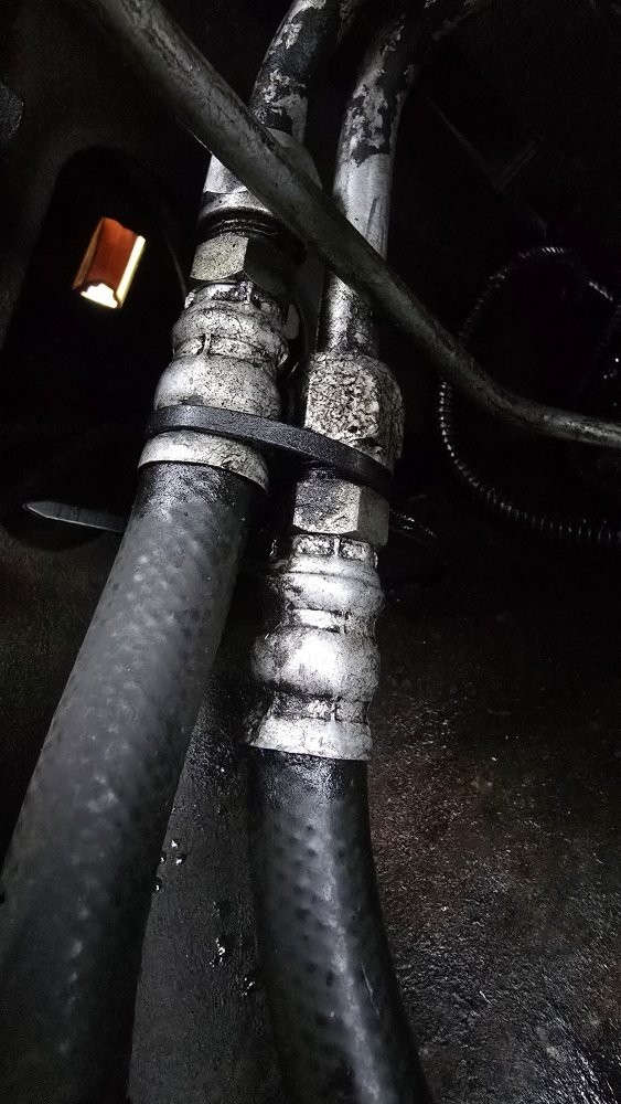

I think those are the oil cooler hoses.
One way to tell is to loosen one of the fittings at the radiator and see what color the leaking juice is.
Yep those are the oil cooler lines. looks like they are leaking at the crimps. also as AK said, your valve covers are leaking also. if you look at where your injectors are on the engine, that area all looks oil soaked. that would be coming from the valve covers.
Time to replace them, then? The hoses look and feel new, not dry rotting or anything
if it's not leaving puddles or lots of drip spots on the ground everywhere you park, I wouldn't worry about other leaks like valve covers. with valve cover leaks, you main concern is oil getting into the starter and it going out. worst case is when the starter is hot from the engine running a while and you pull into the drive through, shut it off and it doesn't want to re-start due to oil soaked motor windings shorting out. replace the starter and keep going....
as for the oil cooler lines. just clean them off real good around the hoses, crimps, and metal lines. run it a while and keep checking for where they are leaking. you don't want those leaking, if in doubt, replace. if they blow it can take out our engine in seconds. leaking gaskets are not gonna ruin you engine so long as you keep the oil topped off. it's the cooler lines where when they blow, it's game over.
as for the oil cooler lines. just clean them off real good around the hoses, crimps, and metal lines. run it a while and keep checking for where they are leaking. you don't want those leaking, if in doubt, replace. if they blow it can take out our engine in seconds. leaking gaskets are not gonna ruin you engine so long as you keep the oil topped off. it's the cooler lines where when they blow, it's game over.20250402_111848.jpg

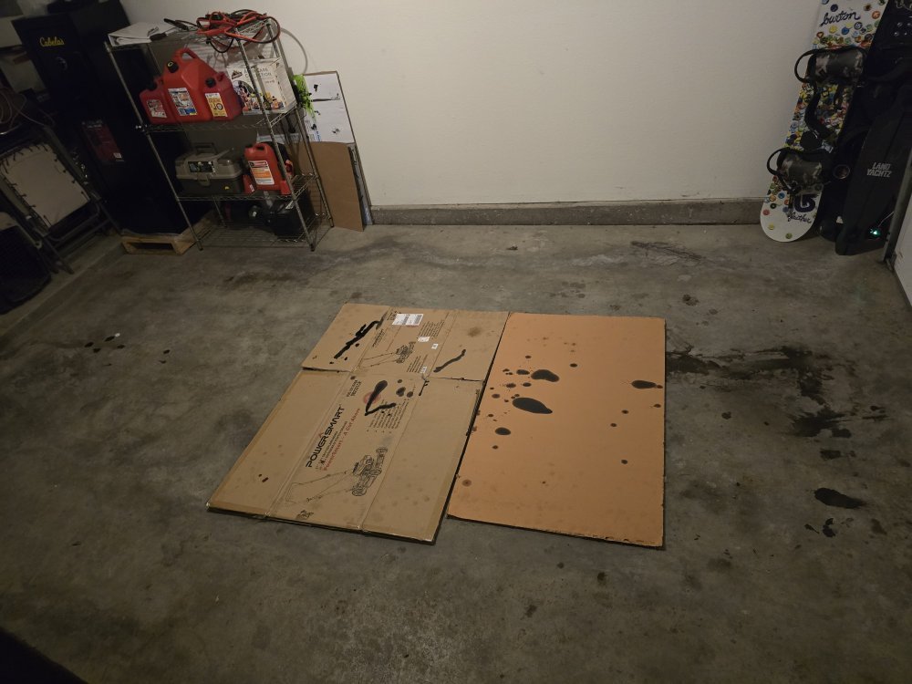

This is typically how much oil it leaks

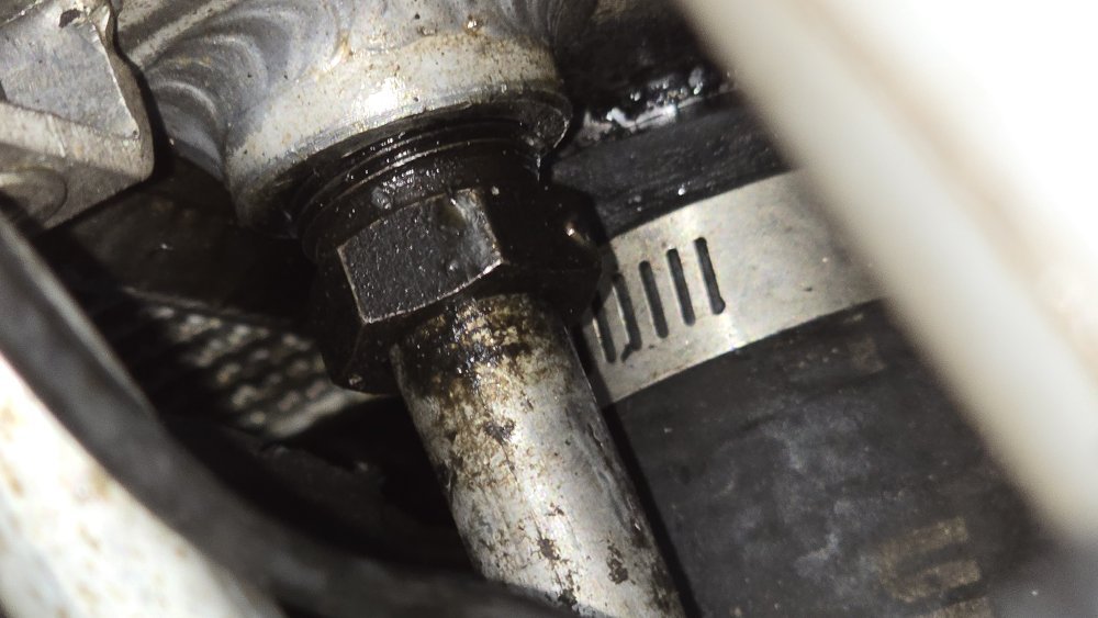

Will wash those clamps off and check to see if they are leaking or not though
doesn't look terrible. the oil sheen on the water makes it look worse that it is. I would just clean it up best you can. might even spray some brake cleaner to dry up around the injectors too while your at it and just drive it. keep tabs on where it starts to show fresh wet spots and oily areas. you'll know in a day or so exactly where the leaks are.

I did notice in one of your pics that a clamp on one of the oil cooler lines looked to be wet with oil. those areas are suspect. if you want to keep your existing lines and use the factory oil cooler that's in the radiator, you'd most likely need to remove the lines from the truck to cut the clamps off and replace the rubber hose. otherwise you can get the complete kit from Leroy that comes with steel braided hoses and a cooler that you can mount in front of the radiator. this would eliminate the factory cooler completely. just depends on what your prefer and what you want to spend.
cheap is to replace the rubber hose on the existing lines, higher cost but better for long term is the kit. labor is about the same imo.
just keep in mine that hoses might look good on the exterior, but if they are factory for your truck, they are at this point 45 years old.

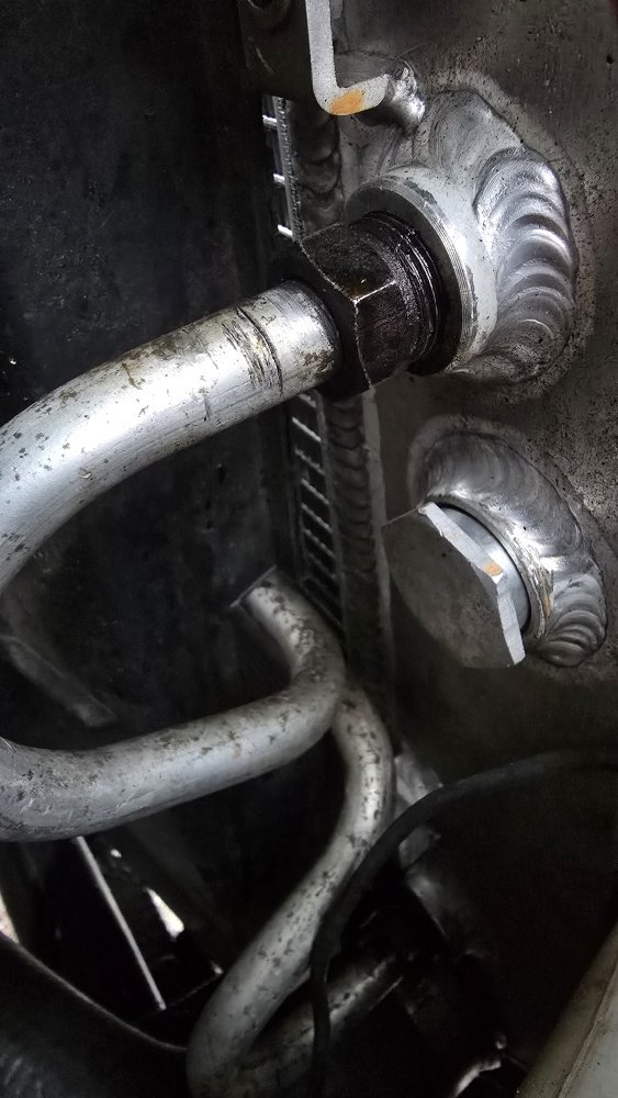

Ill do what I can to find the leaks, or see if it is leaking, however, im not quite sold on the external oil cooler, as I already have a new aluminum radiator connected to it, and it keeps it fairly cool, at +80 MPH, even when it's 70°F here it doesn't go past 185

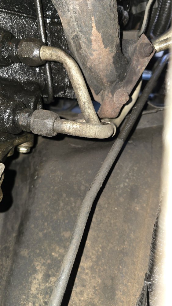

More photos of the oil cooler lines btw, clamps from both ends
also, someone recommended me this, looks like the one i have currently
