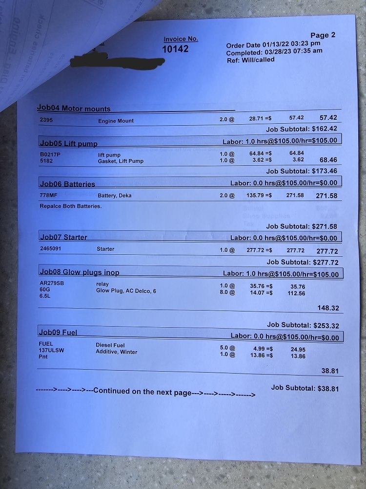

20240629_112414.jpgwell sir as you can see, the previous owner did the glow plugs back in 2023, says the relay and glow plugs themselves were done.
looking at your video, I think you have one or maybe two cylinders that isn't warming up as well on the GP's could be a loose connection or a GP is failing. it doesn't hurt to pull the, mark which cylinder each are from, and bench test them with a set of jumper cables. count in seconds the time each one takes to glow red hot. also inspect the tips for erosion. the amount of erosion and color of the GP tips can tell a person how the engine is doing. same for reading a spark plug on a gasser.
Your receipt says only 6 glowplugs . Most likely the hardest to get to weren't done. If you have an infrared heat gun you could shoot the exhaust manifold right where it comes out of the head when you start it and see which cylinder/s aren't warming up as fast. It would be a 2 man job and probably take several cold starts to narrow it down.
