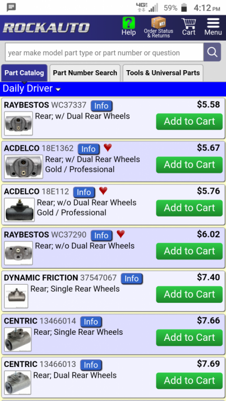

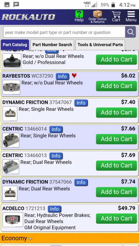

Raybestos are good quality. Get the ones for dual rear wheels. Before you cut the brake cables you might check the cables where they join together into the bracket under the truck. See if one is loose or seems pulled out further from the outer part of the cable with the parking brake foot pedal released If both are tight it may be simply adjusted too tight

And at the advice of @Will L. I bought a line wrench..and a bottle of brake fluid also. I did not buy the rear brake hose or the wheel cylinders because all they have is duro last... I got two different lengths of brake line because I wasn't sure which length I would need.. which reminds me tdo both sides have to be the same length? I don't think they do but I figured I'd ask. I'm not sure if it's the wheel cylinder or the wheel seal that is leaking because it smells like burned motor oil back there around that drum. And I've never known brake fluid to smell that way but I could be wrong.
