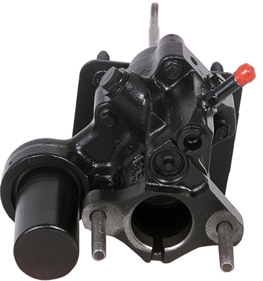

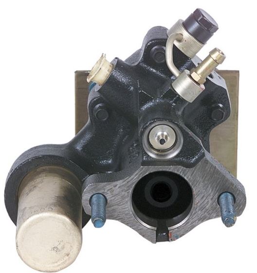

I had the hydroboost question on mine since my original one has some sort of bypass tube bolted to the top side and the one I received at the parts house didn't have this. I haven't found the answer to it, but I'm convinced that it has something to do with the HB having the ability to bypass a portion of fluid to the steering box. ever since I had replaced all the components, my steering seemed a little stiff.
Ironic you say that, I replaced the hydroboost and master cylinder quite a while back.. and it always seems like it screwed up my steering and brakes even worse...
mine stops ok, but I recently found out when towing my daughters jetta with a tow dollie, it didn't like the extra weight. almost ended up in the middle of an intersection. mt pedal has always been stiffer than I prefer as well as the steering. the other day I got to drive my buddy's 3/4 ton dmax pickup, his was a 2003 so it's not much different than mine, but his pedal was a feathers touch compared to mine and stopped on a dime! I know there is something wrong on mine with all the parts changing but just haven't put my finger on it yet.
