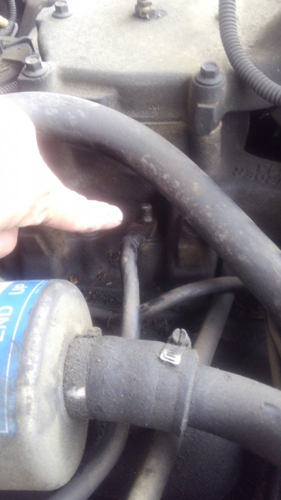

Ok I'm finding a couple things wrong. First.. I went out and for shits and giggles turned the key.. and she started cranking..I didn't start it cause plugs were not warmed up.. before that I had moved a couple wires around on passenger side under the hood looking for anything obvious... So I think it may be a ground problem.. here's where I'm confused a little.. there's a wire that goes from one of the manifold lugs down the side of the engine and into a hole in the frame.

It's on passenger side. And wgii pulled it down a little it's badly damaged. As in one side of it has the plastic worm of and some of the wire is frayed..it's a ground obviously so not hurting anything by touching anything but it could be effecting grounds somewhere because it's frayed so bad...

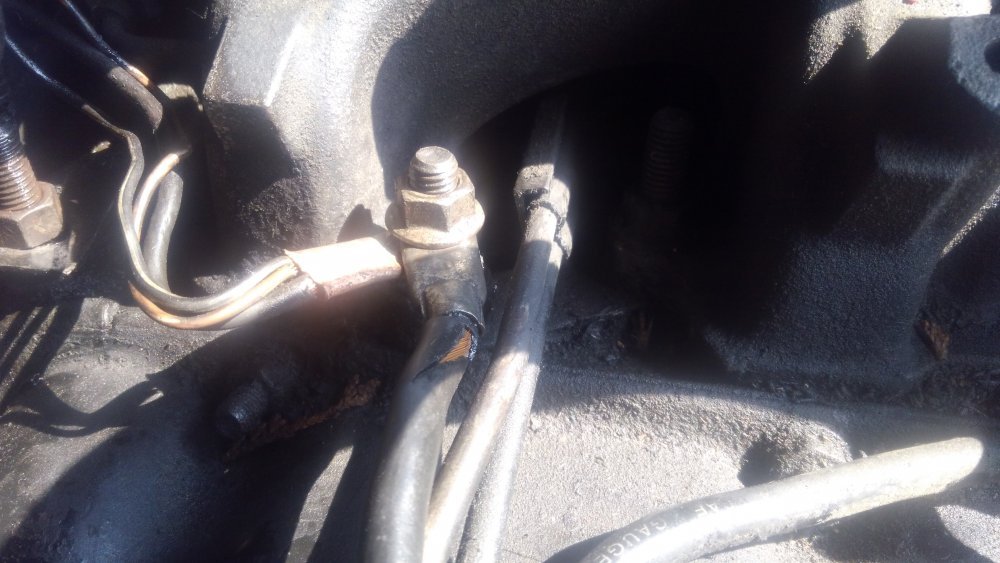

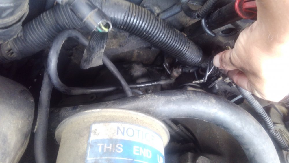

The next thing I noticed was that on the manifold lugs at very back that has all the grounds on it and the dipstick for tranny on it, there's 2 little wires that come out of the wire harness that goes across the fire wall . The are in one eyelet and grounded to the same manifold lugs. Well the eyelet is broke off and the wires are just hanging there . So I gotta fix that. I don't know what those wires go to so don't know if that could be part of the problem or not..

Here's another thing.on passenger side.. there is a ground wire going from the battery to the front manifold lugs closest to battery. On the same lug is a short wire that goes from that lug to the very back one that has all the other stuff on it.. why doesn't the wire go straight from the battery to the back of lug instead of trying to jump the circuit or is that something that some idiot put on here at some point in time
Yes fix the ground wires that broke off the ringlet. That is a a critical spot for the engine running.
But in your first picture, the cable you are pointing at does not even have a lock washer or nut on it. Then it is covered in more grease/oil than wheel bearings have.
Clean all that up, and secure those wires. That big cable with no but is the reason it wouldn’t crank.
There was a nut on it..I took it off cause I was trying to trace it..it goes down into the frame. But not sure where it goes from there..I need to replace it because it's frayed but without knowing where it goes I can't determine how long of a piece I need..
So first off the first picture of the ground wire down to the frame was added by someone. Neither my 96 or 99 has that. The two wires into one eyelet from what you described are the computer grounds. It's recommended that you use the most rearward manifold bolt as opposed to the block off plate bolt because the manifold bolts are dry holes and won't corrode as easily. Those computer grounds are really important to have working right.
Looks like someone added grounds. there should be another ground on the drivers side that goes from the intake stud to the drivers side battery ground lug from factory iirc. the ground in your first pic someone added. it would have normally been a bare flat braided cable from the block to the frame that would only be seen with the inner fender removed. that ground might not exist anymore on yours and that cable is what they replaced it with.

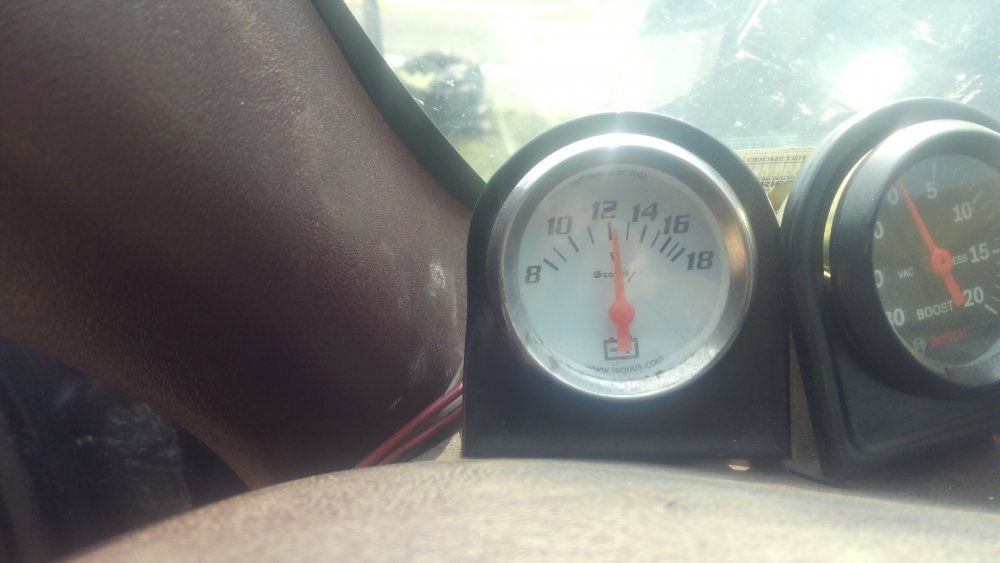

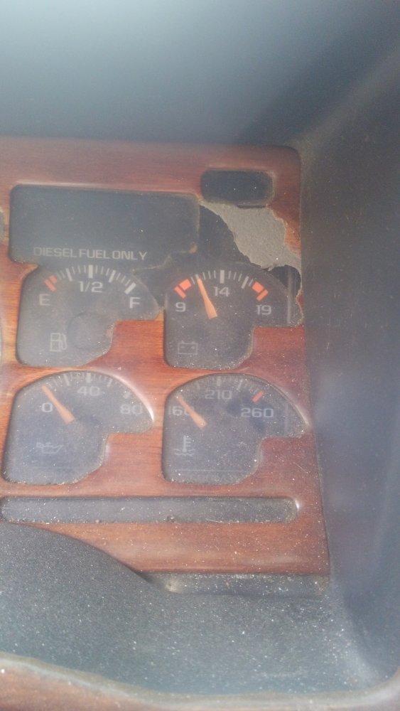

Thanks. I gotta get someone to come try to jump start me. Although we tried that yesterday and it didn't try to start any better than without them hooked up. I'm leaning towards thinking that the starter wore out... Like I said before for a couple of weeks maybe it was the truck was starting hard.. kind of like the starter wasn't getting enough juice or it was going bad.. it would crank over real slow but it would start. Battery gauge it was showing 13 yesterday but it still wouldn't turn over . I would think 13 would be enough to turn it over.. but it turned her really slow and then it just quit turning over at all... And like I said that was with the other diesel truck hooked to it.. had one of their batteries hooked to my battery, and their jumper box on my other battery.. and it still would not turn over
