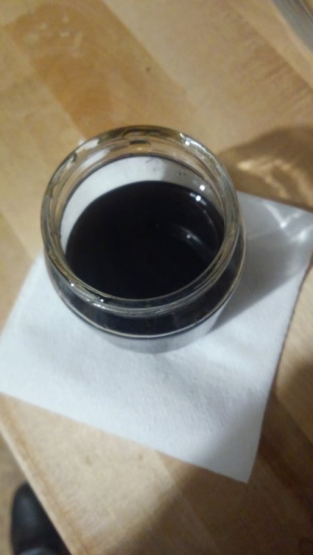

This truck is really throwing me for a loop lately.. that's also the first time I've seen power steering fluid as black as oil

Time for a power steering flush! there is a detailed thread here on how to flush it. only thing I would do different is like what I think Ak did by affixing a gallon jug to the neck on the PS pump essentially making the reservoir larger. run a hose from the return port on the HB into another jug plugging the hose that was there. idle steer, pump, fill, repeat. with fluid that dark I'd get two gallons of fresh fluid, just don't let the pump run dry.

@dbrannon79 I'm gonna have to have y'all walk me through that but doesn't seem to hard... I'll grab ps fluid tomorrow. . I'm thinking I might need to change the hoses from the hb to the pump and gear box.. I know I changed to one of them at one time honestly don't remember why... One of the other ones looks like it's nothing more than a piece of fuel line with some hose clamps on it

I think I'm going to see how much my check is in the morning. Maybe can order brakes and hoses at once and save on shipping..would the bad fluid make the steering feel really loose... It almost feels like when you got a bad ball joint or tie rod end... But I checked them all and they're good as you all know I just replaced them a few months ago... And I just had an alignment done... Napa can probably get me the raybestos.. we do have a Delco dealer here but he's usually expensive as hell.. the calipers I got from RockAuto that y'all helped me out with he wanted $28 more a piece for..

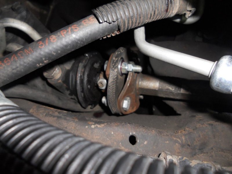

Inspect the "rag joint" at the top of the steering box where the steering wheel shaft attaches. Aftermarket shown, but, the rubber gets sloppy. There is a plastic cover over it from the factory that hooks over a PS line to lock it down.
Do not use anything but oil rated hose on the PS return lines.
I slapped a stick of better multi braid fuel hose onto the return side of the 88 Puick Century, that lasted about 8 months then sprung a leeeek.
It wont be a real big deal if the PS pump does run dry at an idle, just shut off the enjun and fill it back up. It’ll growl some for a while but it will come out of it.
Wifey come home one day and mentioned the steering on the Buick got hard to turn. I go out and check, bone dry so I fill it up, fire it up the I seen that lengths of hose was leeeeking. Asked her when the steering got hard to turn, oh last weeeek. Told Her she better take the toyodah, next thing I know, she is taking off in the Buick again. I thought, okay, screw it, new pump, if she burns it up, she can fix it. She drove it for three more days like that. Finally got the hose replaced with the proper stuff, filled the reservoir, pumped out the air and it all functions just fine. Guess there must have been enough oil floating around in the pump to keep from burning it up. I aint saying that it didnt damage the pump, it shore may have but it is functioning good enough for a rag tag old Buick.
WW is right on the rag joint, they are notorious for causing grief and looseness in the steering. next is the gear box pitman shaft side to side play. mine has been slowly getting sloppier over the last couple months. I have already replaced the idler arm twice, looked at it again and found up down side to side play in it again. as for the rag joint, I pulled one from a salvage yard, cut the rivets off and bolted a new rubber piece in there about a year ago. it also needs to be addressed once more. that rubber doesn't last long
