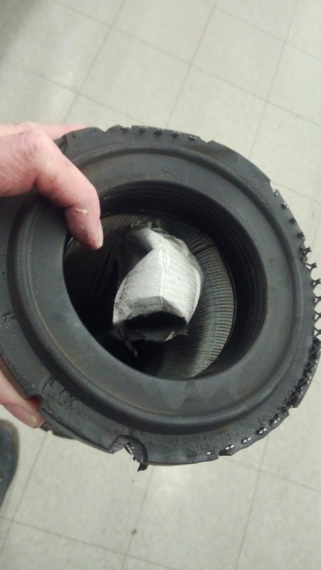

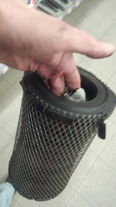

Any of y'all ever seen that happen before...

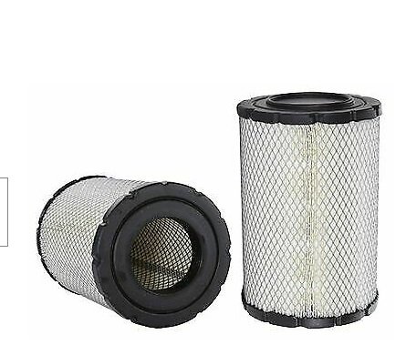

Yes... See if the choices for a "replacement" air filter have the steel media support on the inside. Same metal stuff as the outside "flame arrester" Offhand I believe Wix may have this. They also make a larger High Capacity air filter although that's a tight fit. (Looks like you have the smaller air filter?)
This air filter may be picking up soot from an exhaust leak. It does look like it has some dirt in it. Possible it got wet or snow clogged.
There is a age limit of 1-2 years on some air filters regardless of miles. I found this out when the orange stuff was cracking on an air filter.
Because of "snow" I would recommend a foam wrapped air filter if you can find one. Like this closeout at RA linked below. Note the AcDelco Air filters A1306C appear to have a overwrap as well but are expensive.
The Wix filter and example of the inner support. I hope your filter was defective in design or manufacture and didn't feed the engine the inner support.
I would think if it swallowed the screen it would have made a hell of a racket..the filter was maybe a year old... Yes she has exhaust leaks under the hood on passenger side, but can't seem to be able to get anyone to tackle it.. I don't want to mess with the manifold myself cause no torch's, and if I break the studs I'm pretty much screwed,
Just checked RA on those filters.. honestly there both cheaper then I paid for a new step filter tonight..it was $22.60 .. but had to get one ,I wasn't going to leave that messed up one in there and risk it coming apart and going thru the turbo.. gonna order one from RA Thursday..

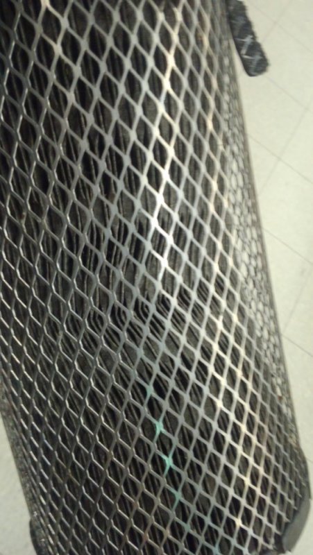

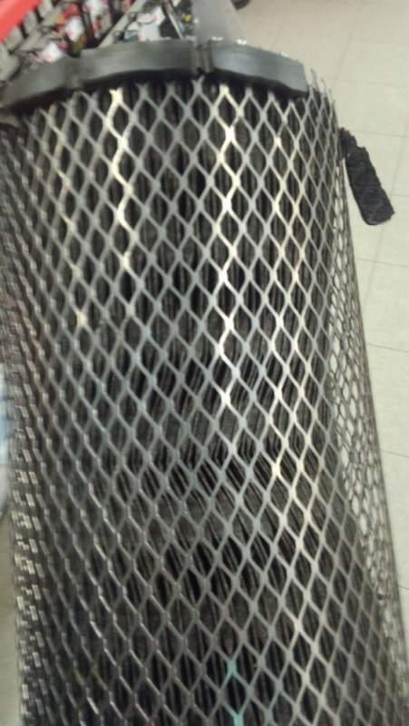

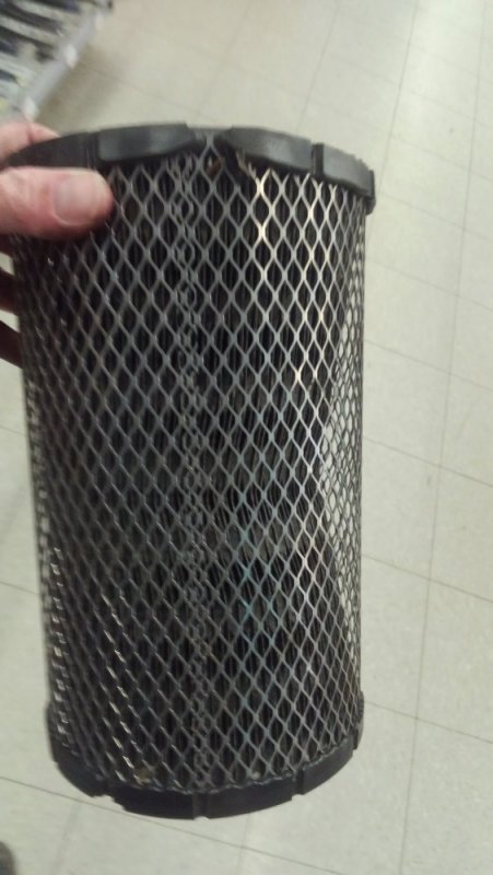

Unless my phone is giving me a different color than yours- I am gonna disagree about how clean/dirty it looks.
That looks dark as can be to me. I think it is plugged full of everything under the sun and completely plugged-causing it to get sucked in and collapse.
I wouldn’t mind seeing a side by side of the old one next to a new one for color comparison.
you can also check the inside of the filter box, it would also be coated with soot if that's the problem. the pgoto you posted didn't look like the outer wire mesh was black, so I'm with Will and WarWagon on this one, ether dirt or it got wet somehow.
