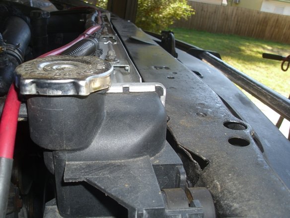

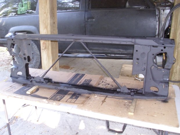

Here is the radiator support modified for the Dodge radiator and the Cummins CAC up front.
The CAC has two studs for the Ram install you can cut them off or slot/drill lower rad support to install the CAC with studs and bushings attached. The diagonals remain in place and the CAC will be flush with front of rad support.

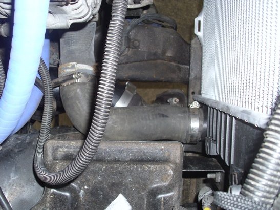

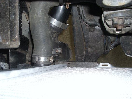

I will take some images of installed radiator.
You will have too splice GM to Cummins radiator hoses.

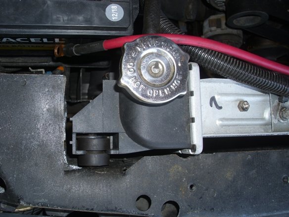

Some images of the Ram Cummins radiator top mounts.
The drivers side battery tray need to be trimmed at inside area of inner fender and the wheel well needs to be hammered very little to allow the battery to move close to the fender and clear the upper radiator outlet and hose. Once you move battery towards inner fender a spacer about 1.25" wide needs to be fabricated to hold the battery from sliding back to the radiator inlet.
Awesome pics! Looks like it fits in there nice and snug. Does the factory shroud fit as well? I will be relocating the batteries to the bed and removing the battery trays, so there will be plenty of room for everything.

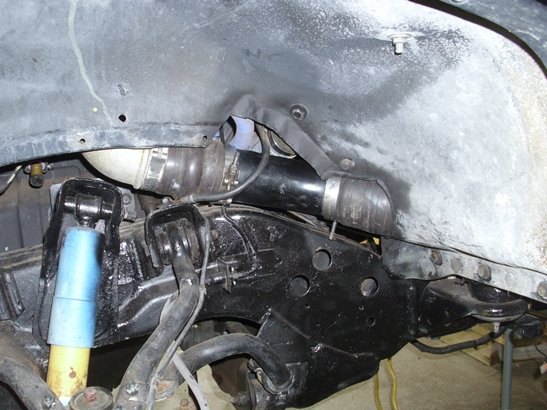

Now that's what I`d be interested in trying. I would like an intercooler but do not want to mess with something hanging under the truck, way to many adventuresome places to bounce over rocks and such over here.
I had one of the first between chassis rails intercoolers that I'm aware of it did take some bumps and light stone impacts but it never leaked not the ideal location but it appeared to be the only option when I did it......

I'm not a fan of mounting an IC that low. I'm sure it works well, I just dont want it to be the target of sustained road gravel fire cruising down the highway. Behind the grill will make it look so much cleaner too.
