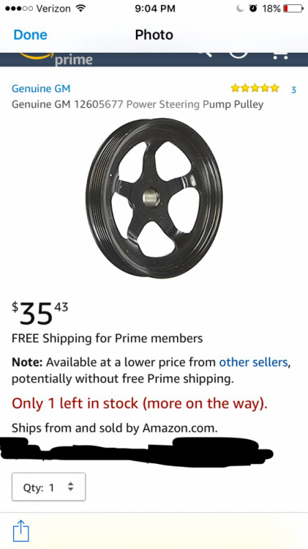

The power steering pulley isn’t a problem, just convince thing, and yeah I am a “while your there” guy so all my suggestions may be better left until in your new home- haha. Some power steering pumps are a pain to access, some not to bad. The spokes make access much nicer. Idk which trucks can run this and which can’t (yes different ones by different years), but amazon takes returns. Just hold in place next to yours and see if the belt is correct depth before removing your old one. This is an old screenshot, so price is probably tad higher.
Some guys (guilty) just mark a drill and hole using annular cutter drill bits in the solid pulley. If I can’t fit this pulley on mine this next go round, out comes my drill.
