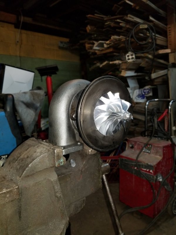

Turbo is a s366 with 6+6 billet wheel with a t3 .82 open scroll housing. Exhaust is nothing special, diamond eye crossover, downpipe modified with a 90 and 3 8nch vband to bolt to the s366 and their 4 inch exhaust without a muffler

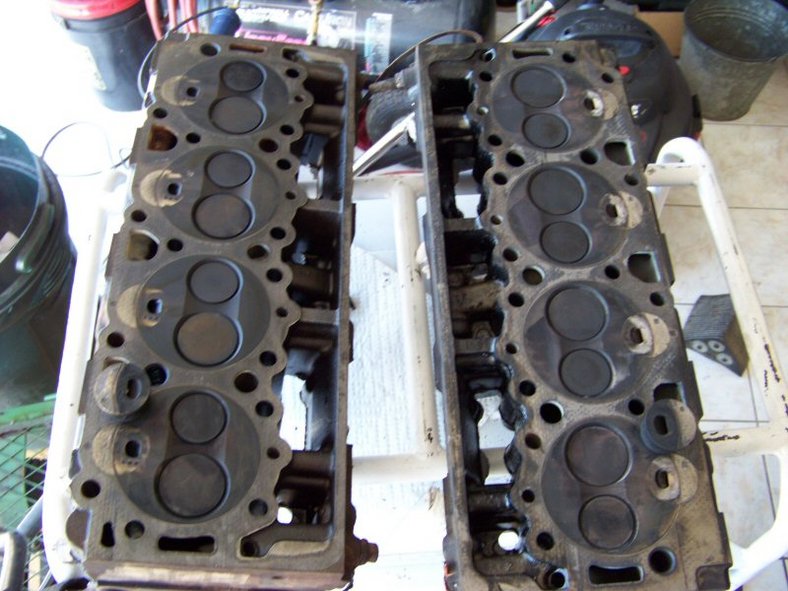

On the left is a head with Military precups on a 1986 6.2, 3 bars. The cups sitting on the head are 1995 turbo precups, round dot. The head on the left is 1995 NA 6.5 precups, square mark. This just scratches the surface of all the precups GM made and the 'opinionated best for turbo' latest Diamond marked ones are not shown.
