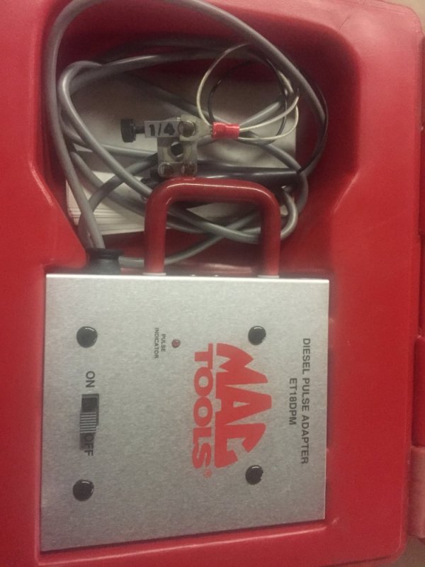

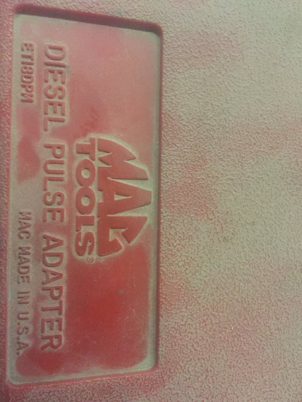

Tools for Db2 are not to different. There is a bar to use instead of prybar for fine pump adjustments, or make your own from 1” flat bar and 2 bolts. Replace your scanner with a paper clip and a diesel pulse adapter. Most people like the snapon that also has the eye that goes in the glowplug hole. I am content with my Mac ET18DPM in the picture that needs any inductive timing light hooked to it. Maybe buy the one of the hundreds of military type ones being auctioned off- I never used one of those, but shouldn’t be to bad.
Instructions very slightly based on tool, but mine is put clamp on injecton line, put ground wire on same injection line. Put timing light pickup (sparkplug wire clamp) on red metal loop. Power up timing light. Start engine and aim timing light at timing tab/ balancer mark just like old school gas engine.
IMPORTANT: turn engine off before adjusting pump. Lock down 1 of 3 nuts and start engine to recheck timing. Repeat 4-5 times when you learn how, then it is usually 2-3 engine starts after that now that you have a better feel for it.
