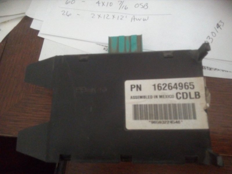

So I think I'll have some time to look at this for a couple of days. Started out by going to a wrecking yard and picking up a Passlock module. So in my reading and searching about this module it handles the EVO, the Passlock, and the Vats. There's an outfit called pro-rebuild that fixes these. Most don't require a core but if you have one that ends in number 65 it's semi rare and appears to be what at least the heavier trucks use. The one I picked up was out of a 2000 CC 1ton so I'm assuming it's the same as mine. After talking to the parts guy at the dealer he seemed to think the different numbers on them were related to 1/2,3/4, or 1 ton. But there's 6 different numbers.

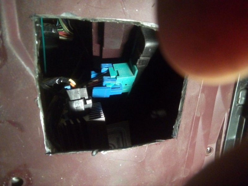

As far as getting to it it's not super easy. It's located underneath either the cubby or CD player kinda on the left side. If you pull the cubby out you can see the tabs that hold it in but that's not the access to it. You have a to pull apart the bottom of the dash and remove the ashtray. At least on gasser's you can also reach up on the left side of it and touch it that way too. The wires don't have much slack in them.
I'm thinking about replacing mine to see if it maybe the communication code I have.IMG_20190409_141900.jpg

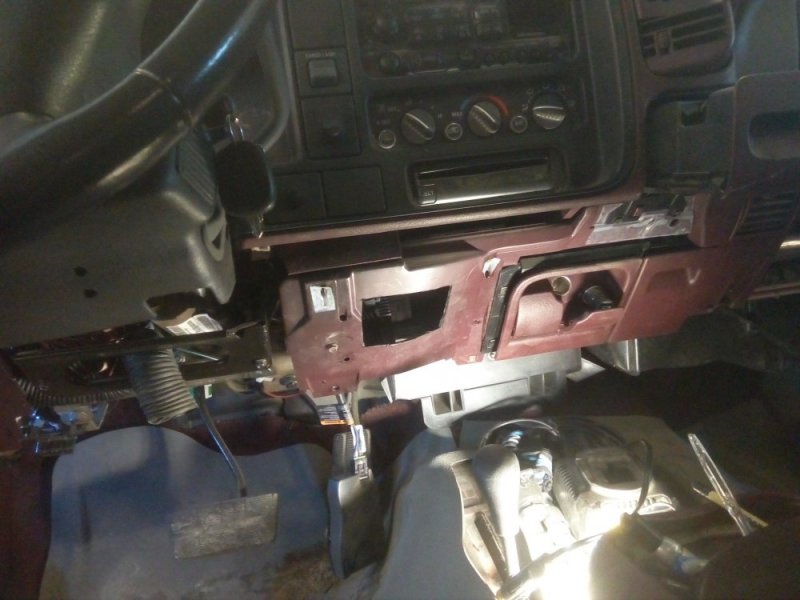

So changed out the module. I made a modification to the dash and now it's relatively easy to get to.IMG_20190410_121033.jpgIMG_20190410_121019.jpg
