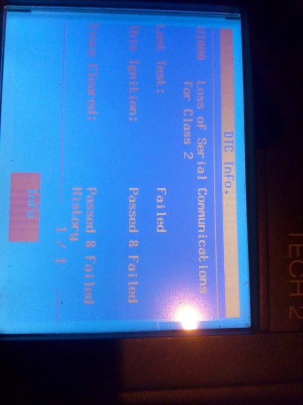

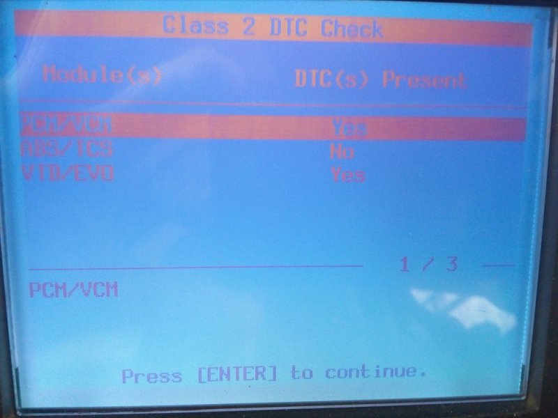

If any module on the bus drops offline, doesn't power up on time, or even if you put the wrong info in when hooking up the tech 2, you can get this. Is your abs and all that working?Cleared codes and this is what came back. Maybe @THEFERMANATOR can tell me how to check which module is not communicating with my tech 2View attachment 56319
DST?Yes ABS is working but I did have a weird braking event a few weeks ago. Other thing I noticed this morning was that my clock time was off. Batteries were getting low from cranking but it did start without jumping.
There is no body control module. Gmt-400's have the hall effect sensor at the lock cylinder, theft module, and then it sends a signal to the ECM to start. If there was a vats issue, it would start and shut off after 2 seconds, not a complete no start normally.the loss of comm is all the time now, clear it and it's right back. Friend of mine helped me check it with my tech2 . All the modules appear to be working but he didn't think they were comm with the pcm. Wondering if the body module not comm with the PCM could be part of my starting issues since it has the passlock in it
