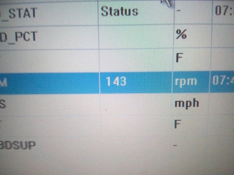

So you are cranking 146 now, and with the higher pops.hmm

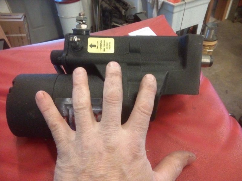

Fit pretty good the only thing I had to modify was the front bracket. The stud seems to be in a slightly different position. I had to elongate the hole and even then it's slightly cocked
Wow. So it’s awesome the problem is gone, but insane it was over a starter.
Yeah, the stud placement is a tad off depending on the bracket. I had 2 brackets both stamped same part number and one needed the hole elongated about 1/8” and the other one worked. But both worked on ac Delco starter. o_O
Also powermaster did an update to the length of the large positive post, the first design needed to be filed a tad on some engines. Did yours?

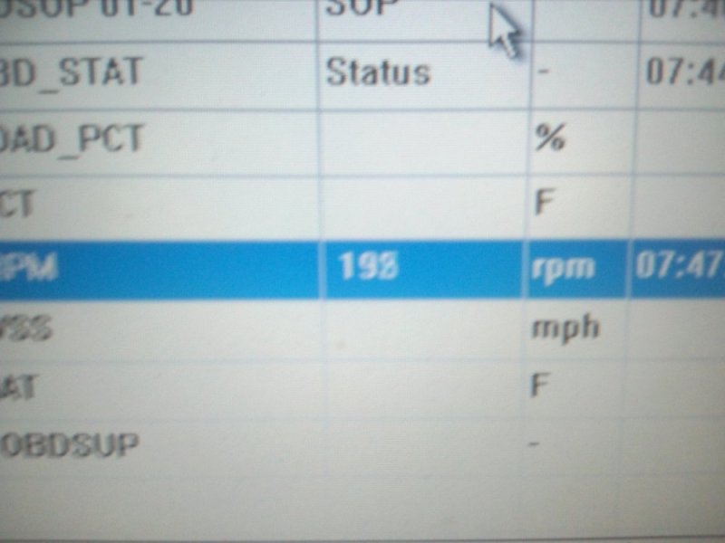

296-136= 160rpm difference...Did I do the math right- a 217% increase?
Didn't have to do anything to the positive post. I'd read about people having to shield the heavy wire coming from the battery but it was fine. Kinda pointed down and towards the passenger tire
I cant remember actual checked rpm differences, more used to the sound. I’m sure at some point I read it on the scanner, ut never tried associating x sound to y speed. Just “that sounds a bit too slow”.
Can anyone else with a scanner cokpare theirs cold to hot and show what their difference is? 1/3 sounds like alot.
I usually unplug the fso not pmd, but can’t imagine that would give a difference in reading or actual speed.
A hot speed difference of one and a half times as fast seems more like what I felt out of my powermaster before- not over twice the speed. But we don’t really know the condition of your old starter here. Could be working but maybe barely or was gonna die at the end of February or if it is still well within spec.
