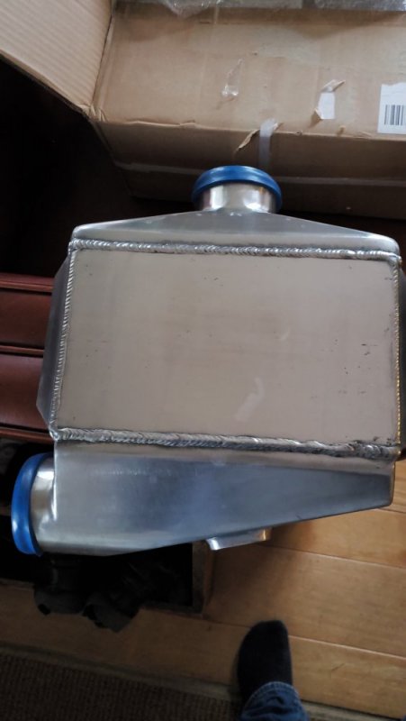

On Hummers, there are currently 2 aftermarket charge air coolers being produced, and 1 ‘factory authorized’ unit.
Both aftermarkets are priced within a few dollars of each other at high enough prices that anyone can have a custom built one for the same price if they do some shopping around.
The only factory unit is only sold with a complete stack from AVA. Almost a year ago I spoke with them about it and some other stuff they have. Almost 6 grand. Fittings, seals, and hardware are extra.
