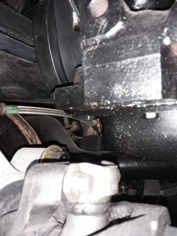

Picked up the cab today off the frame and its all started to come together. My adapter plate was only tagged to the block with 2 bolts and was peeling away at the top. Made it look like I was out of room when it was getting close to right.

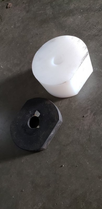

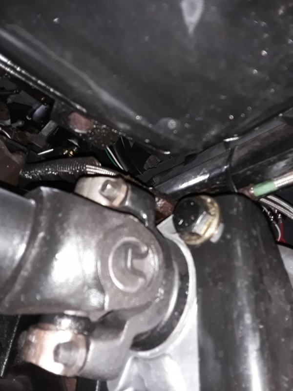

My 97 has a factory 1/2 inch body lift (dont laugh. Its true) to clear the 6.5 TD. I pulled it out and cut my own 1.5"lift pucks to replace. I'm not a fan of lift kits so I'm going minimal. Driveshaft interferes with gas tank so it will need shimming down too. Lift kit in UHMW and original lift next to 1.5 inch lift spacers. Hood will need some blocks too.20181115_142708.jpg20181115_142702.jpg

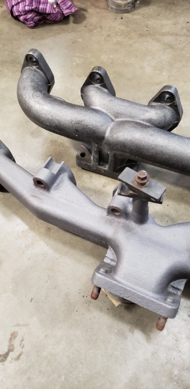

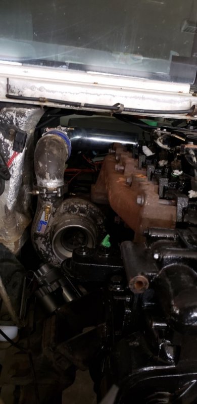

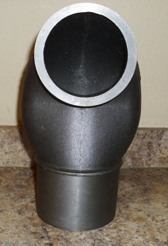

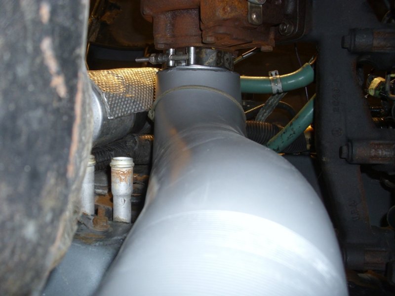

My cummins 12v exhaust manifold has an angle on the turbo side. Makes the turbo hit the cab. I picked up a dorman 24v manifold with a straight down exit to try tomorrow. I'll post some pics then.
Im with you on body lifts on hummers. My 95 is still stock. Rather than lift my body to clear for the factory center mount turbo, I modified the intake crossover. I cant remember if there was anything else I did- I slept too much since then.
Since then I have came to the conclusion a lift of 1” or 2” would be ok. I still dont want to run larger than the stock 37” tires. But clearance for a big boy turbo would be ok.
What are the pucks made out of?
They look like polypropylene (says the guy who works in a plastic injection moulding factory).

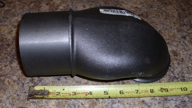

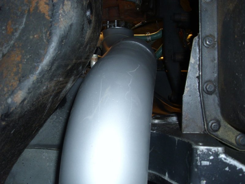

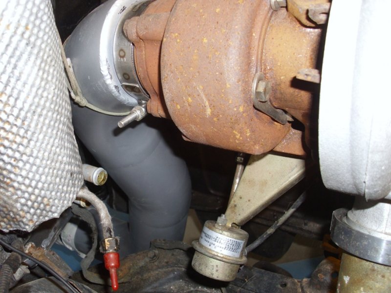

The 1st gen Cummins 2wd downpipe has a even more pronounced bend under the turbine then slightly bends towards the block and down, an 8.3 Cummins cobra-head is about the tightest w/o going custom.

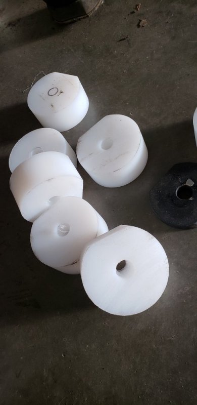

You can buy a lift kit for 600-700usd from several places. Mine cost $4.95. I had to buy a 5/8 drill bit from home depot.
UHMW is the plastic. I had 3" bar of it left over from some lathe project. I put a flat side on it in my table saw and bucked the bar up in my chop saw at 1.5" each. Drilled the 5/8 hole in the middle of each one. I'll grab some longer bolts today.
That's excellent to know. I'm not sure yet how close the full exhaust will be. I'm putting a pacbrake in there too. I'll see today with a proper angle on the manifold.
Best practice is to attach the down pipe to perhaps bellhousing or trans adapter too support the weight of any added items like the pack brake reducing stress & preventing exhaust manifold from cracking or even breaking off.

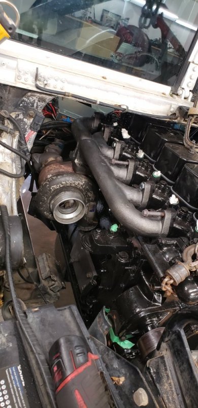

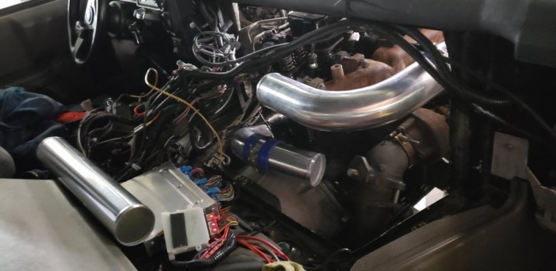

Turbo plumbing taking shape. I'm headed behind the cylinder head to the water/air intercooler which will be about where the stock fuel filter is usually.
