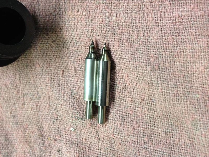

DO NOT use Bosch India nozzles, they are pure junk. I happen to have 2 in my van when I bought it, someone changed injectors, 6 are OE's and not a mark, 2 are India's and look like shit.
I have a pic on my work computer, can load it later or look on thedieselplace.
Having the set balanced within 25-50 lbs compared to 200 (which is what most will be) is noticeable just driving. The Indians aren't "bad" just not as balanced.
The other thing is average pop pressure is usually around 150 lbs lower on the Indians. That means not as fin a mist . Still good and useable, just not the premium. If you take the Indian set in (or do it yourself) you can bump the pressure and balance them as equal as possible and get incredible results from either set. The Germans are more pricey, but already fine tuned for you.

Ah, the sad part. No where I can find anymore. The best option now? idk. And I don't want to discredit The master of the van world , I am starting to agree with him more and more on the indian made Bosch. No longevity compared to the German made Bosch. The ones from summit and heath are indian, I called back summit just now to verify they still can not get Germans, I called them and wrote a request over a year ago. I don't think Germans are made anymore.
