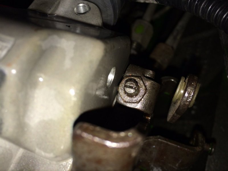

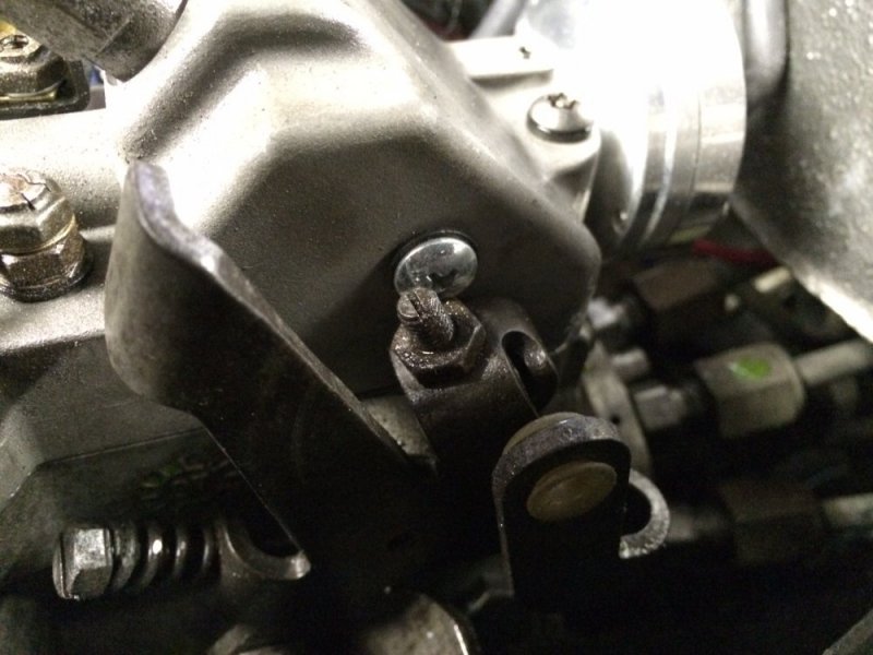

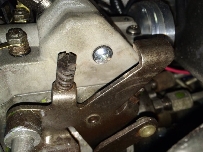

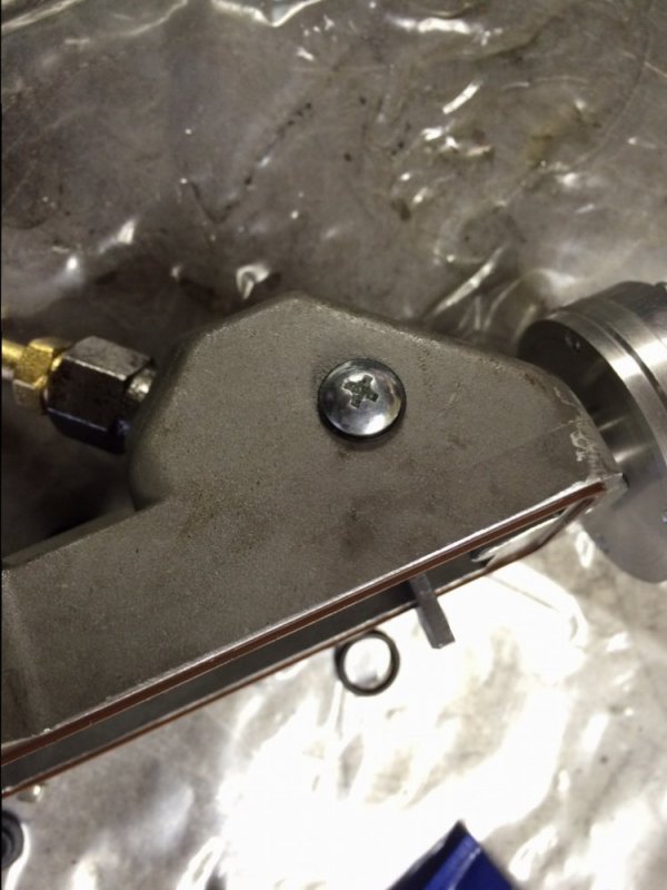

So interestingly, while I was talking to Joel about some other stuff he said, "Something else I just remembered that I wanted to mention. The puff limiter is designed for the Ford DB2. We have used them on GM applications with one note. The cold start solenoid terminal connector will foul your throttle shaft. This will leave you with two options: Delete the cold start solenoid and just use a nut and bolt with the supplied insulator to block it off. With the extra fuel provided I think you will warm up sufficiently without the extra advance. If you go this route be sure to use lock tite on the hardware to prevent it vibrating loose. The other option would be to cut the end off of the cold start solenoid terminal and shorten your attachments accordingly and perhaps clearance the throttle shaft slightly to make room."

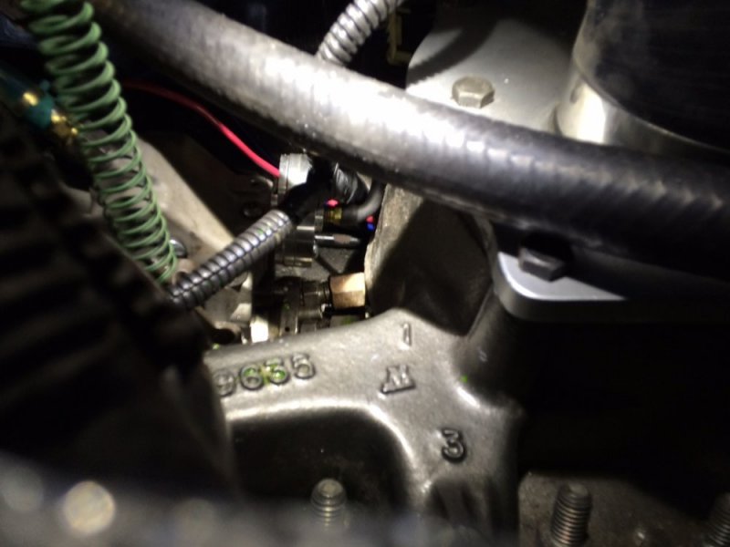

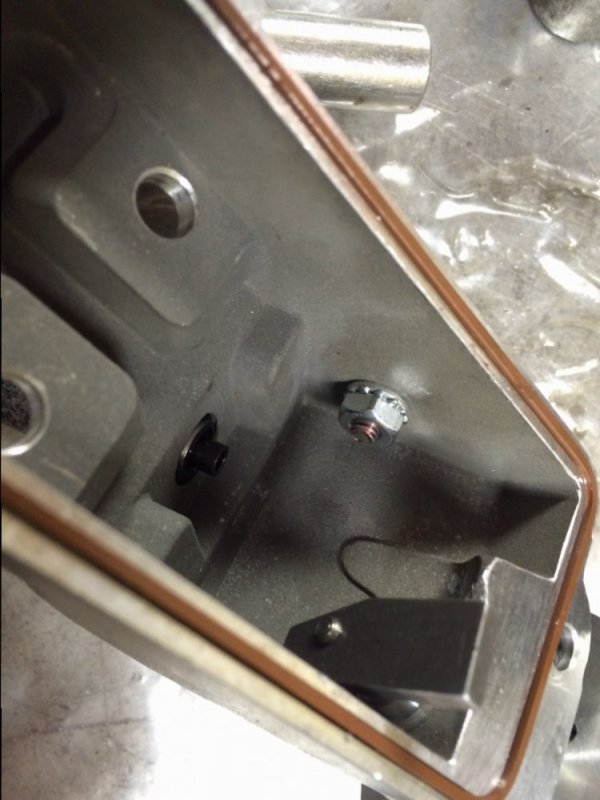

I'm glad he mentioned that because I definitely had clearance issues between the cold advance solenoid and the throttle arm. It would be super tough to make it clear the throttle arm so I went with the deletion route. I installed a Phillips head screw with the head facing out to try to gain as much clearance as possible. I also installed Red Loctite on the threads so that nut will NOT come off. During test fit I found that the arm was still rubbing the screw head so I used a dremel to grind some clearance into the head. Even then I had to bend the throttle arm away from the pump to get final clearance! Getting that taken care of took a bit of time. Then I started looking at the clearance of the aneroid to the intake and the barb was pretty tight to the plenum. It's a super small thread on that (1/16" NPT?) so there was no way I was finding an elbow last night. So I trimmed the end of the fitting just past the barb. Unfortunately I only got a "before" pic and not an "after" pic, but I think you can picture what I did. That gained me about 1/8". It's a tight fit but it doesn't kink and since the hose is under pressure and not vacuum that will help keep the hose open.

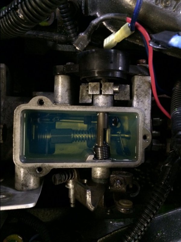

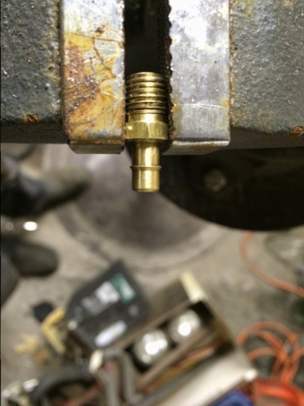

I had to take the intercooler, AC compressor, coolant crossover and fast idle solenoid off to get access to the pump, so in all the job took about 2.5 hours to complete. I neglected to do the initial setup that Hypermax recommends which is: turn the aneroid in until it starts lowering idle, then back it out 1 turn.
So despite that, here are my initial impressions: I can still make a pretty good cloud if I tromp on it before boost comes on. However just going up hills in a high gear it is much more civilized. Also, it has turned the throttle into a much more linear progression. Before, not much off idle I could really pull strong, now I have to give it more throttle to feel that. That makes sense to me since the puff limiter holds back the fuel valve until boost is up. I did another 0-70-ish run just going around the block. This time I had my brother and a more or less full tank of fuel in the truck, so about 400 pounds more? My butt dyno said it was slower, but that's just my butt dyno. I'll do some actual testing to see how it really compares once I have it fully set. If it operates how designed, it should not affect overall performance, in fact if anything it should improve it because it doesn't flood the engine with fuel at the initial hit of the throttle. I am going to email Joel and get his thoughts on the travel of the aneroid versus how much the governor arm travels and make sure that it couldn't actually restrict overall travel. That's just a side note, I have no verification at all that it actually is slower, it was one hit with more weight based on a butt dyno!

So far I've only done a little tuning with the aneroid. Per the Hypermax instructions I started screwing the aneroid in until it affected idle - that was about 3-3/4 turns. Then I turned it out 1 turn as a starting point. It made no smoke at take off, but man was it a dog!!! It wouldn't get above 7psi and I don't know if the truck has ever been that slow, even stock. So then I turned it out 1 more turn, so it was 2 turns out. It was better, but would still only make about 14psi of boost. I couldn't believe how much it was affecting the truck! This time it made a little smoke but I definitely wasn't getting full fuel. THEN as I was starting to turn around to go back home I realized that I had disconnected the hose connecting the aneroid to the intake to make the turning of the diaphragm easier and I had forgotten to hook it up! So it was never getting the signal to release! I hooked the hose back up and tried some more runs. It was smokier than I'd like at part throttle, but full throttle fueling seemed like it was back to normal. So I backed it down to 1-1/2 turns out. This time it was a little less smoky at part throttle, but it did seem to be affecting full throttle fueling a little by my butt dyno. So for right now I have it back at the 2 turn setting. I really think to optimize this thing and make it work the way I want I am going to have to play with the boost set point that the aneroid starts activating, and I will have to do that with a manual boost controller. I'm hoping to be able to reach a point where full throttle fueling isn't affected, but my part throttle fueling is cleaner - too many times I'm dumping black smoke when driving through town in a "spirited fashion". It would have been nice to have purchased the pump with the aneroid already installed so Joel could have found the point at which it didn't affect full fueling - that way I would have a point that I knew I would be ok and under that I would not.
