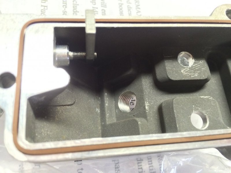

I received the Puff Limiter today and should be installing it Monday night. I took some pics but I thought a video might be more helpful so I did that too. Sorry about my lack of knowledge regarding the inner workings of a DB2, but it shouldn't be too difficult to figure out once the lid is off.

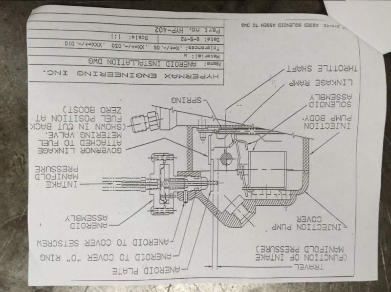

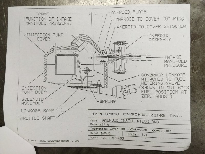

Without knowledge of the internal workings of a DB2, I can't really say how it works. What it does in practice though is mechanically govern the fuel delivery of the pump until a pre-determined boost level is reached, at which time it allows fueling to resume normally. I really need to watch that video Dennis shared on Facebook to try to understand how the pump really works.
I just looked again at the drawing they provided and it looks like it's holding back the "Governor Linkage Attached to Fuel Metering Valve" before sufficient boost is applied. So I guess it holds the Fuel Metering Valve in a more closed position until the diaphragm releases it?
Thats what it looks like. Wish I knew more about the internals also. I assume the throttle pedal is a separate fueling but the puff elim holds back the gov till boost lets it go.
