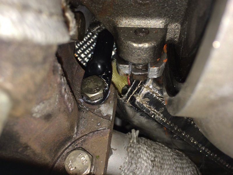

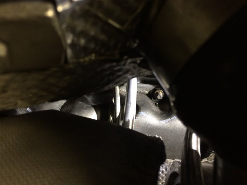

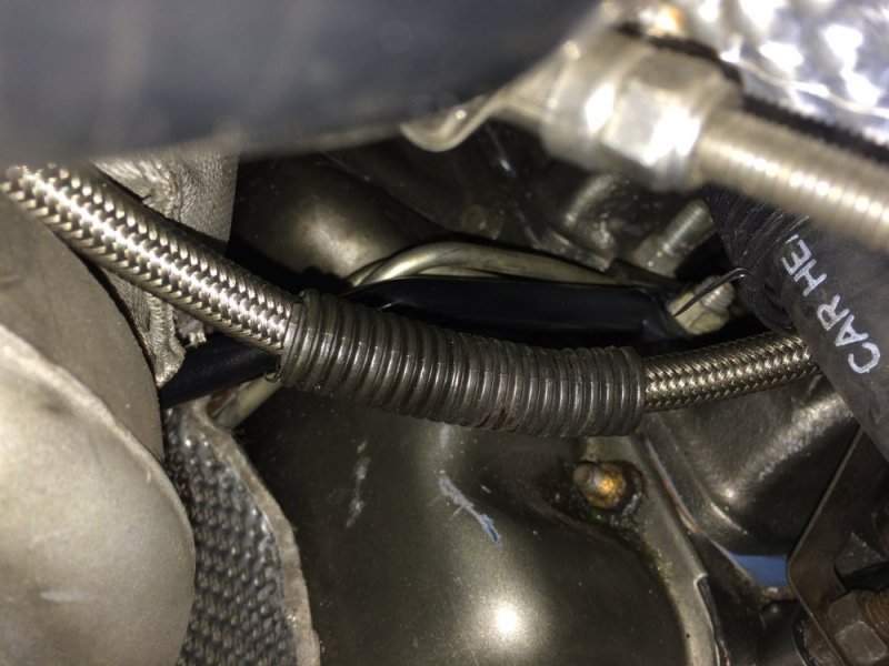

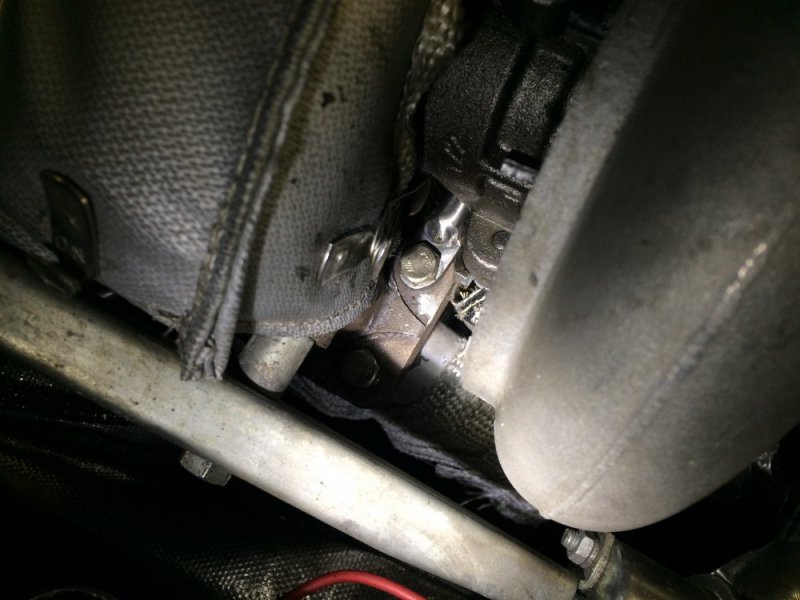

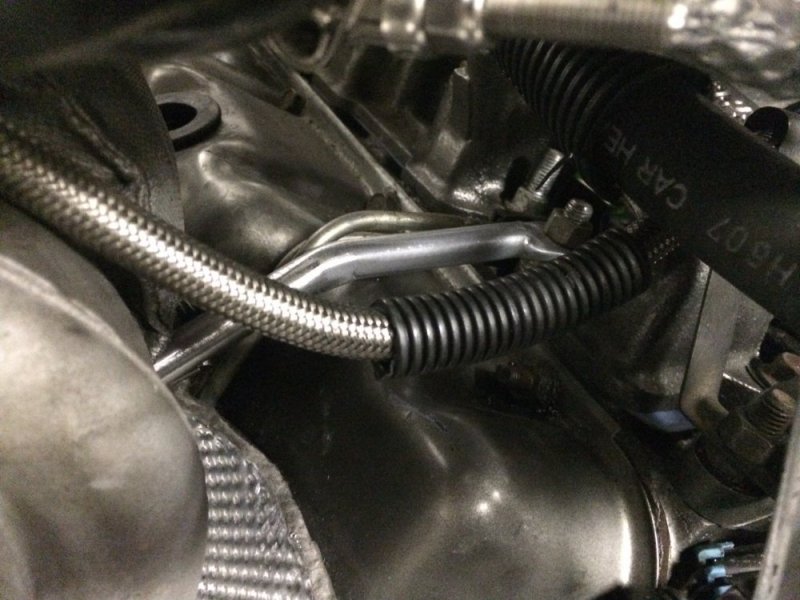

Are you going to put your Star Wars wrap on line from FFM to IP?
Maybe just for you, Leroy. It is braided stainless though so it's already shiny in its own right - though that probably doesn't block heat much. Star Wars wrap....I like it!
That a genius idea for the bolts. I was so sure with my luck I would have lost a bolt when I did my IP. luckily not but wishing I had thought of this myself. Can't wait too this all done up and running again.
Thanks SS! Yeah when I did the pump last time, the thought of dropping a bolt kept me up at night until I thought of this idea.

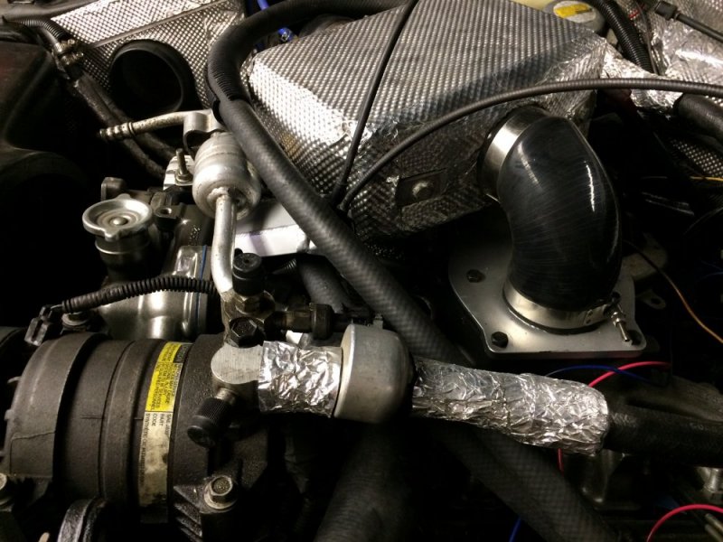

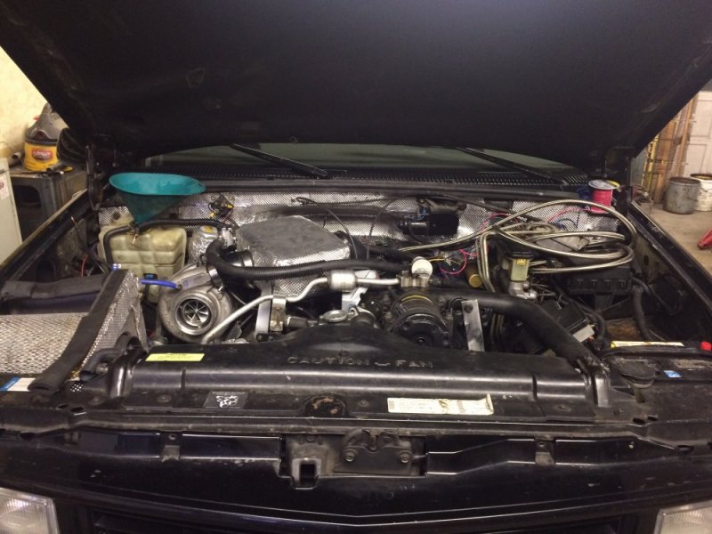

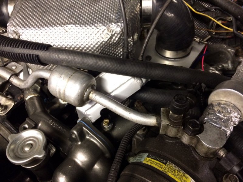

Done for today. It's basically back together mechanically. Everything pretty much fit the way it was supposed to, but the fuel return line did need some adjusting to fit around the crossover on the driver's side. I also need to do some finessing of the intercooler lines around the throttle cables. Tomorrow will be cables/pedal, fuel system and electrical.

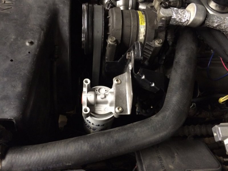

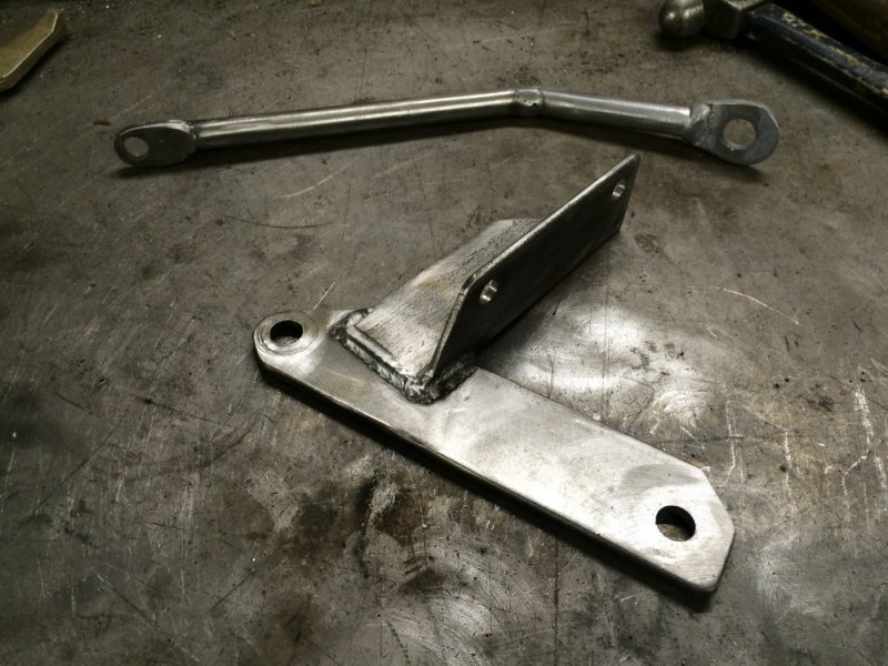

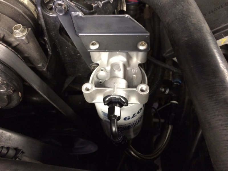

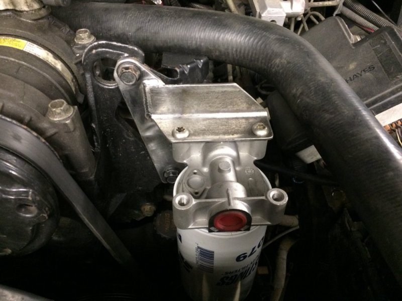

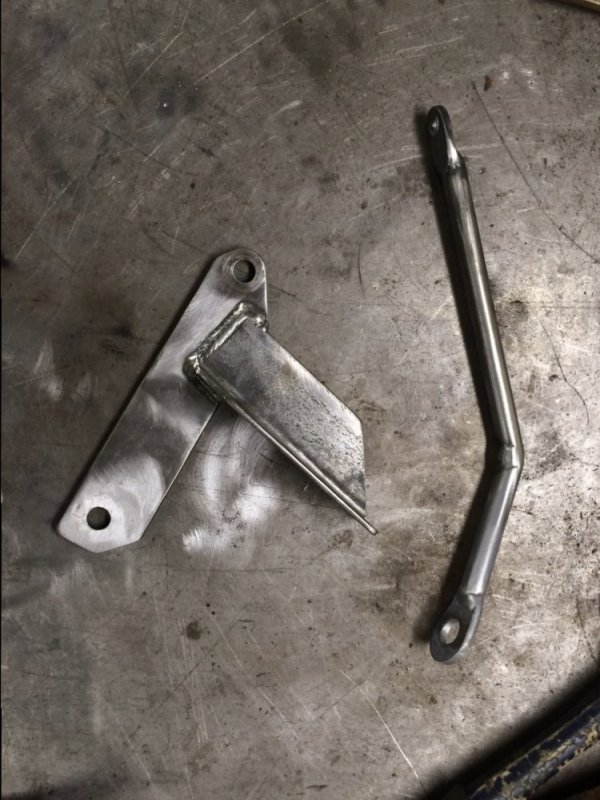

Bracket updates are done. I made a bracket for mounting the Baldwin filter base and the new header/turbo brace. I cut the intake end off the old brace and made a new end to attach to the header flange. Then I welded them together at the appropriate angle. If something there breaks....then I have some REAL problems. Time to start doing cables.....

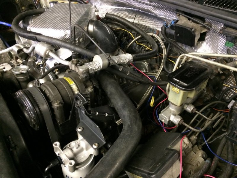

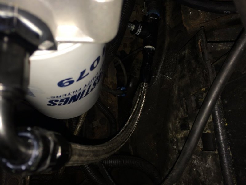

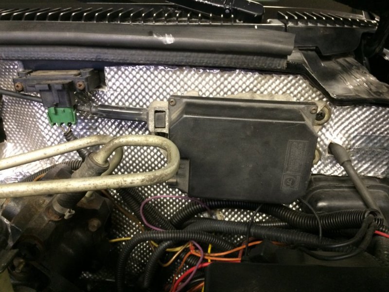

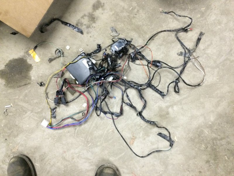

Fuel system upgrades are done minus the gauge. The turbo brace is also installed. Still lots of tidying up to do, but that will happen once wiring is done. I have the nonfunctioning remote start out - that was a fun chore, NOT. The pedal install was super easy. I expected there to be a knock out plug in the firewall but it was just a soft plug! The hardest part there was trimming my firewall insulation so I could get the plug out. I also got the cruise module mounted. The factory screws for a gasser are self tapping so it made the install for that super easy too. Gonna eat some lunch now and then it's on to wiring. Lots of wiring....:(

I noticed you have a scratch on your valve cover. Are you going to fix that? Judges will deduct points you know.
Ha! I was just thinking that.
What is your source for your SS lines and AN fittings? I'd really like to start using that.
Summit Racing. Most of it was their house brand, but a couple pieces were either not offered by them or out of stock, so there is some Russell and some Aeroquip in here too. It was my first time doing AN fittings and it really wasn't too bad.

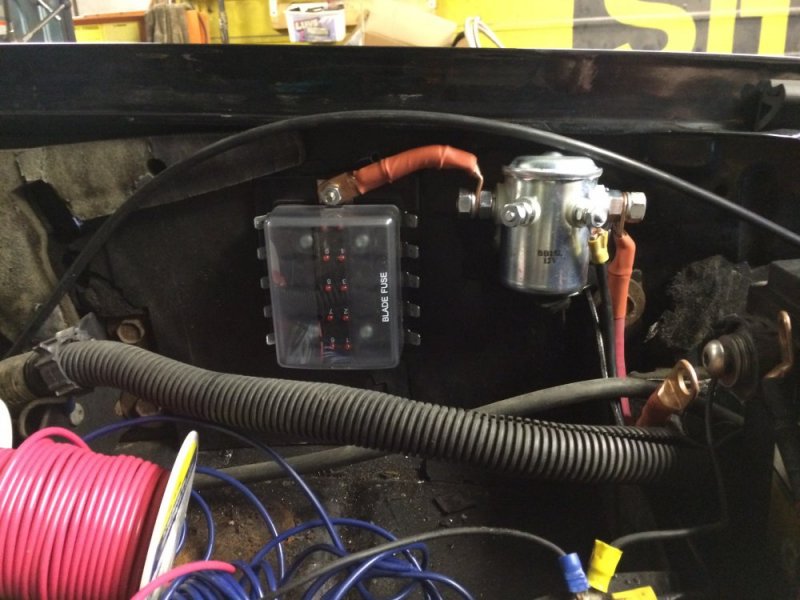

After that I started working on other electrical upgrades. I got tired of never having a good keyed 12V power supply available so I am adding a fused distribution block running off a relay so I'll always have an easy way to add switched & fused power when I want it. I'm going to add a second distribution block under the dash running off the same relay. The relay is rated at 150 amps continuous, so it won't be a problem.
