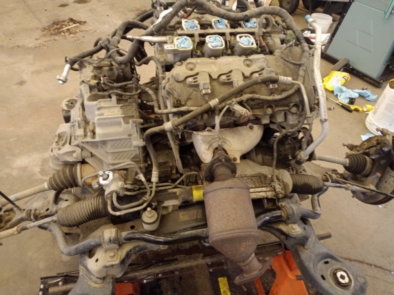

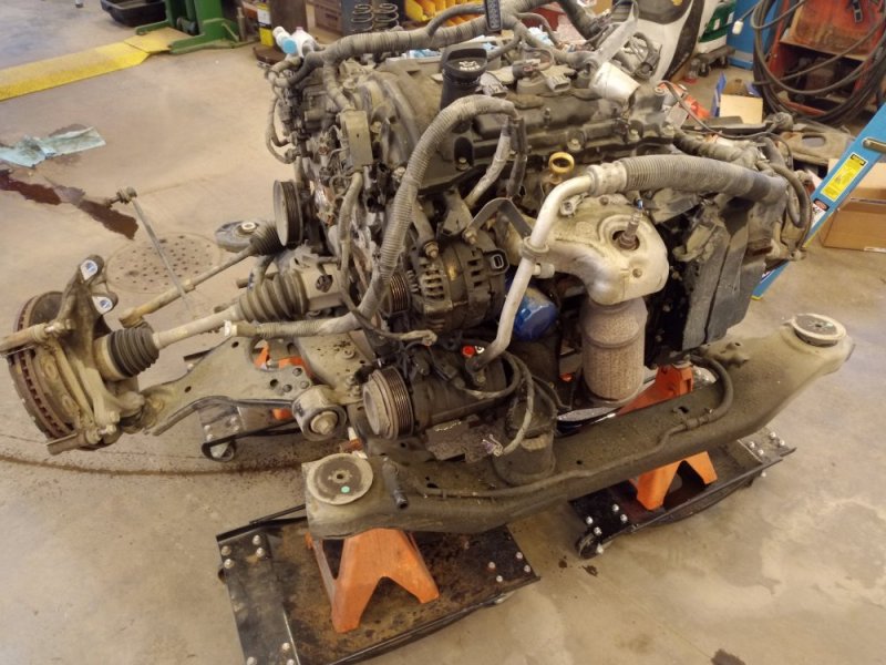

So after many delays and vasillating back and forth between doing this in the car or dropping the subframe assembly. I finally dropped the subframe. This is a first for me I've never dropped one before.
I think I have a couple of days I can put towards it, barring any unforeseen things coming up. So hopefully I can get it back in pretty soon.
Fun experience? I know the "cheat" for pulling the engine on Camry's instead of dropping the subframe like in the manual, is to remove everything from the front of the engine (accessories, pulleys, brackets, etc), disconnecting all wiring harnesses, fuel lines, accelerator & cruise cables, exhaust down pipe, unbolting the torque converter from the flex plate and the block from the transaxle, pulling the motor mounts, then sliding the motor over an inch or so to clear the locating dowels and lifting it out with the front clearing the inner fender by about an inch.
It saves about 5 hours on the R&R and the hassle of raising the vehicle up on a lift and having a cradle jack to lower the subframe down to the floor and then still having to separate the engine from the transaxle to work on/swap out.

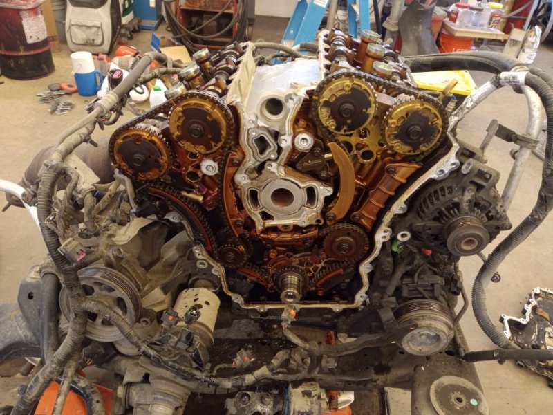

Well I pulled off the timing cover and things actually looked pretty goodIMG_20211117_114605_520.jpg

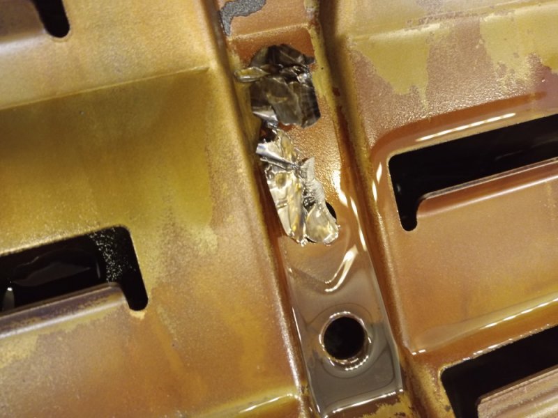

So I figured I'd better pull the pan and I found a big piece of metal.
So I started checking the rod bearings and one of the middle ones is loose. So I guess it's rebuild time.

You were smart to drop the whole engine and trans assembly out like that. Makes it alot easier to work on them. I see alot of guys think that its faster to "cheat" an engine out. In my experience that's just not the case. I can have most subframes dropped with the engine and trans in about 2 hours. If you have a lift to work on then its really the best option for most vehicles out there.
Yeah, if you have a shop with a lift. Not that many people out there with a home garage with a two-post or four post lift in it and a cradle jack to lower out the subframe for that once in a great while procedure. Again, for a home DIY'er with a cherry picker and not the ability to get a vehicle 6' up in the air, nor the bucks to take it to a mechanic, the "short cut" is the way to go.
