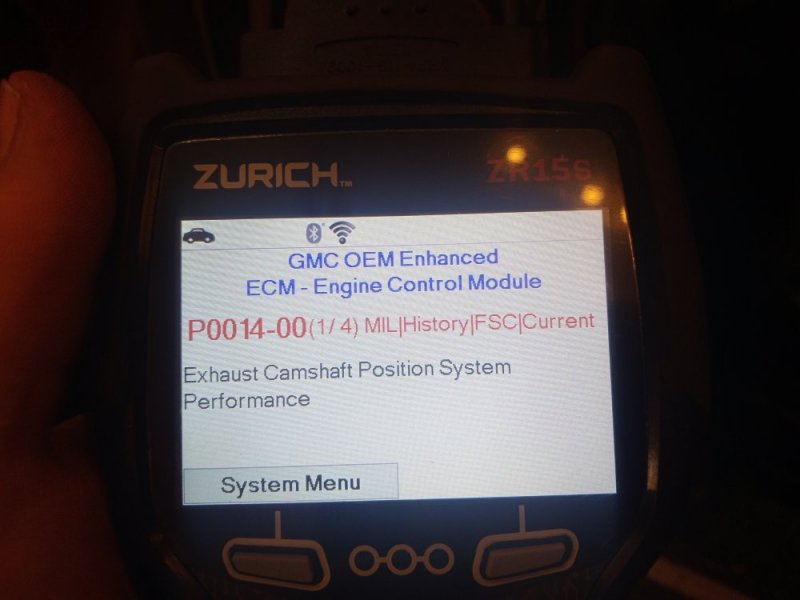

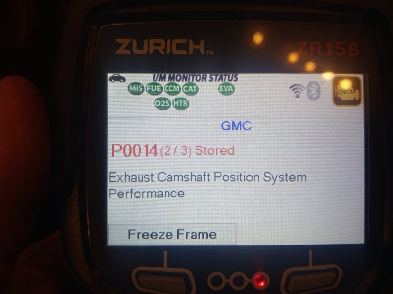

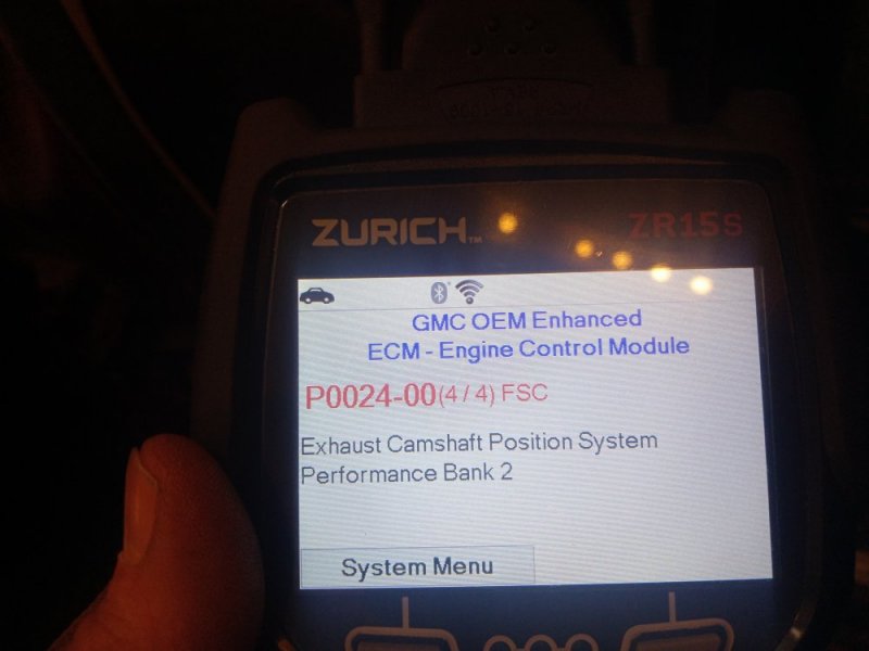

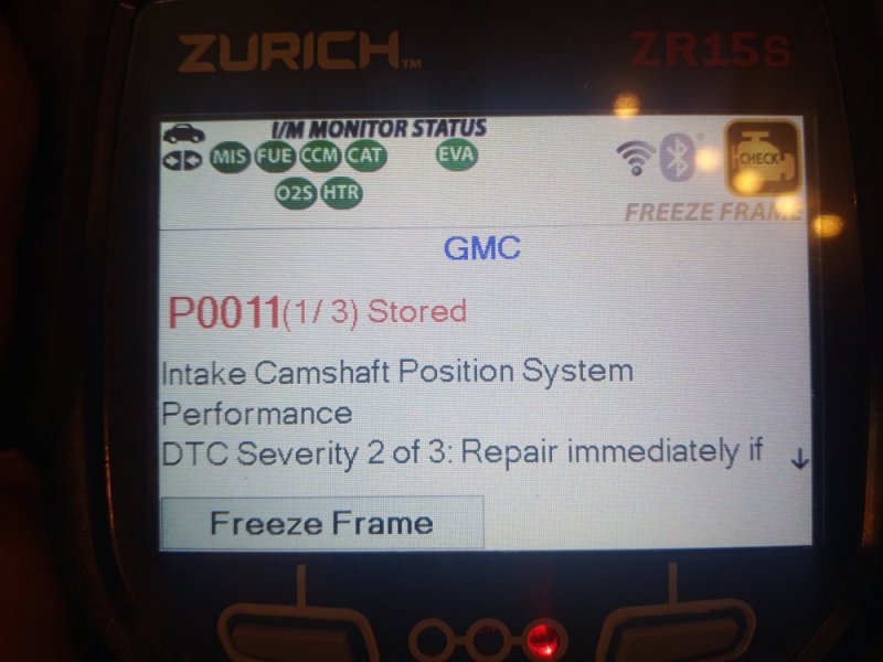

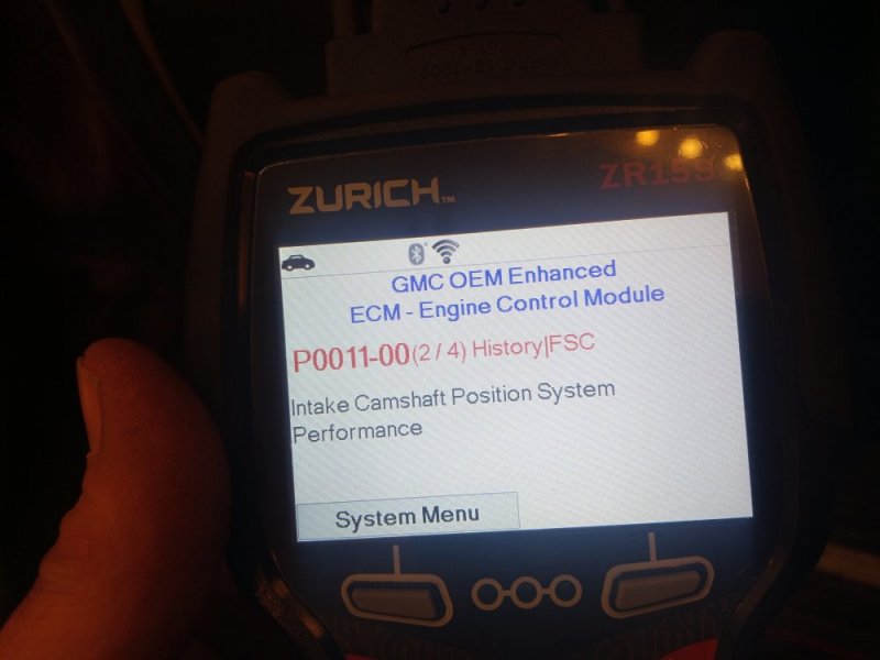

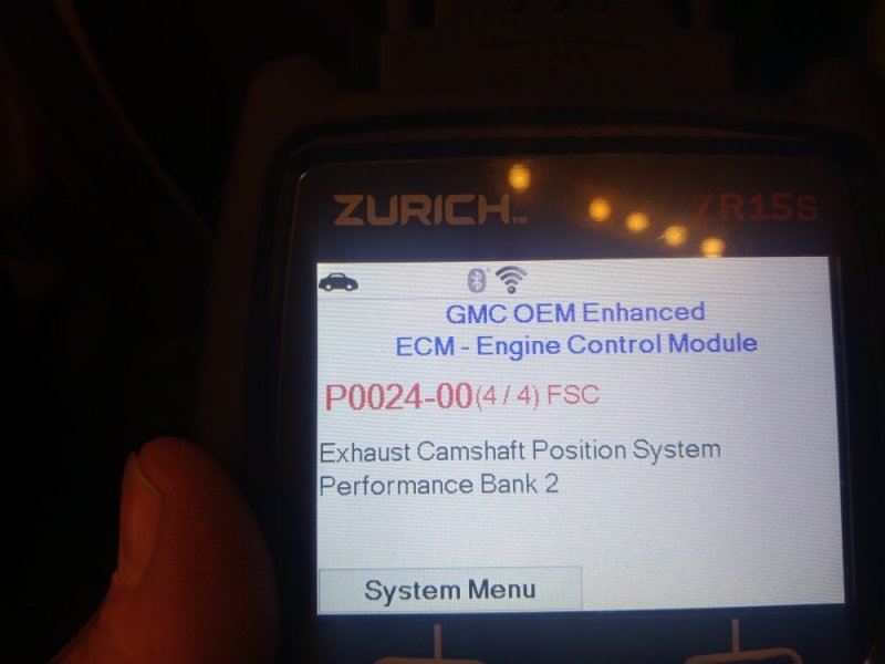

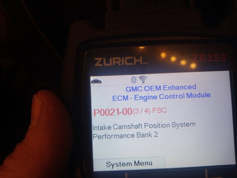

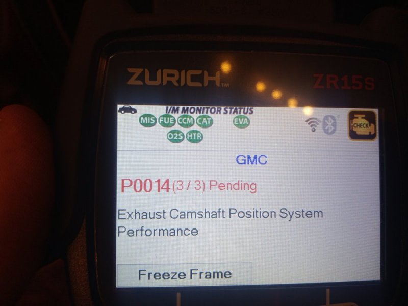

The 3.6 has 4 cam sensors and 4 VVT solenoids to control cam timing. Cam codes can set due to a bad solenoid, stuck VVT, Plugged oil passage, or low oil pressure. They can "Knock" if the conditions are right.
I would confirm oil pressure first. If that's good pull the valve covers and timing cover to inspect the timing chain tensioners. They are common to fail and cause the chain to loosen up and make noise.
Also running ATF in these for a few hours is a great way to clean out the oil passages.

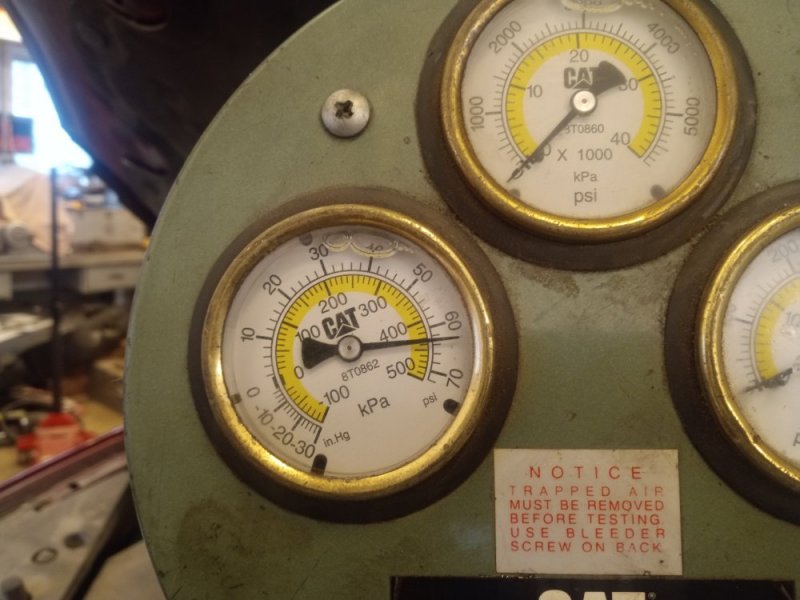

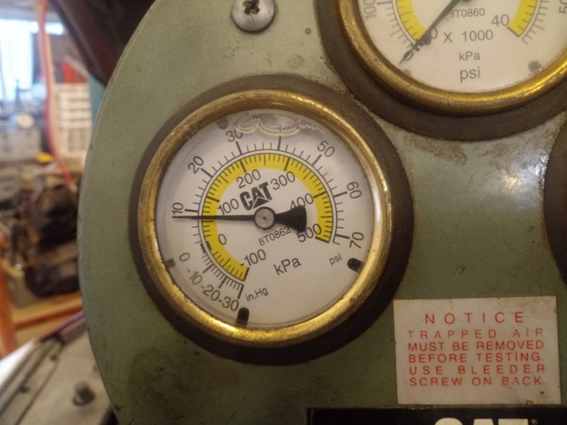

Oil pressure cold and hot and then the codes. When it's all the way warmed up it has a pretty good knock, but I still don't think it sounds like a bottom end knock. Plus that was 5w20 oil (which is what I had) and it's supposed to have 5w30
Don't know what the OP specs are supposed to be for that motor, but your trouble codes definitely show there's something up with the valve timing, both intake and exhaust, with the beast. Very well could be a VVT actuator issue of a chain/guides issue, any/all of which are most likely related to the 'sludge in the filter, when was the oil last changed?' issue.
10psi is minimum oil specs on a 3.6. Looks like your a little on the low side but your running 5w20 so that might be why.
All 4 cams are throwing codes for position so I doubt it's an actuator issue. Its more than likely out of time mechanically. Can you read VVT data? That can be helpful to narrow it down. If its out of time constantly then I'd say it's a chain issue. If its fluctuations in and out then it might be a oil pressure issue on the upper end of the engine. The VVT system needs proper oil pressure to function properly. The Ford triton engines would knock like a SOB if you got the VVT to stick.
