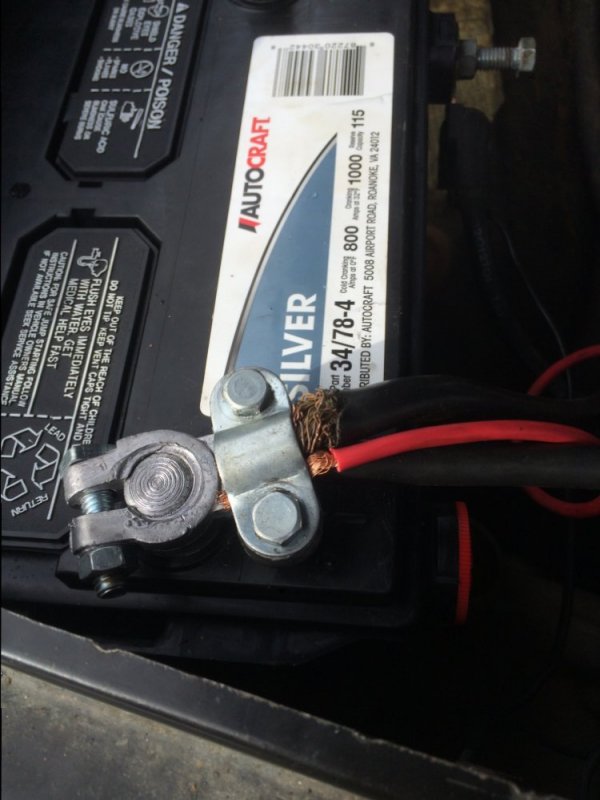

This is the mess the PO left me with, starter cable, battery crossover cable and alternator wire join together on the top post, just looks poor to me and wondering how to go about fixing it. I replaced the battery ground on the drivers side battery with 2 gauge cable because it was the worst of the cables, no difference.

Batteries died/frozen from no charging? That's an awfully small charge wire to the alt if it's the red one. Be careful with frozen batteries as they can explode. Take them inside to warm up for at least 12 hours. Or exchange them is safer.
Batteries are less than a week old, 800CCA. I brought them inside and trickle charged them both, no change. Interesting thing I've noticed is that when hooking up the batteries, I don't get any sparking at the terminals which I think is unusual. Does that mean anything?

I'm going to disagree with warwagon, replace those cables AND the starter. That hacked up crap needs to go. If the truck did run and start right, the alternator won't be ale to keep the batts up, and you might get free smoke from the alt at the same time.
You've heard sometimes you have to spend $ to make$?
Well sometimes you have to spend $ to keep from spending boatloads of $.
You just need to put those cables into ring connectors, one for each cable.
Replace the one that is insufficient.
Either crimp them or solder them or tin the end and crimp them.
Then get a terminal that can accept ring connector like the marine battery terminal for top post and get brass side post terminal and split them up.
Get at least a 2 gauge wire from battery to alt.
The one going to the fuse box can be replaced with a part store cable (4 gauge).
I am surprised you changed the batteries and did not see that?

Fix or replace the cables, kinda unfair of me to say that off the 1 pic. I just like to fix things and move on with no future wondering of "could the cables be messing up again?".

His sig says it's an 84, so a 10 gauge wire is all GM put in from the factory. That truck only used a GM 10 or 12 SI alternator capable of a whopping 63 amps in stock form, and only about 25 at idle.
Thanks for the info Ferm, I didn't know that. I went ahead and bought a 4 gauge cable to replace it anyway though. I'm checking all the parts stores in town for a starter and it seems like they only carry the gear reduction starter, mine is most likely a DD and would need a different bracket if I used the GR starter. I did notice the bracket is installed on my truck, but it and the wiring looks like it won't be easy to get to with the axle and all in my way. I'll get it done though, it's in the 50's today so now's my chance.
