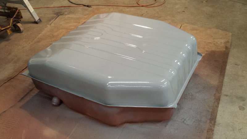

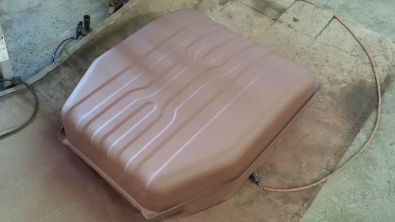

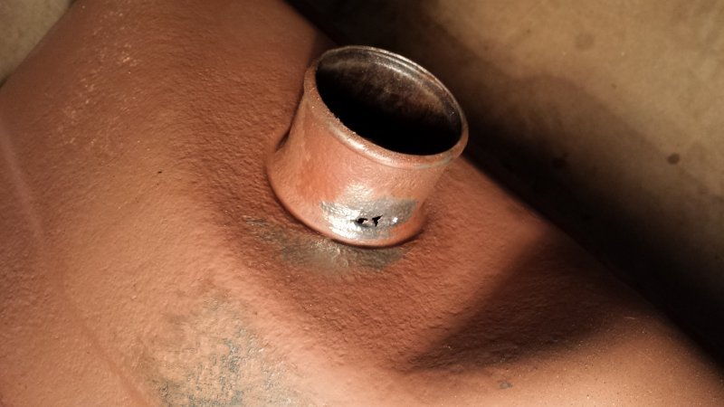

Yah, I think I will order NiCopp for brake lines and stainless for fuel. Probably should have just ordered a new steel tank. spend about 3 hours tonight welding around the filler neck, building up metal. didn't realize it was as thin as it was...

Nice paint work! I didn't even have any holes in mine but saw where the PO had patched it. I just didn't feel like crawling around in the mud under that rig again if I could avoid it. The Dorman replacement that I got for my pickup felt really well made and I am glad I put it up there.

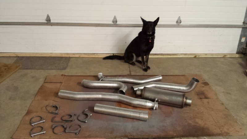

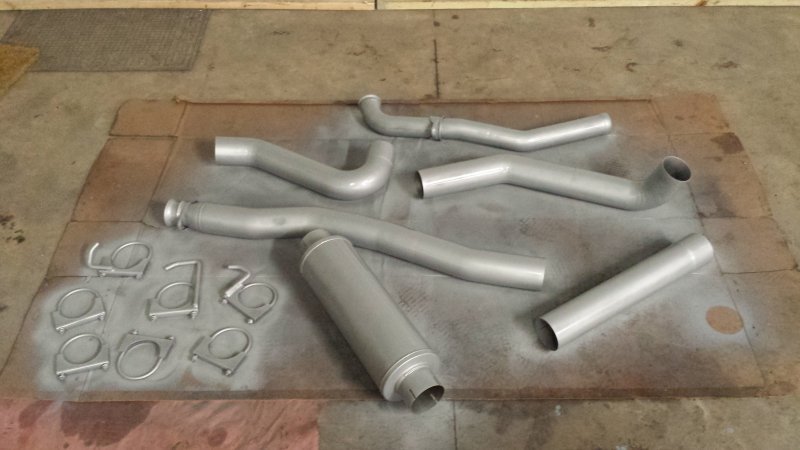

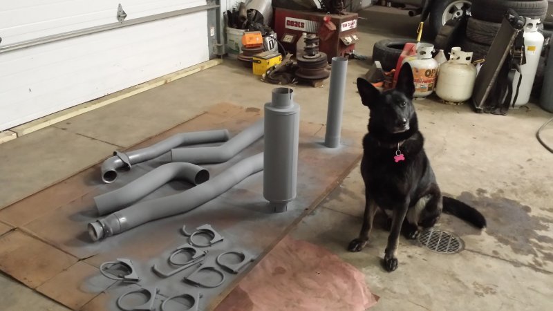

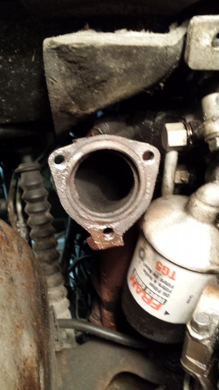

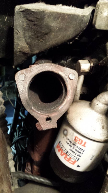

wasted some more time today breaking stuff. twisted two exhuast manifold crossover bolts off today....rushed it I guess. damn rusty trucks. soaked em with penetrating oil for 2 dyas, heated with torch, tried to be carefull, then twisted them right off. luckily the turbo side leaked enough oil over the years to keep the bolts from growing in as bad as the driver side. 3 hours, a torch, drill bits, easy out, PBR, and a tap. back to stock.
tried to get exhuast ready while i wait for brake and fuel lines... and go to my real job..
thanks for the help. I'm going to do more research on the fuel pumps and filter heaters. gotta get something ordered soon though..
