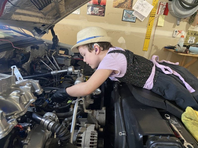

Yes to the "F" lower intake. As you can see from the picture of my helper, the intakes aren't back in place yet. I worked with the 2nd rebuild for a couple of hours trying to Time the $%^&* thing and do a TDC Learn both with the Tech II and the 'key on, throttle down for 45 second' methods...no joy. Grey blue smoke from the tail is always present. In the past it was clouds. Now it is just a slight haze until RPMs are brought up. It used to go away when the engine warmed up but now it doesn't go away for love and obviously money. Heaven forbid the wind is from the north and blow into the garage when it's running.

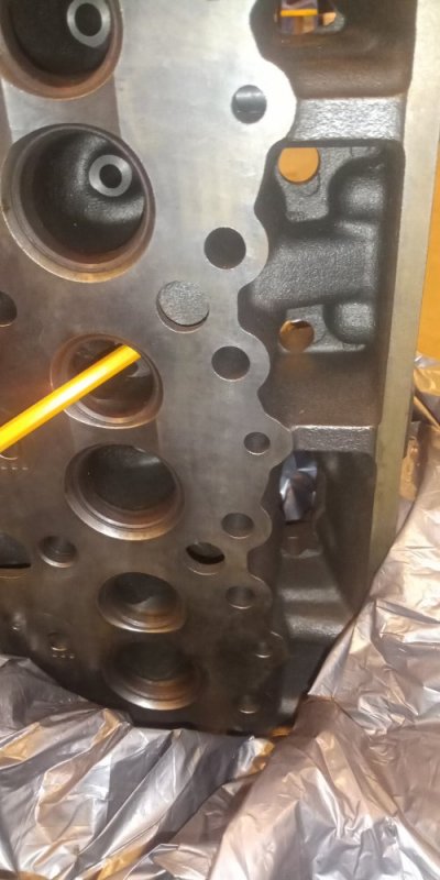

So my understanding of the EGR system is that exhaust gases come from both sides and the volume is controlled by the EGR valve itself. Shou have exhaust gases coming from both sides
Yeah, that's what I figured but, there's always something to learn with this thing. There's some exhaust pressure coming from the passenger side. just doesn't push up as it does on the driver's...nor smoke...pop...snap.... I really need to get a video up of this phenomena.
Thanks guys. I don't suspect a cracked head. Just wondering what's the exhaust path to the EGR...It's good to know information and a place to look. I'll start it up today with the lower intake still off and shut down #3 and see what the results are. Fingers crossed for an obvious and positive result. Earlier attempts at shutting down one cylinder at a time had #7 showing some improvement but, double checking never hurt. The #3 injector is easier to replace than #7 and I can switch it with #1 to see if the issues follow the injector.
