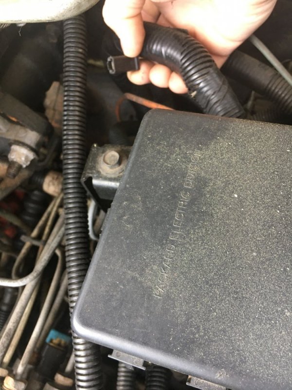

If this is the 98 burb in your signature then you should have this lift pump jumper behind the fuse box. Just run a wire to the positive side of the battery and stick it in the plug. Lift pump should come on.
If this is the 95 dually. I don’t know if obd1 has it. You could easily check and see if it’s there though.
I took to mounting a fused toggle switch there. I use a 5/16 eyelet and get power off of one of the studs onm the fuse box.
Very handy for priming the filter and doing diagnostics.
