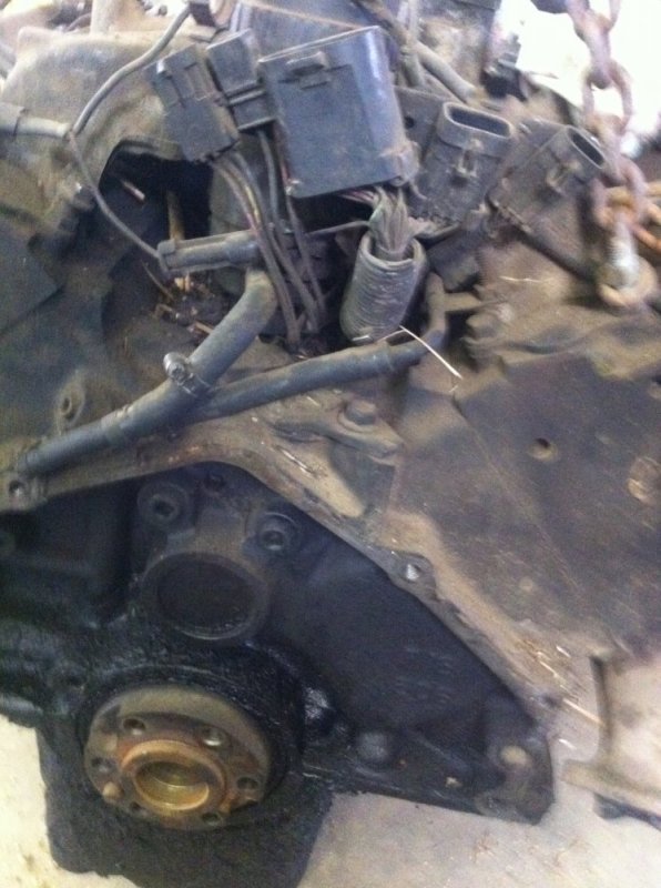

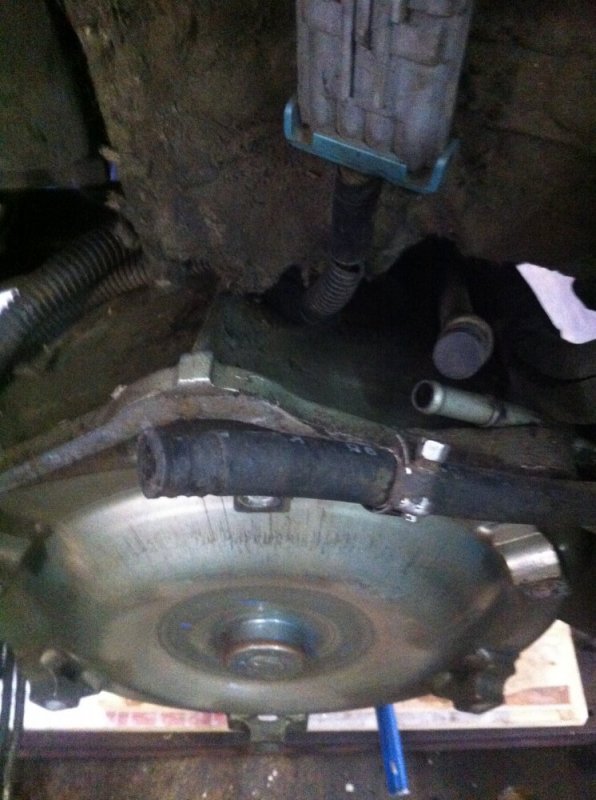

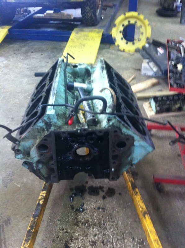

Here are the pics: The first is of the truck, middle is about how the line runs and the last is another engine. It seems the return line runs under the intake manifold.

It was the return line. I don't know how you guy's did it but I disco'd the hose on top and connected the new hose. I then clipped the old 2" from the metal hose at the bottom and used a barbed splice to join the new and old.
It wasn't the return line. It is leaking again. Here is what has been done. New o rings on FFM, new return hose, new FFM fill hose, New hose from FFM to IP, and new hose to t-valve. I also raised my FFM 7 inches so it is above the upper intake. The only thing I didn't replace is the small bent hose from the front of the IP to the return. I just ran it and it is not leaking from the front return line or any of the hoses that I have replaced. The fuel is dripping down the bell housing slightly off center on the passenger side. Where is it coming from? All the injector hoses are dry and the lines connecting to the injectors are dry. The only thing I'm thinking is the IP is leaking possibly at one of the 8 lines. There are a couple other things I noticed. On cold start up it stutters slightly for a second or 2 but then is fine. The other is when I park facing up hill it takes 2 -3 cranking cycles at 15-20 seconds each before it starts.

Since you raised your ffm up you should be able to get a flash light and look in the engine valley. If you see fuel in the engine valley then you can start looking around the ip. If nothing in the valley then probably the supply hose or return hose leaking on top of the bell housing.
If anything gets in the valley it will run down the bell housing
