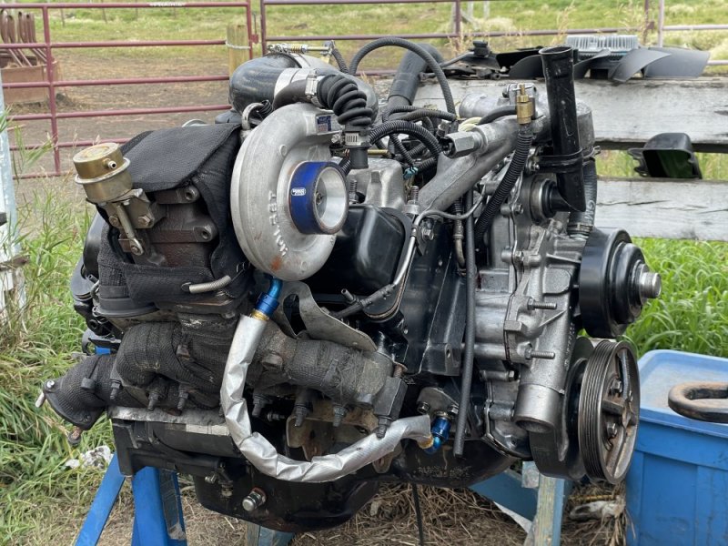

Got the cooling system together and started it today. Used a drill to prelube the oil, shunted the lift pump to run and purged air from the FFM.
I then turned the engine over with the glow plugs out and loosened any injection lines loose that I could reach (1,3,5,7).
Once that was done I crushed up a few cooling system sealant tablets and filled it up with dexcool.
It fired up surprisingly fast. The gapless rings, 0000 gauge battery cables, powermaster starter, and two 4D batteries really made it start easy.
I only ran it for about two minutes, enough to purge air from the cooling system and listen for odd sounds.
I will hopefully have time next weekend to TDCO learn, time set, put the bumper and grille on and start breaking the engine in.
My plan is to haul a wagon full of hay bails down gravel roads for about 4 hours. From what I read diesels need to work to break in properly.

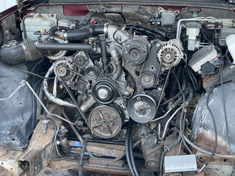

@Jaryd @MrMarty51 no sorry.
I had it made a few years ago by the person who posted a DIY here. It was two pieces of sheet metal jigsawed and arc welded together with m10 & m12 holes drilled. I tapped another m12 hole for the vacuum pump delete and got a larger pulley so I could use the same belt length as the stock ambulance package.
I could flatbed scan my piece to scale on PDF, you could print them to letter paper at 100% scale on your printer and make one yourself from that.
if you don’t mind scanning it that would be great. I can get our metal shop to cut it out for me. My email is [email protected]

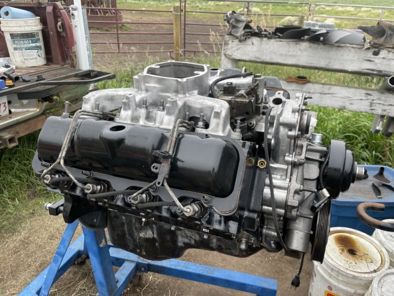

Looks like my crankshaft pulley is out of alignment. Too far in. Is it possible to over insert a harmonic balancer?
Not sure if there’s supposed to be a gap from the crank snout to the balancer but with a torque of 200 ft-lbs it would be hard to leave one.
Or is there some kind of shim? Not sure what to do as the same parts in are front of the crank about as before the rebuild.50B49C85-5E37-4236-B7F9-FF035E9CDBA1.jpeg
