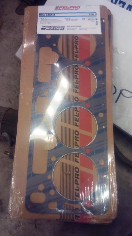

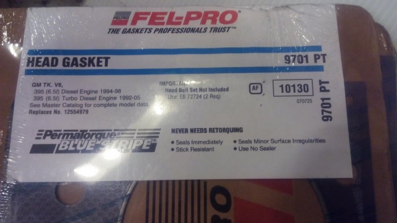

I'm not sure why I asked what brand the head gaskets were. That makes it seem like I'm not appreciative of all the help I'm getting, which is definitely not the case. My apologies. My biggest concern is shipping damage. Can something like fragile and easily damaged by bending like head gaskets be safely shipped? If there is a way to safely ship them, I'd be willing to accept them. If you have a way to ship them go ahead and PM me and I will send you my address.
Don
I have a set of Fel-Pro head gaskets if you want. no guarantees on damage unfortunately, but USPS hasn't been too bad. I have other gaskets as well.

Thanks, but I think AK is sending a set of Fel-Pro head gaskets.

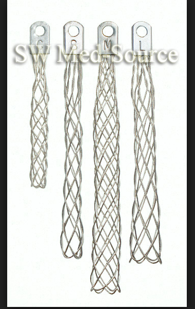

Here is a surgical metal type that is nearly identical to the older ones.
However, I thought just about every rope type seal had been converted to an equivalent 2 piece roll in molded seal that most parts stores could look up and it will work as well (or better)
Surgical? Those look like electrician's wire pulls to me..
The last pic is similar to what I used to use/ sell.
