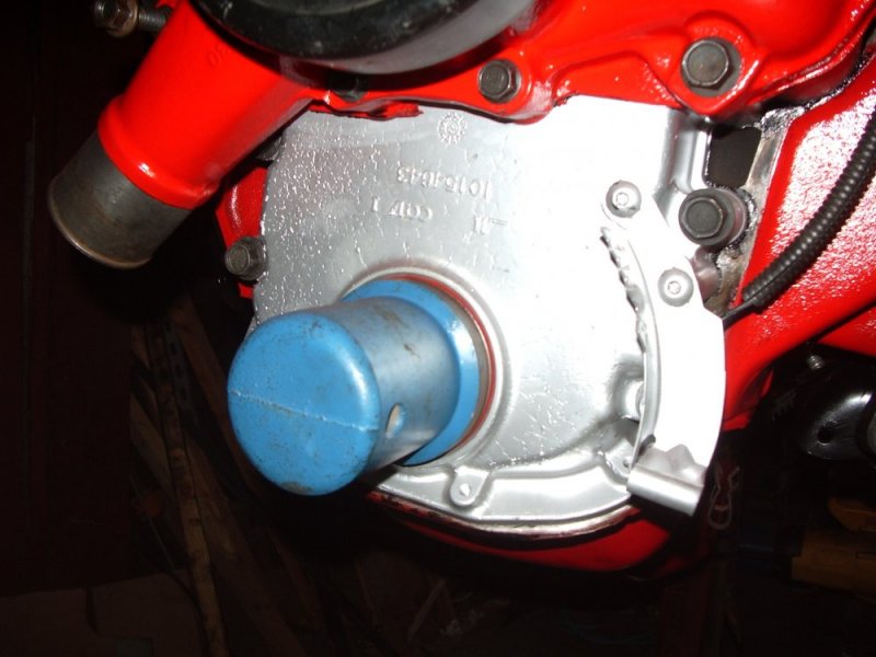

Seal driver, over the crank snout after just driving the seal into place.

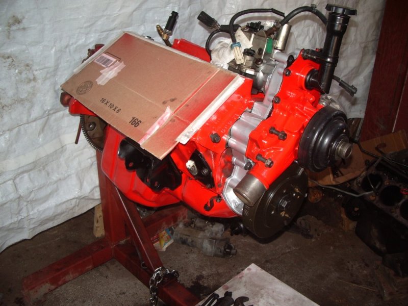

The block, as it currently sets, with harmonic balancer in place.

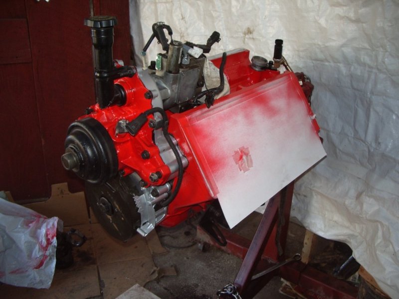

Other side of block.

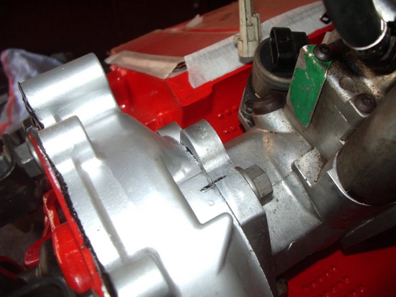

Injection pump. The set lines were difficult to see so I used a sharpie and put a black line beside the set line. I never loosened and removed the IP from the front housing, so theoretically the timing will be the same as it was prior to the tear down.

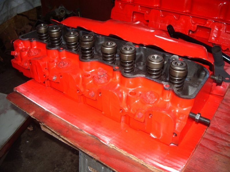

Heads, waiting to be put back on.

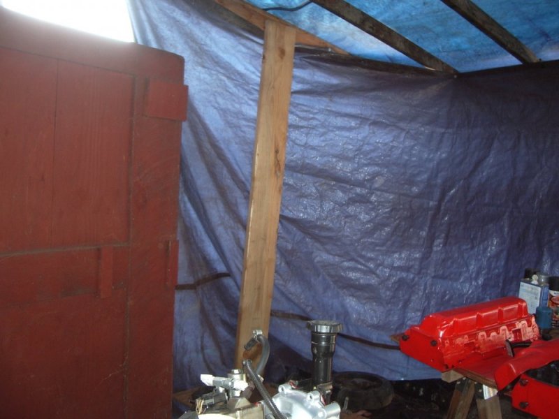

The blue room. My "workshop". I initially put up the "roof" for sun protection while working, then due to impending rain I added the southwest side curtain.
