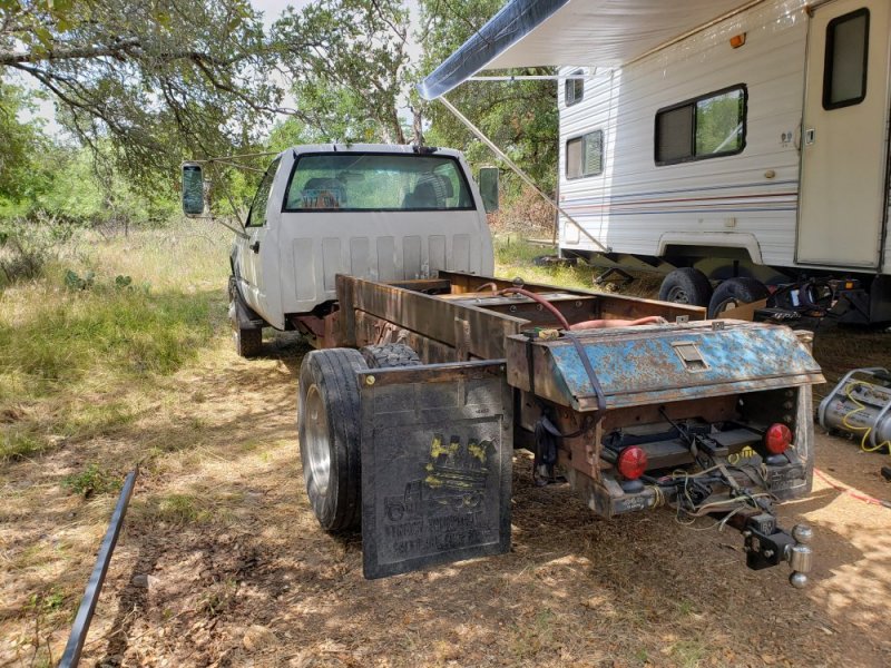

Quickly made up some angle iron mud flat mounts. They sit further back than I would like (just behind the rear shackle hangers) but didn't require any trimming of the mud flaps to place them there. Eventually want them closer to the tire so they serve as the bottom/rear of the fenderwells and give better access to the hitch for easy hookup. A rear bumper is the next thing the bed needs to keep the law happy. Plan is to use essentially a piece of plate across the rear the same width as the box, down to the hitch. Use the commercial oval lights (6" or 7" whichever they are) mounted vertically alongside the outside edge of the frame rails. Brake/marker lights up top just under the box, reverse lights under them.
As for weight, with the old bed it sat on the overloads when empty vs now it has over an inch of clearance, and the truck drives noticeably quicker on acceleration haha.
