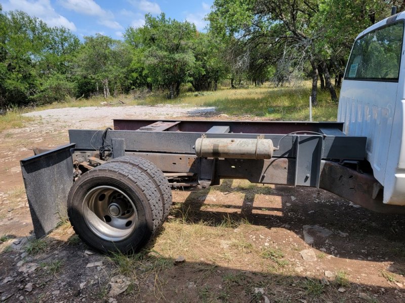

I was wondering off the ground, Can’t tell from angle of pic. Ive seen many underbody boxes mounted there a hair too low and get smacked. I helped a guy mount one there but he used an old spindle so if it made contact with the he tire would just spin and deflect the blow.
And, uhhh, 37x12.5- are you stealing my tires? Haha
The bottom of the fuel tank mounts are still higher than the bottom of the frame reinforcement plates, good there. Spare tire will hang down a similar amount, still above the bottom of the frame. Do like the idea of using a spare hub as the tire mount.

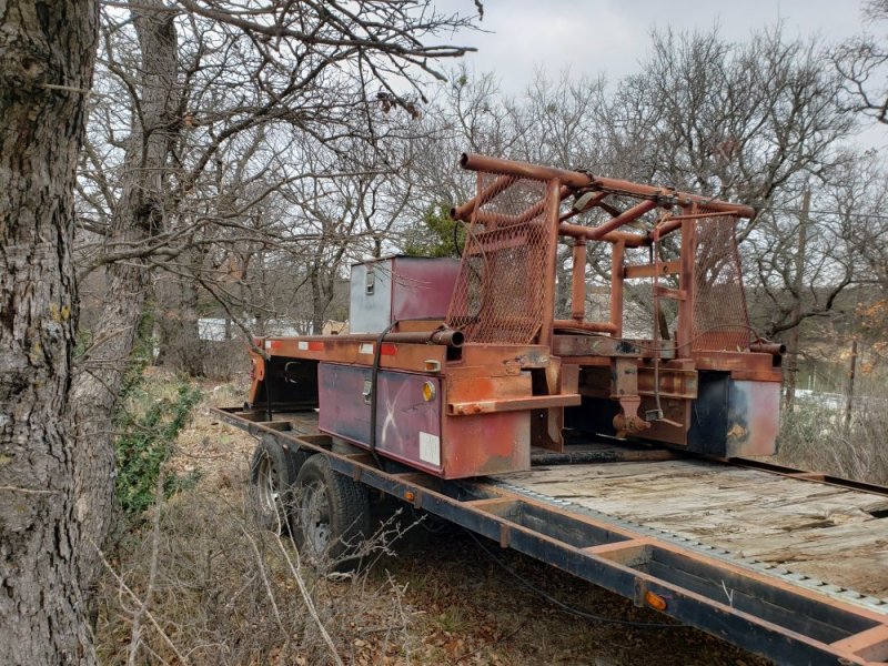

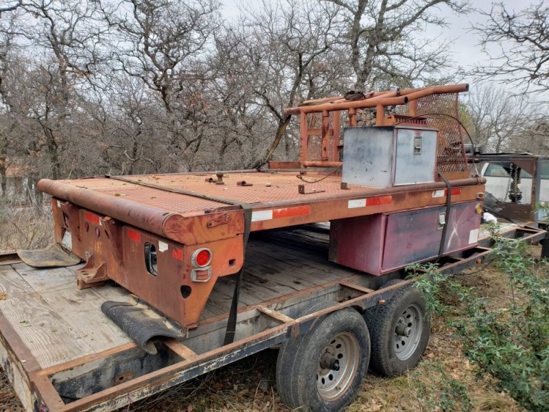

Did some checking with the physical size of the things that will be carried on the bed (jumper cables, some tools, lifting equipment, etc) and, well, the minimalist bed essentially becomes a flatbed from cargo boxes. Damnit haha. With that realization confirmed I started looking at the local stuff for sale and found a gin pole bed in good condition that is sized for this truck in good shape. Priced well enough that I might just go back to that plan instead of finishing the build.

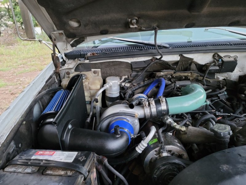

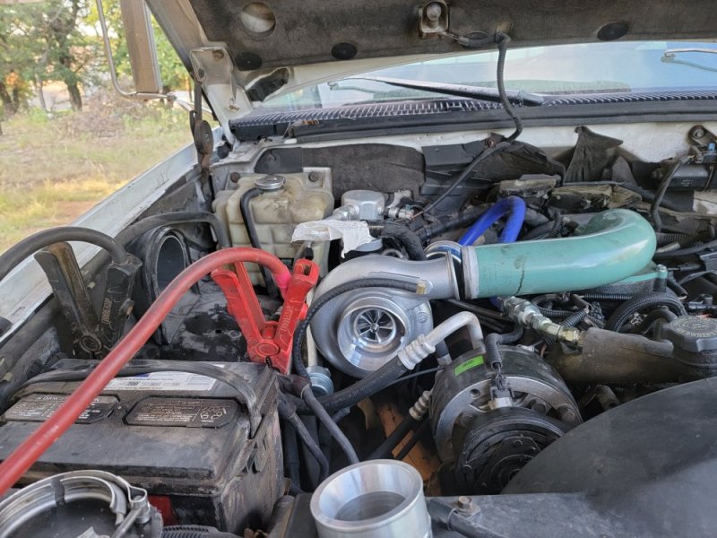

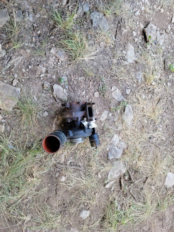

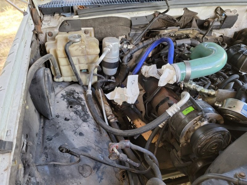

Now 100% sure I've killed the stock gm4 turbo haha. Significantly down on power when towing, feels just slightly more powerful than the 82 6.2 diesel was. Turbo whistle isn't audible anymore either. Add to it, that's even with the wastegate wired shut. So decided to bite the bullet and order a super54 turbo rather than mess around with cheaper turbos building the right hybrid. 54 makes sense being a stick shift and the lower rpm range I use.

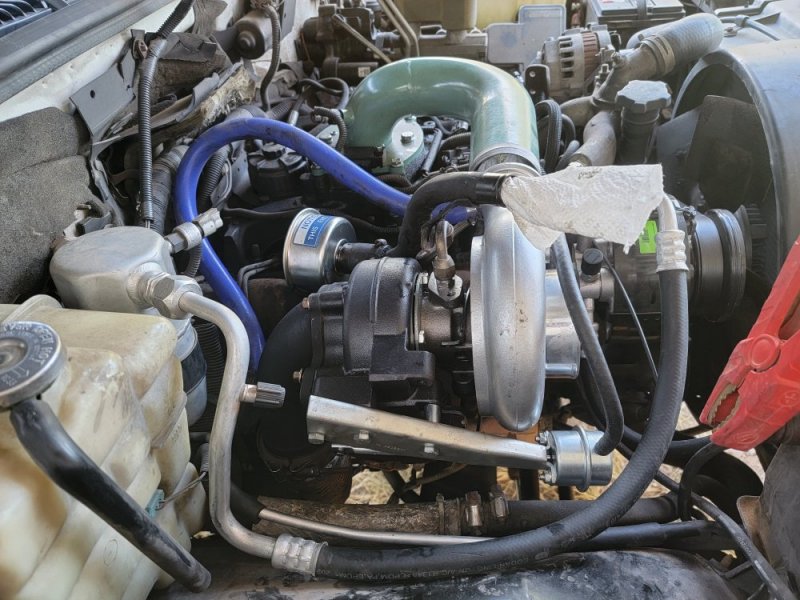

Sold the 1 ton and using some of the money to focus on the HD. Original turbo was worn out, even with the wastegate wired shut it wasn't able to make boost anymore so went ahead and upgraded to a performance turbo. Super 54, from Quadstar tuning. Seems to match up perfectly for the low-mid range rpm that I drive the truck at. Higher boost at the rpm's needed, lower EGT's, lower turbo drive pressure and not terribly expensive either.

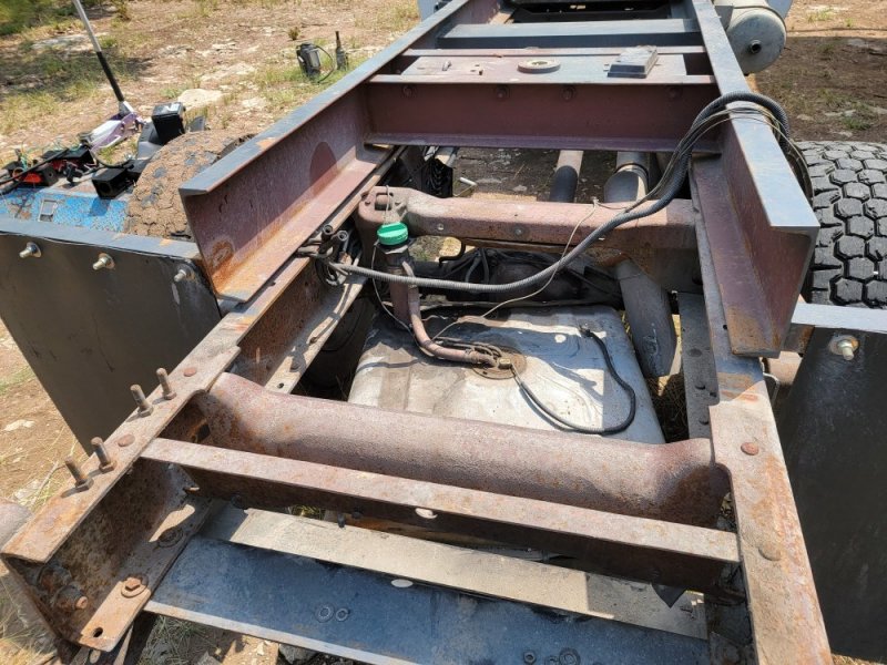

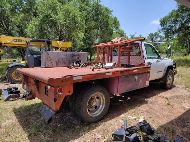

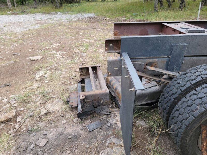

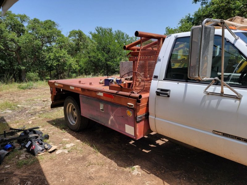

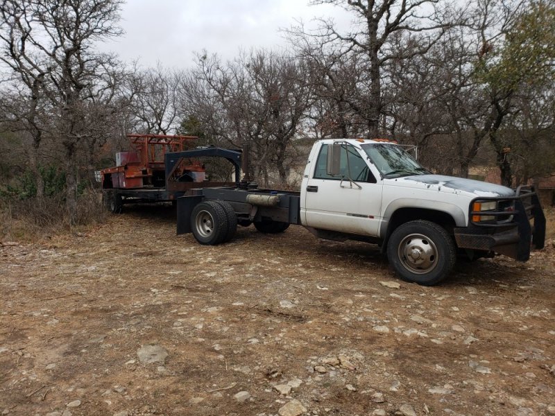

Now for the gin pole bed. Stripped the stuff off the tail end of the frame, planning to do the cutting either today or tomorrow, then place the bed on the truck when the lifting equipment rental gets here later this week. Being that the stock fuel tank has a hole in the bottom of it (patched with JB Weld last year) decided to go ahead and go with the shorter option.
That looks sharp! Attached, or just sitting there awaiting final alignment/fastening?
Sitting, got a welder coming Friday since my stuff can't handle that thick of metal. Going to have him do the mounts and maybe go ahead with the hitch change. Cut out the current gooseneck and mount the B&W recessed into the bed deep, so the air ride hitch can be used. The top of the ball would be just below the bed deck.
