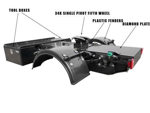

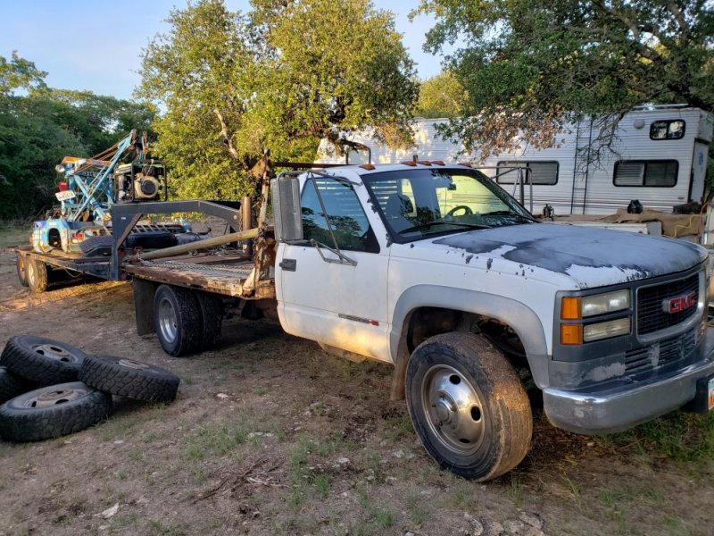

Bit of the idea/needs for the truck bed being built. My list is that the truck can lift 2,000 lbs safely with the poles at least 5ft off the ground. Tow gooseneck and 5th wheel trailers with no clearance issues in the typical 180 degree ark. Rolling tailboard so the cargo skid or similar can be loaded if needed is nice but might leave that to the trailer. Extended fuel range. Some storage space for roadside tools and equipment for the winch. Lastly enough space for the kayak or the cargo skid to fit.
With that in mind, I don't believe I have a need for the typical full width flatbed. A variation of the minimalist/hotshot bed should work great and save a lot of weight and cost in steel. So the typical minimalist bed is in the pic.

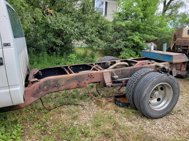

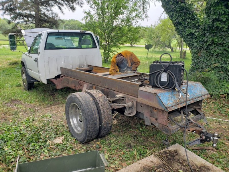

What I'm thinking. 6" C channel for the bed main framerails to match the 11ft 4in of truck chassis. The Holmes 500 wrecker mast mounted at the front of the bed, shortened in height to match the cab. Use the gin poles as the new wrecker booms (stronger, extendable, easier to lay down flat when not needed). Move the auxiliary fuel tank as a saddle tank along the driver side, this puts the bottom of the tank just about even with the bottom of the cab and flat with the top of the bed floor.
Notch the 6" C channel down 1.5" (roughly) to recess the hitch rails, so when the hitch is removed a flat plate can be set in it's place, leaving a flat deck from after the wrecker mast to the end of the frame. Extra crossmembers here to reinforce the hitch. Brings the hitch height down to nearly match its current height which is good for the toy hauler.
Use the diamond plate wheel wells from the wrecker bed. With the 6" frame it will allow the top of the wheel wells to be flat with the rest of the deck, which gives a place for the wrecker booms to rest flat when not needed, instead of having to be removed when towing.
The Holmes 500 wrecker assembly is listed at 1500 lbs, add another 400 lbs for the 60 gallon aluminum tank with fuel, and estimate 600 lbs for the rest of the bed assembly would put the weight pretty similar to where it is now. The things I carry on the bed right now for cargo are usually the kayak, some 5 gallon fuel/water cans, some groceries/small stuff. Nothing that wouldn't fit on the 34" wide deck between the wrecker booms when lowered down (mast is a total of 50" wide).

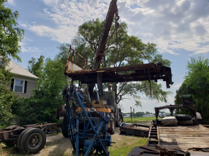

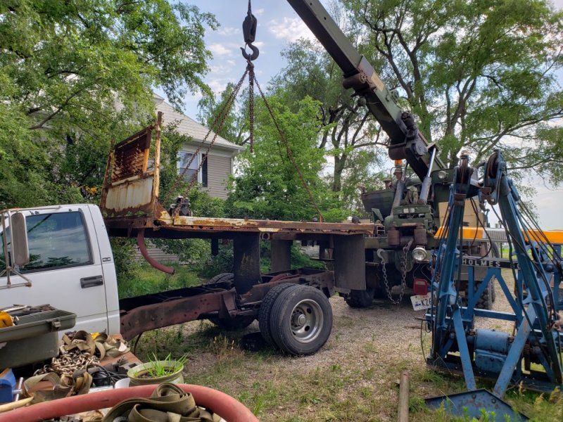

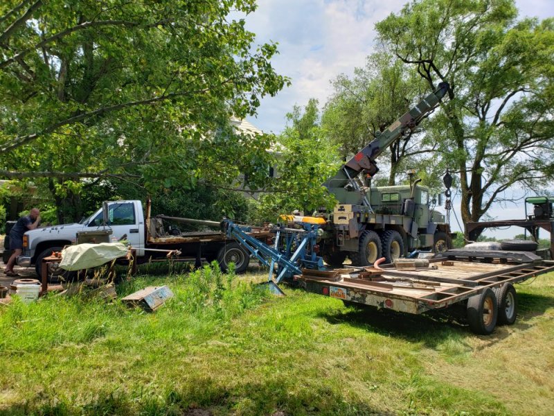

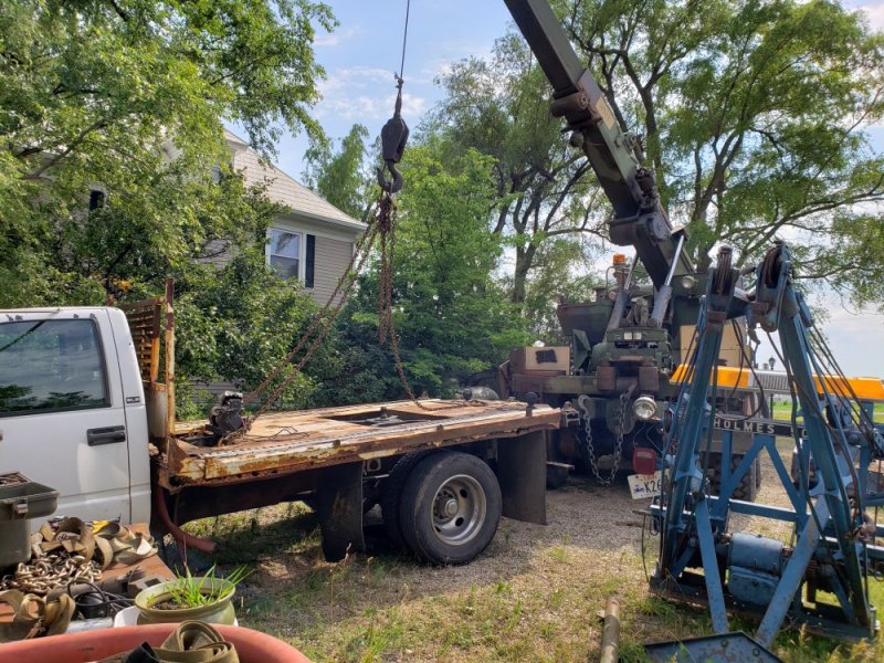

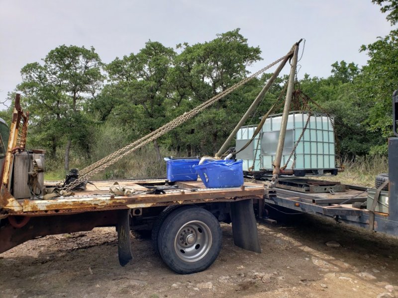

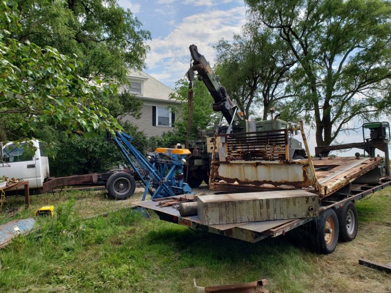

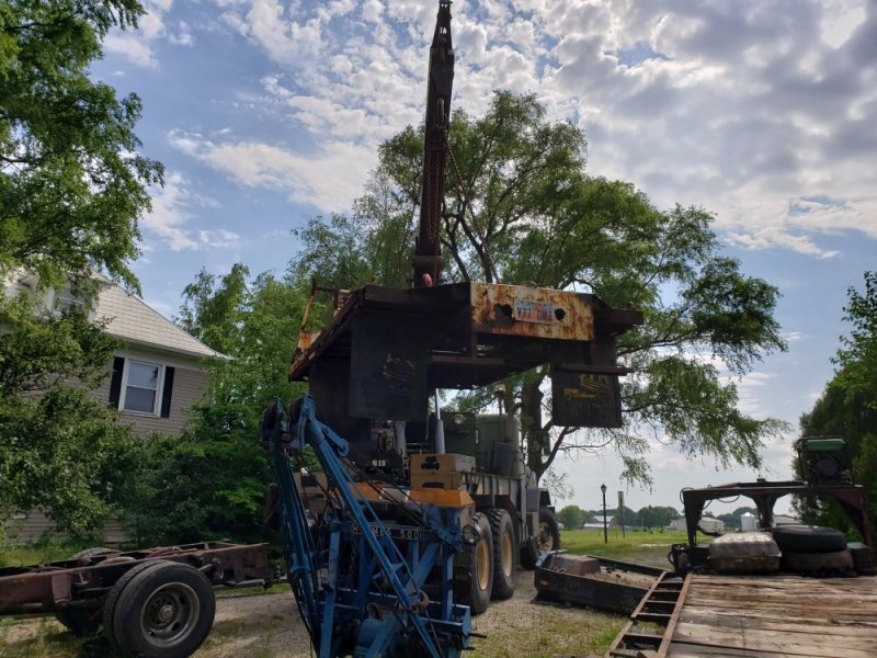

Almost done with this gin pole setup, just a few more things to lift. The water containers are about 2450 lbs each and as can be seen, the bed flexes a bit haha. In it's defense though, the front most mount for the bed is at the front of the hitch rails. Tomorrow loading the wrecker bed, wrecker mast, and the D70HD axle from the crew cab onto the trailer which should be the last few things it has to pick up.
Oddly enough I think the wrecker bed is lighter than expected, the gin poles handled it easier (bed and mast together) than a single water tank. Once the axle was loaded up lowered the poles for hopefully the last time on this bed.

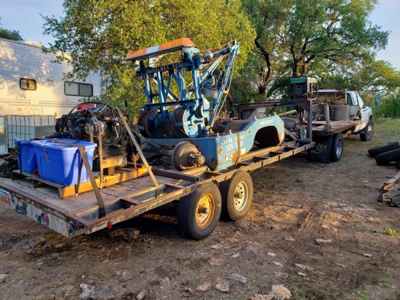

Then hooked up the trailer, plan is to leave tomorrow. Drop off the pallet with the engine/parts in Dallas, stop for the night in Oklahoma. Then meet up with a guy in Kansas to drop off the axle, lastly head to my friends place where the new bed will be built, front bumper mounted, and some other welding work.

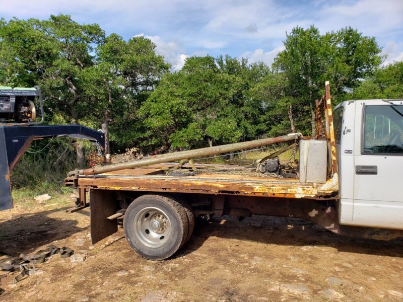

Sure looks like you got your money's worth out of that flat bed and gin pole rig!
Got the bed for free, poles were about $20 if I remember right (crane support legs from the m816). Little 4500 lb mile marker winch and the pivots are towbar feet from the 5 ton wrecker as well. Absolutely got my money's worth out of it haha. After seeing the bed flex I figured it would have catastrophically failed at some point with the lifts but it held up long enough.
Total weight on this trip, I'd guess 14-16,000 lbs combined. According to the scrap yard scale the trailer weighs 2700 lbs (truck and trailer had the scale at 10,700).
