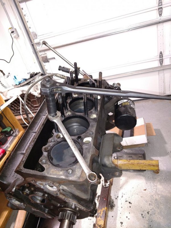

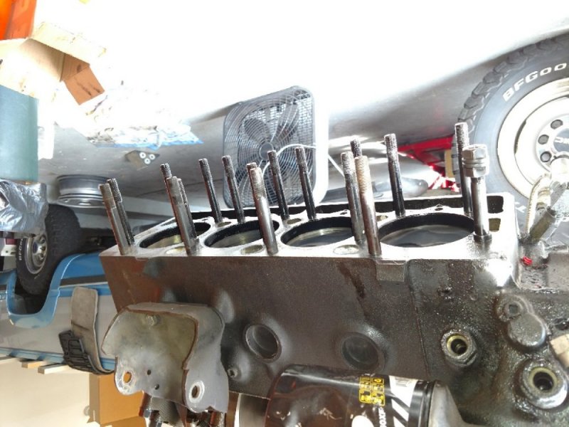

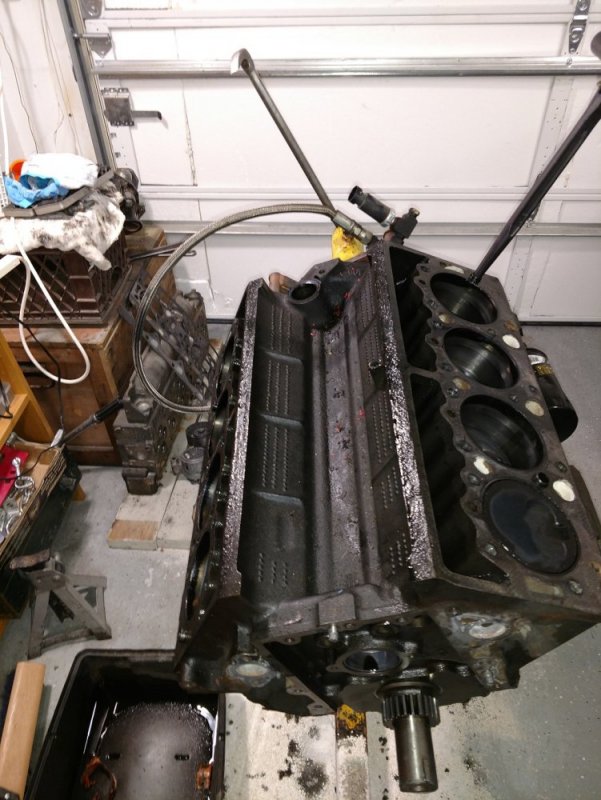

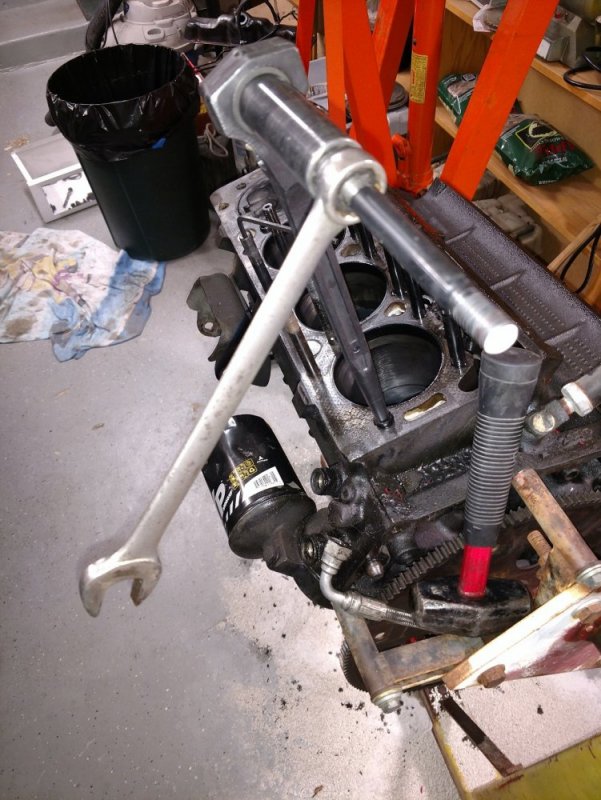

Couple of studs were very stiff to remove and a couple were near loose on this side. One has to add some twist to the bottom nut to keep them from just coming loose.
Then have to separate the locked up nuts. Why yes, there are 6.5 parts labeled and resting on a shelf somewhere.
Done.

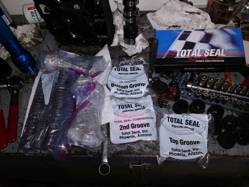

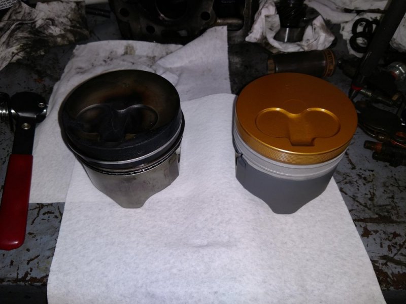

New parts starting to arrive. Yes, the good stuff comes in baggies...
Happy to see a 1 piece oil control ring rather than a split rail PIA to install the last Total Set had.
Can You snap and post a pic of that oil ring, just for clarification, I never ever did see a one piece unit before. LOL

It was mentioned elsewhere that the camshaft looked like it got hot as the photos show more blue than in person. Given the "well done" cooked pistons I may have been overheating the engine oil. Really hot engine oil and hoses out here don't mix as the fing hoses fail. Even the aftermarket oil cooler on the Duramax ruined hoses. So for less hoses to fail I will deal with nasty oil changes. (I don't have an oil sample since I pinned the timing advance so this may have just happened.)

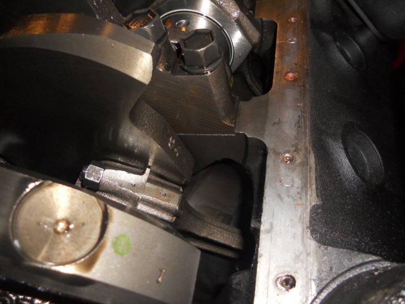

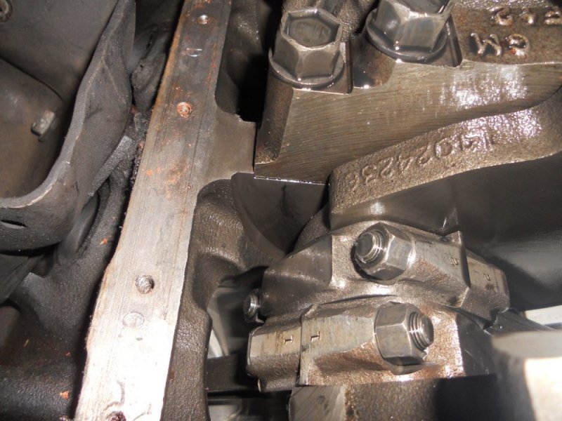

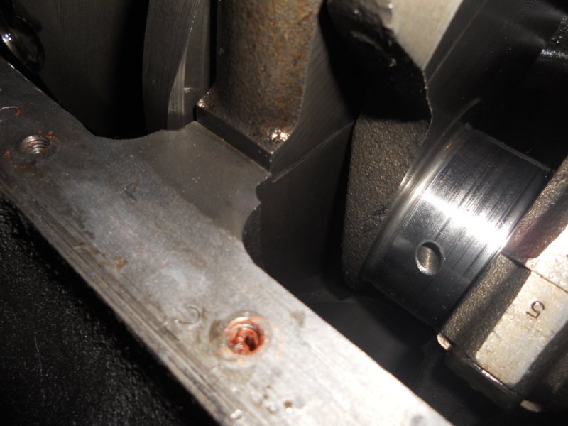

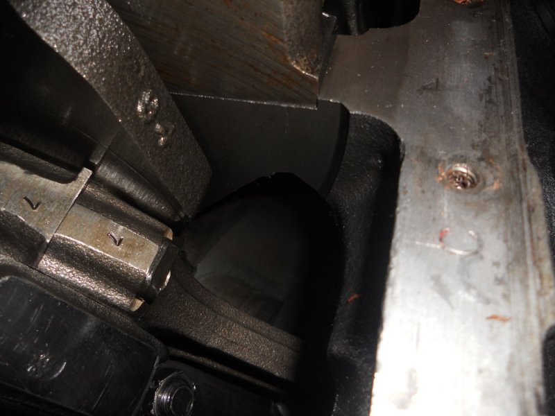

Main cracks #2 oil and #4 both sides shown as #3 was not playing nice with the camera:
