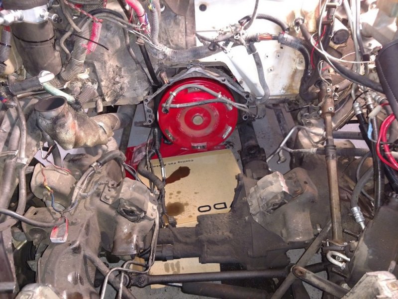

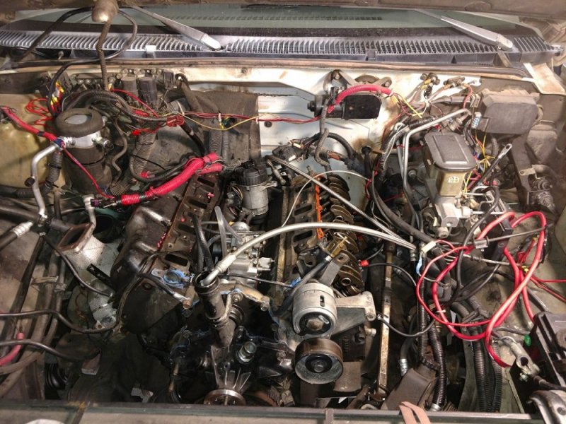

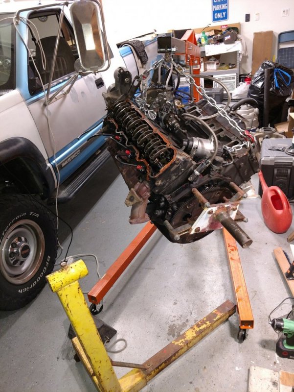

So got my buddy over to help after working on it for a couple days to get ready to pull. The Yank Converter "hub" stuck in the crankshaft and pulled completely out of the transmission like I left a bolt in. As the bolt holes didn't line up anymore... Managed to get it shoved back in the trans before it fell out while pulling the engine. It will need a new front seal no doubt. This truck is extended cab longer than the yellow 1992 project so we took the engine over the driver side fender to avoid going down the steep slope driveway.

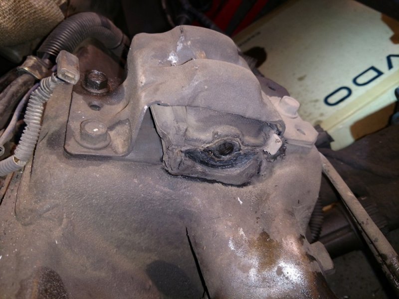

Biodiesel from a leaking injector, return, etc, turned the engine mount into door seal soft rubber...
UH-HO. It's not looking good. :vomit:

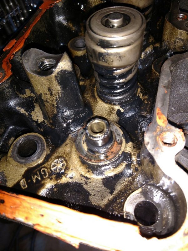

Pulling the passenger head found the exhaust valve tip on the lowest compression cylinder hammered. Valve stem seals were so hard they held the valve springs on alone.

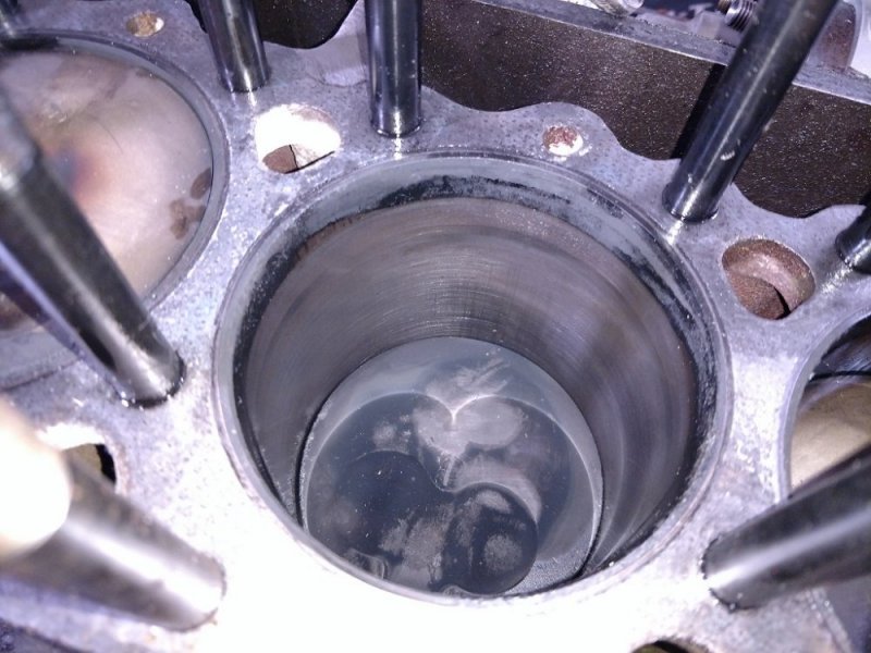

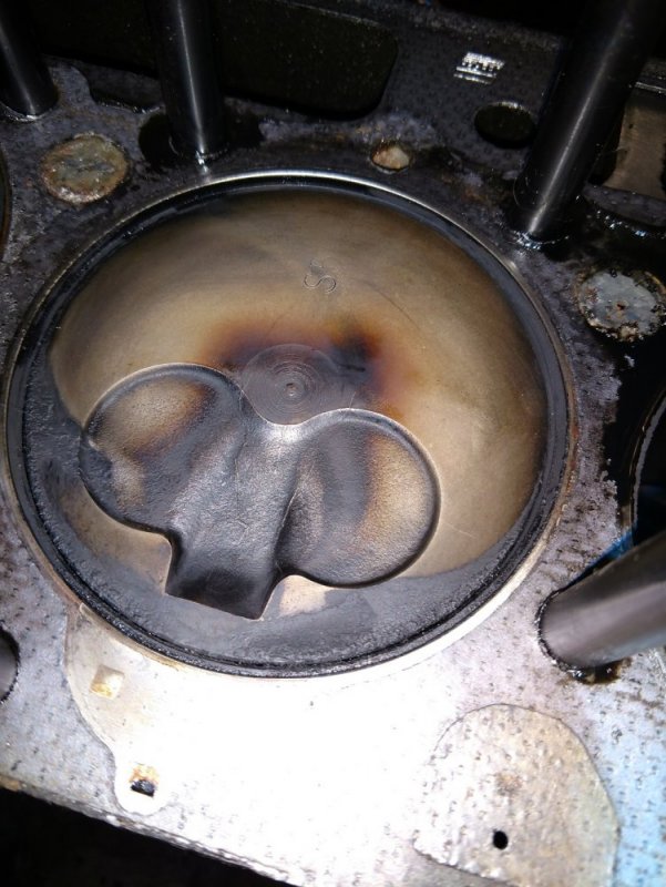

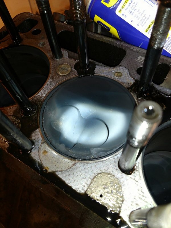

All 4 pistons cracked like this. WTF. :wtf: #6 shown.

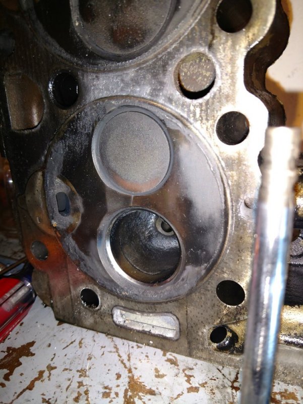

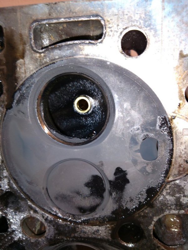

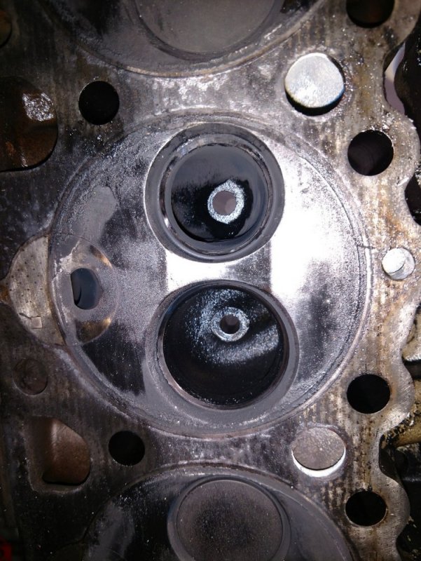

No pictures yet, but, the head is cracked across the valves for #8. Odd hard white crust on the head like a coolant leak, but, no sign of leaking from the head gasket. Crust was the lower left corner a ways away from the coolant passage. Scuffing in the #8 cylinder there. Also some white on the intake valve for the low compression cylinder. The low compression cylinder has coolant pitting damage, still, from the day we got the engine. Can see the hatch marks still from the deglaze except where the cylinders are scuffed. Don't have the driver side head off yet.

The valves are shot for sure. Mainly from just wear. These heads came off a worn out 6.5 and went on this engine with zero attention.

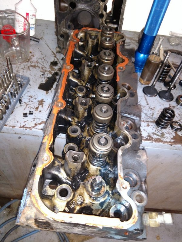

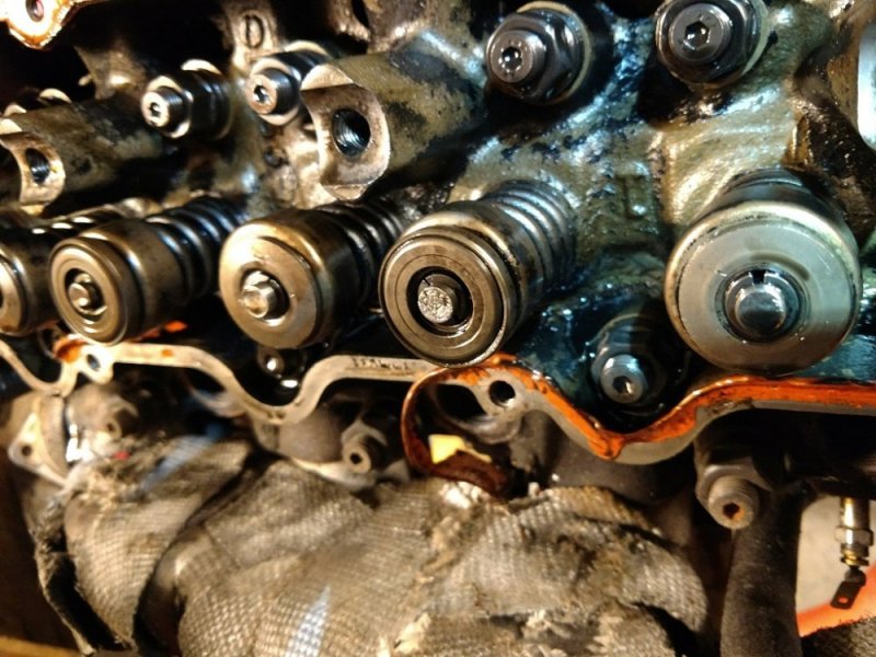

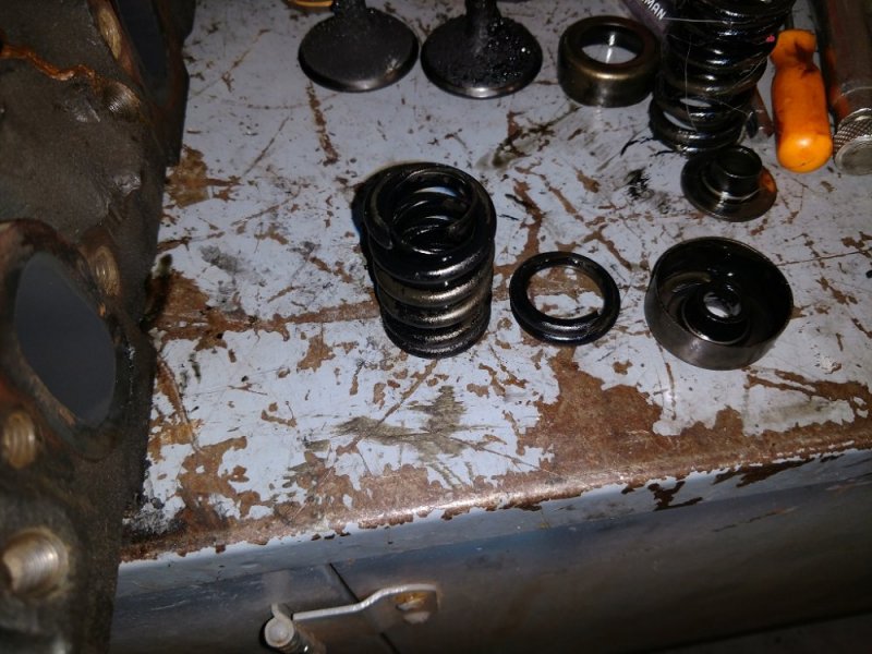

@smokymtn65 wins a prize for a good guess in the Moose Call thread. I could hear a knock on the driver's side and now I know why. Under the cap out of sight... I need to go break the rest of the intake valve springs to bring the compression up to the minimums, yeah, #1 with broken spring had the highest compression! :wtf:
Sounded like mine when it broke a valve spring

I never liked the bronze insert sticking out this far so I was the first valve I pulled on the driver's side head, #1 intake.

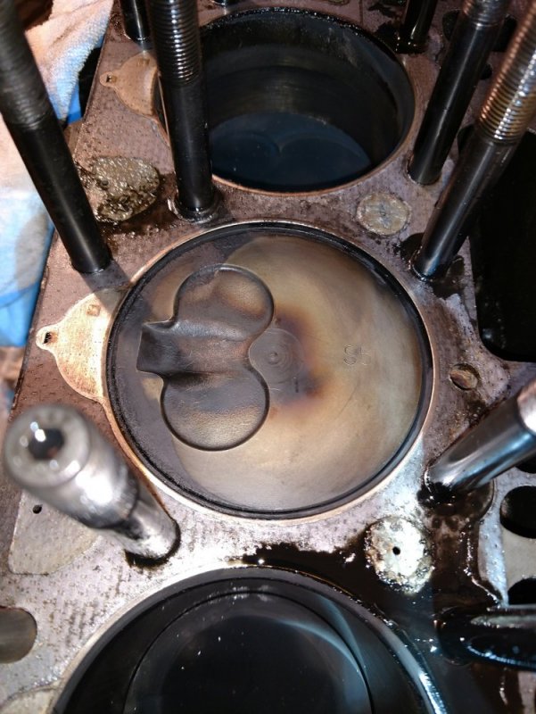

Lots of carbon on head gasket and you see where valve has been tapping piston.

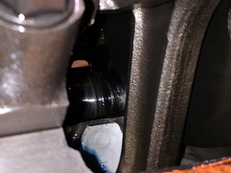

Camshaft lobe wiped: likely for the hammered exhaust valve. Some silver in the oil pan and now I know where it's from.
One of two heads cracked. #8 cracked. (I have another head and a set of 8 precups. So I got two heads that can be rebuilt.)
Oh yeah, Who the F paints their rebuilt heads gold? Paint is starting to flake in places. No you are not seeing things... It's painted on the inside oil contact areas of the heads.

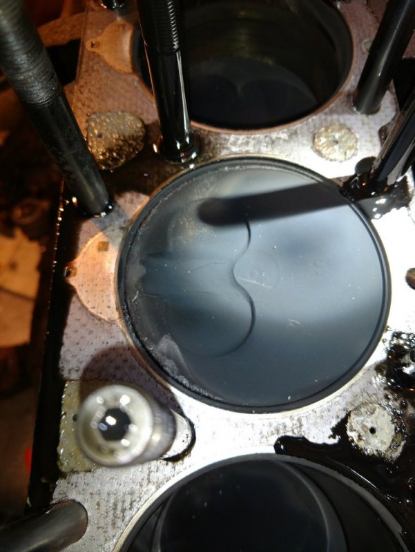

200 PSI hole...

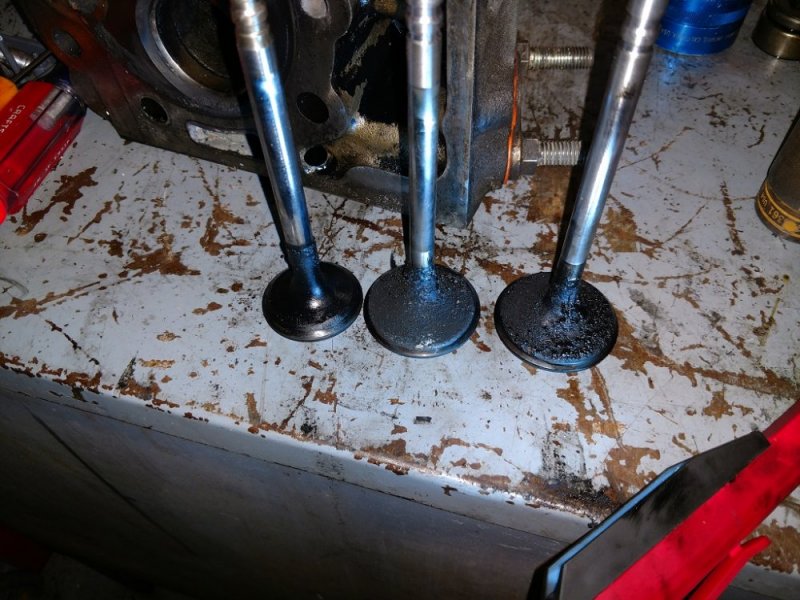

Valves:

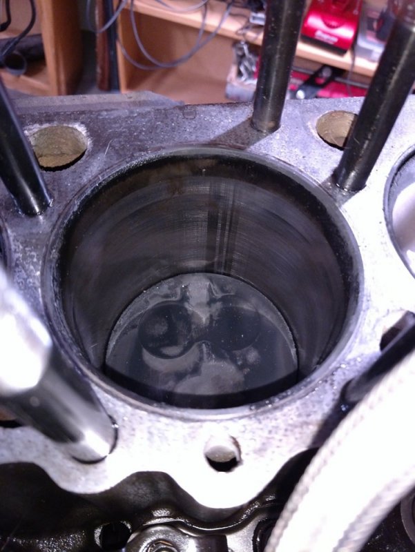

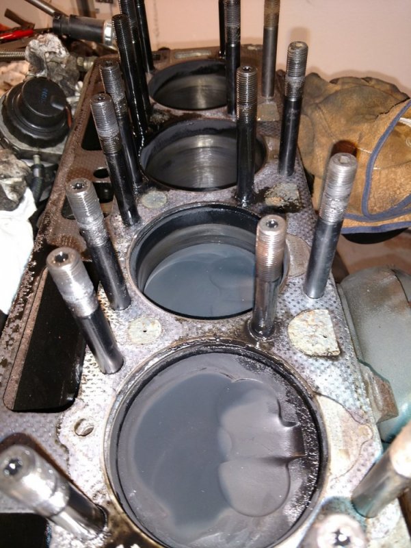

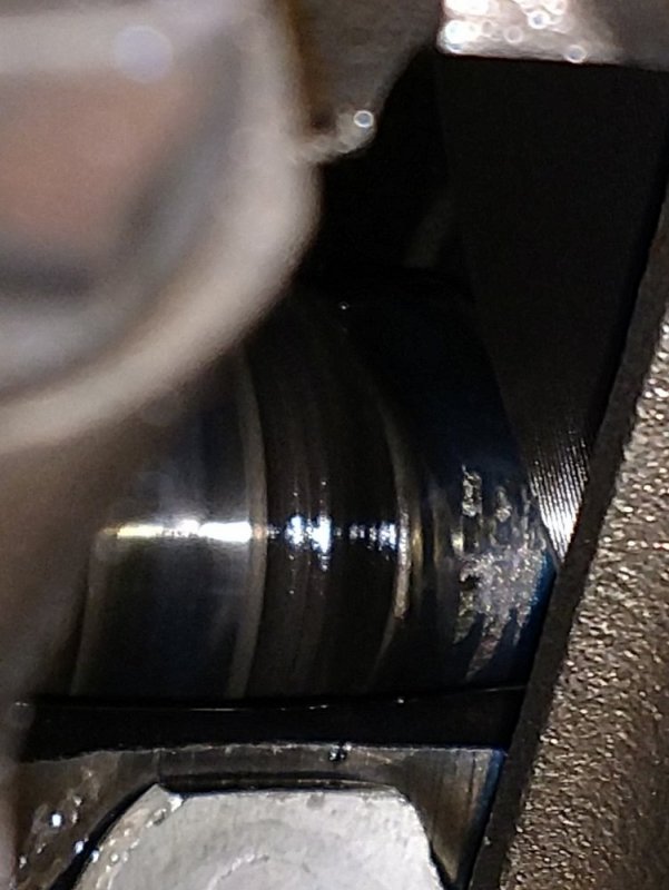

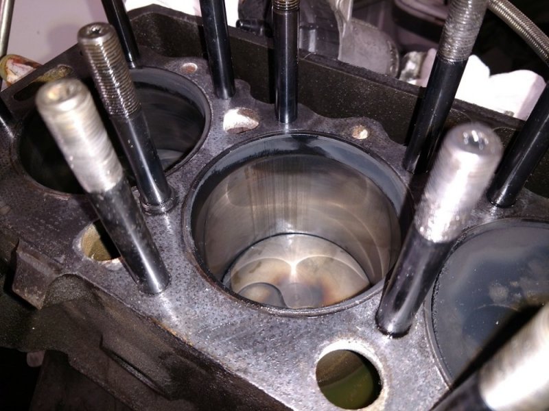

Nothing to worry about of the cylinder walls - can't feel them. The concern is the coolant damage, pitting, this engine has had since we got it surplus used military.
Coolant/water rust pitting on 200 PSI hole:
Check how easily the rings do or dont rotate around the piston as they come out. Also ring gap in the cylinders.
On the vertical marked ones take a closer look at the rings in that location if not able to spin much on the piston, and maily look at piston skirts as the culprit for those vertical marks.

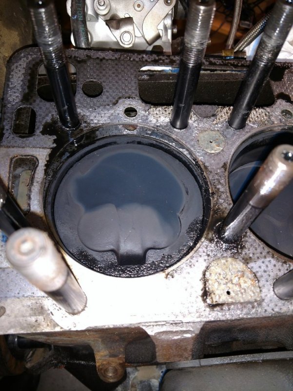

The life of valve springs is a hard to set item. I bet if you were to test them, 40% or more would pass. Yet obviously they are done and then some, with valve kissing piston probably adding to the death here. I don’t see enough built up carbon on piston tops to have made up the clearance diffence, and we see valve smack marks. More than just the broken spring hit? you can bet they weren’t staying sealed at the high rpm. A little chatter goes a long ways.
Pretty easy to see the marks of the flame on top of those pistons. Almost like watching those videos in slow mo and can picture that shock wave right as it hits the piston.
